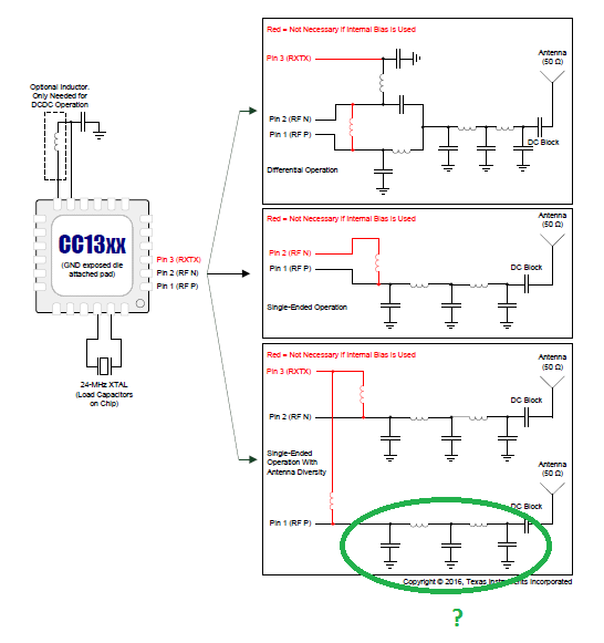

I am having a little trouble finding information and/or reference designs based on single-ended operation.
I am looking to create a solution that uses 2 FEMs operating in 434MHz and 900MHz. It appears that a single-ended approach might be a simpler solution than switching the differential signals and having separate baluns and matching networks for each RF path.
I have some questions from the datasheet SWRS181C on page39 (of course with my annotations):
  1. When the CC1310 is operating in single-ended mode are the RF inputs/outputs internally match to 50 0hms?
  2. What is the purpose of this LC network in seen in the datasheet, matching, filtering? Is there information on calculating these values for single-ended operation?
  3. Can you briefly explain (in laymans terms) the purpose of the RXTX pin, it provides a bias to the circuit but how does that improve the receiver sensitivity 1dB as stated in the datasheet?
Any other comment would be welcome.
Gary
  • Hi Gary,
    For a single-ended ref design, the CC1350 SensorTag is available. This operates at 868/915 MHz and 2.4 GHz.
    1. The RF_P and RF_N ports are not 50 ohms but the external passives provide a 50 interface and low-pass filtering.
    2. This is a low-pass filter network. This is mainly to limit the harmonics below the regulation level set by ETSI/FCC.
    3. RxTx is a port that provides external biasing to the internal LNA. Biasing can be configured as external or internal. For optimum performance, external biasing should be used.
    Richard
  • Hi Richard,
    Thanks for the reply and information, I have looked at the CC1350 reference but I am still not able to determine the values necessary for the external passives at 434 MHz.
    I have also looked at the CC-Antenna-DK2 documents, but again I am at a loss on how to calculating the values of the external passives based on the CC1350 reference design.
    I will plan on using the external biasing; but have the following questions:
    1. Is there an optimal impedance for the RF_P and RF_N ports that your using to create your matching network?
    2. Could you provide initial values for the external passives to operate at 434 MHz?

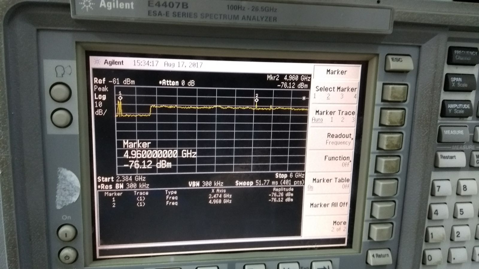

    See bellow the results for the 2.4Ghz.
    from technical reasons, we connected the probe before the printed antenna (after Ant2 and Ant3), so maybe it is not the most accurate.
    We can see the second harmonic is pretty high, is this an expected behaviour for this design (CC1350_STK)?
    can this help us understand the high 3rd harmony in the 433Mhz?
    YTE.

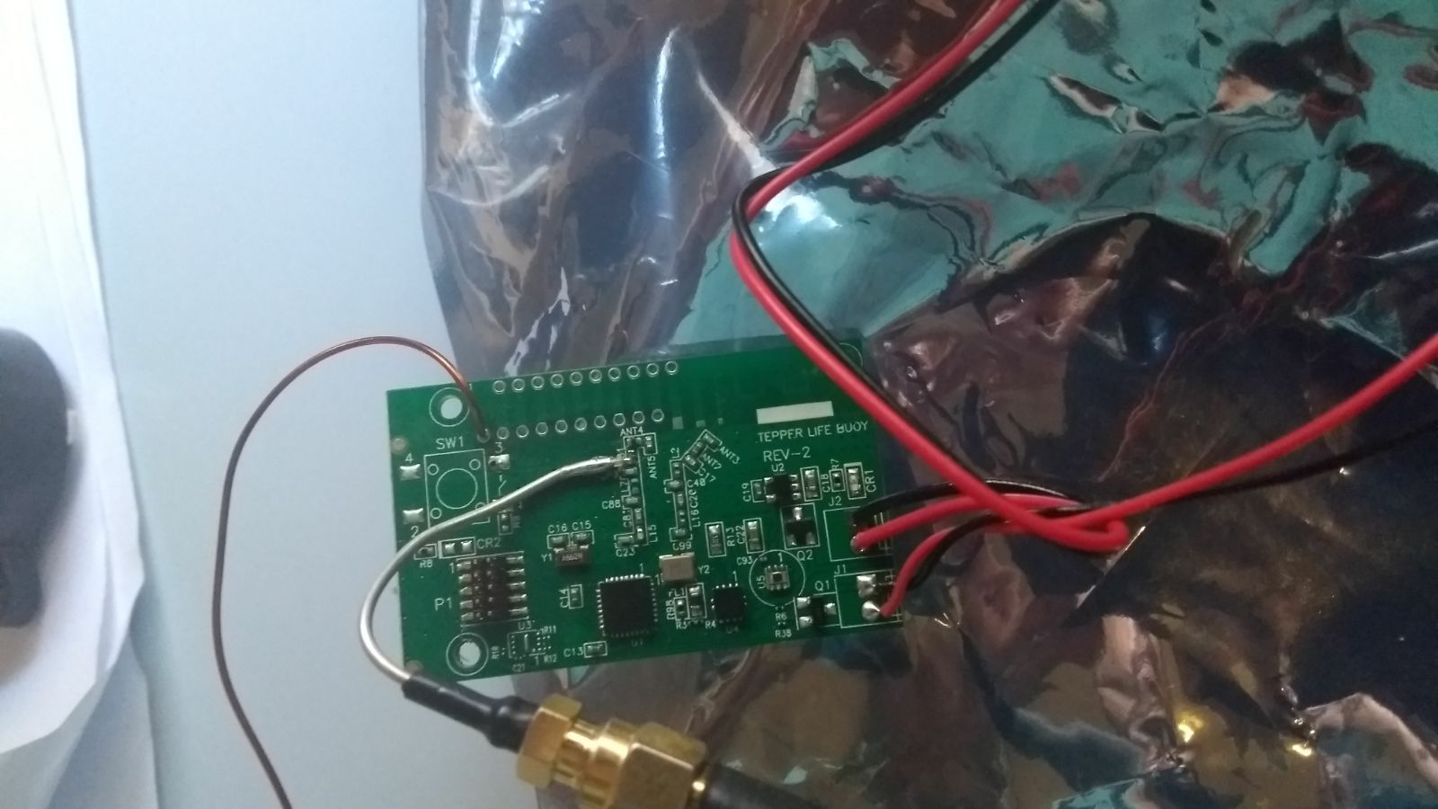

  • To avoid confusion, could you post a picture of how/ where you measure?
    Have you done the same measurements on a unmodified CC1350 STK? (both 868 MHz and 2.4 GHz is of interest)
  • Hi TER,
    Attached a photo for how we connected the 433Mhz (we don't have a picture from the 2.4Ghz, but it is just before the printed antenna.

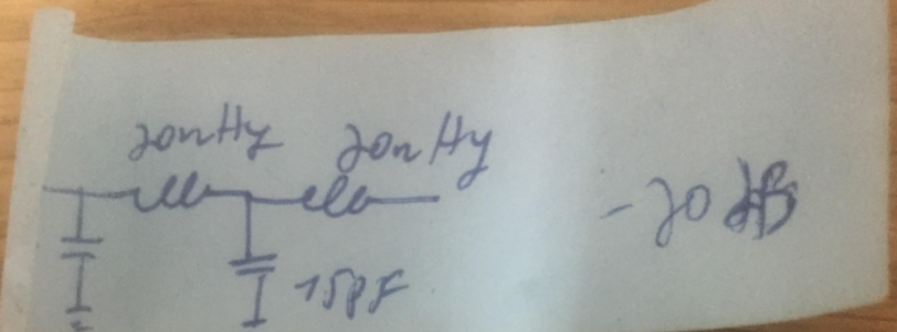

    we have made a filter to reduce the third harmony, and it seems to work.
    Question is if it should have been so high in the first place, and if the power of our signal at 433, is as exppected:
    87uv/M measured from 3 Meters, configured to 14DB.

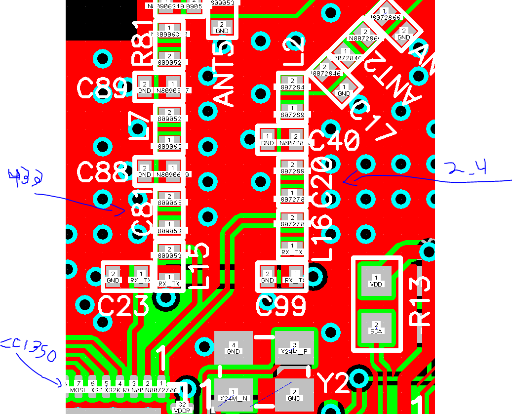

  • Btw, do you have a schematic you can share?
    On the picture ant4 and ant5 looks to be mounted?
    What I see of the layout on the picture is that the filter does not have optimal layout. When all the caps to ground goes to the same side part of the signal can bypass part of the filter. If you take a look at our reference designs the caps to ground in the match/ filter every second one are always rotated 180 degrees.
    Do you have the conducted version of "87uv/M measured from 3 Meters, configured to 14DB."? It's easier to compare conducted numbers in dBm.
  • Hi TER,

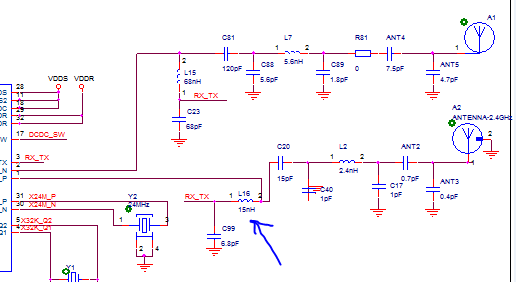

    Bellow is the Original Schematics, filter is based on 868 ref design.
    We replaced the bellow components to fit the 433 ref design:
    L15 - 68nh --> L15 220nH (0402)
    C81 - 120pf --> C14 330pf (0402)
    C88 - 5.6pf --> C12 4.7pf (0402)
    L7 5.6nH --> L13 20nH (0402)
    C89 1.8pf --> C13 12pf (0402)
    Ant4 7.5Pf --> L14 20nH (0402)
    C23 - 68pf --> C23 330pf (0402)
    Ant4 and Ant5 are assembled, but disconnected from prob.
    R81 was dissasembled and prob is connected to a single pad of the R81.
    Attached is the layout, RF path was supposed to be exactly the same as CC1350_STK.
    Can you please specify the components that are not the same as the reference?
    The "87uv/M measured from 3 Meters, configured to 14DB" was done in an RF shielded room in a test lab for CE standard, they do not make conducted testing.
    We made a conducted test were we saw the high 3rd harmony, sent earlier.
    YTE

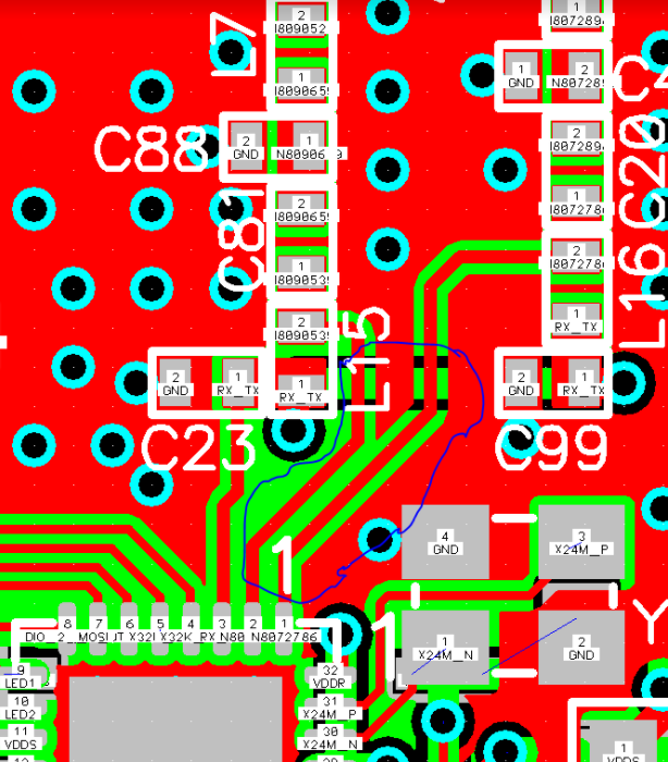

  • It seems like the 3rd harmonic of 433 MHz is leaking over to the 2.4 GHz path. Can you add a 1.3 GHz notch on the 2.4 GHz path to see if this helps.
  • Thanks Richard,
    we will check.
    What about the fact that both RF_N and RF_P both put out the same level of 433.92MHZ signal? is that an expected behaviour on a single ended configuration?
    We want to be sure that the core isn't configured as differential.
    We are also disturbed by the fact that power configuration change on easylink doesn't have any affect on the output power.
    what is the way to verify that easylink configured the rf core propperly?

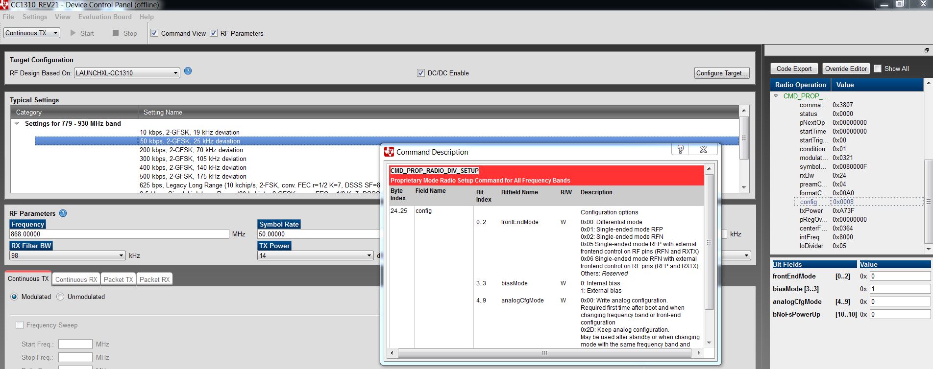

    The output power should not be the same level at both RF_P and RF_N if single-ended is chosen.

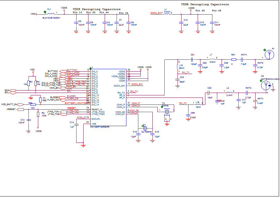

    The RF front end can be configured  in SmartRF studio:
  • Thanks Richard,
    So to make sure, our design is as attached  (based on cc1350STK).
    for the A1 antenna (433Mhz), we should configure the config bits to  0x02 or to 0x05?
    Should the biasMode be set to 0x0 or 0x1?
    YTE.
  • Hi Richard,
    So our original front-end configuration is 0x2(single ended rf_n) , and bias mode is 0x1 (external bias).
    Still, we see the same signal power on both rf_n and rf_p (433.92Mhz).
    also, changing the power level doesn't seem to affect the signal.
    BTW - why on smartRf 433 configuration, power can only be changed between 6-14db, where in 868 power can be set to -10db?

    We use the sensortag cc1350 as reference, which is planned for 868/915Mhz, and we use it for 433Mhz, do you think it could make it easier for the signal to leak between rf paths?
    Could this be related to layout issues (pcb depth, close paths etc.)?, i attach gerber files and appreciate if you could have a look.

    The 433 filter reference is a 3 level filter, while our design (based on 868Mhz) is a 2 level filter.
    So when replacing the components from the original cc1350STK design to the 433Mhz design, we didn't add the antenna matching components as we didn't have place in the layout.

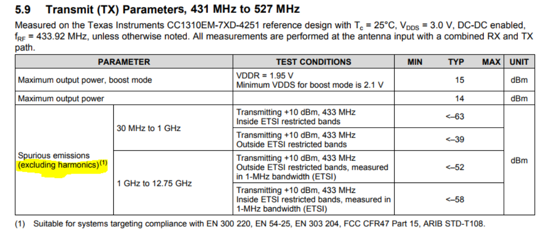

    We have made progress in understanding in the spurious emmision issue, and could use some advise.
    1. we have made conducted measurements, at end of filter not including antenna and matching components and saw 3rd harmonic (1.3Ghz) at -25dbm.
       We checked it also on TI cc1350 sensortag and got -19dbm.
       The 3rd harmony of the cc1350 seems to be very high!
       From some reason, harmonies power is not mentioned in the datasheet for 433 (although it is mentioned for other frequencies):
    2. After severall filters didn't solve the problem (we even tried -40db filter on the 433 path), we started looking for other contributors.
    3.testing with spectrum analyzer, we got to the conclusion that the a significant part of the 1.3 Ghz is leaking from the 433Mhz Path to the 2.4 Path around the marked area in the layout (another option is that processor itself outputs 1.3Ghz on the 2.4 Path):
    4. All tests we have made are attached. Note that all tests done conductive and without connecting ground to spectrum. however it is accurate enough to approve our assumption.
    5. We think to continue in two directions, and would advise from TI experts:
         a. change the filter on the 2.4 path to reduce 1.3Ghz --> not sure if it would be effective enough...
         b. change layout to assure 1.3Ghz doesn't leak --> unless we will find out that the problem is in the processor itself, and than it will not help, please advise.

  • To get a highly efficient PA the 3. harmonic goes up.
    The assumption is that the 3. harmonic leaks from RF_P to RF_N (or the other way) internally in the chip and to avoid issues:
    - Use a RF switch on the path with the highest frequency to increase isolation.
    - Or, implement a notch on the path with highest frequency to filter out the harmonic.
    - Or, use differential design.
  • Thanks TER,
    We will try implementing a notch on the 2.4 Path, we prefer not to relayout the pcb.
    We saw on simulation that by replacing L16 on the 2.4 path from 15nHy to 2.2nHy, we reduce 30db on 1.3Ghz, and gain 2.5db on 2.4Ghz:
    We are assuming that the RX_TX path has high impedance, does it?
    if not, can you recommend a better filter for the 2.4?
    for the 433, to reduce 1.3Ghz,we replace inductors by 15nHy, and capacitors by 15pf, simulation shows -20db:
    If you think it makes sense, we will check it conducted, and return to lab for spurious emission testing.
    YTE
