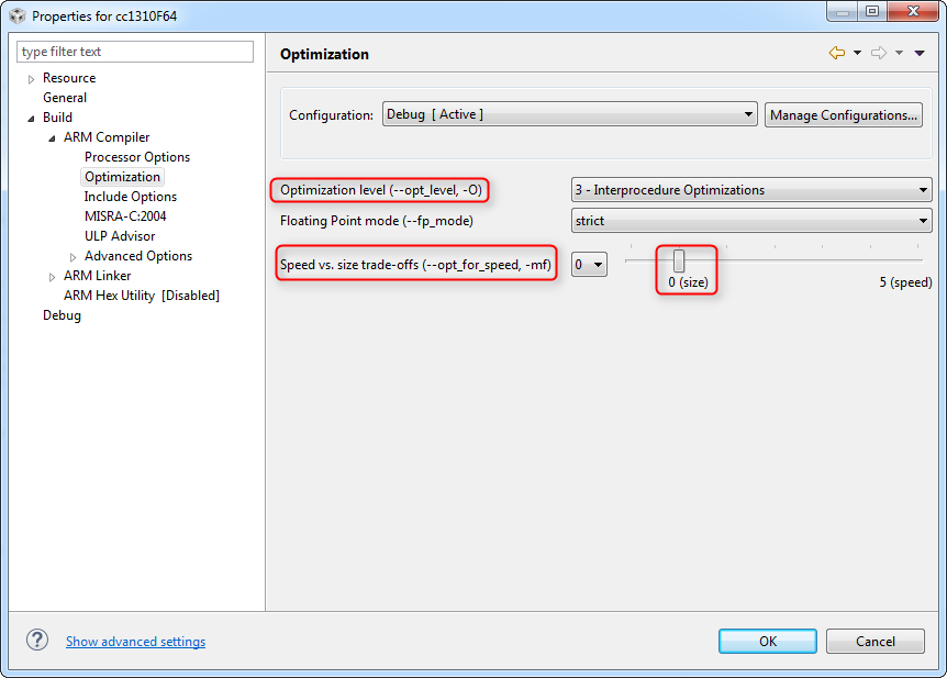

I'm using the CC1310 Launchpad and running the 15.4 stack collector example. I wanted a better way to stream data, so have tried to initialise the UART.
What I found, however, is that when I put in place this code:
    /* Initialise UART */
    char test[] = "Success!";
    UART_init();
    UART_Params_init(&uartParams);
    uartParams.baudRate  = 115200;
    uartParams.writeDataMode = UART_DATA_BINARY;
    uartParams.readDataMode = UART_DATA_BINARY;
    uartParams.readReturnMode = UART_RETURN_FULL;
    uartParams.readEcho = UART_ECHO_OFF;
    uartHandle = UART_open(Board_UART0, &uartParams);
    if (!uartHandle) {
    	//LCD_WRITE_STRING("UART_open failed", 10);
    }else{
    	UART_write(uartHandle, test, sizeof(test));
I get an error:
#10099-D: program will not fit into available memory.  placement with alignment fails for section ".const" size 0x865 .
Looking at my compilation log, it shows:
"../cc1310lp.cmd", line 100: error #10099-D: program will not fit into available memory.  placement with alignment fails for section ".const" size 0x865 .  Available memory ranges:
   FLASH        size: 0xe000       unused: 0x7e7        max hole: 0x5cb
error #10010: errors encountered during linking; "collector_cc13xx_lp.out" not built
>> Compilation failure
makefile:167: recipe for target 'collector_cc13xx_lp.out' failed
gmake: *** [collector_cc13xx_lp.out] Error 1
gmake: Target 'all' not remade because of errors.
What could be causing this? Surely an example like this (made to expand on) can't already be close to the maximum memory?

  • Is your device the CC1310F64 (64KB system flash)? If so, then you memory map makes sense to me.
    To get the rest of it to fit in flash, you can try increasing optimization (favoring code size) and see if that reduces the code size enough.
    ki
  • My optimisation is currently at it's maximum level to reduce the code size.
    I'm using the CC1310 launchpad, so it's the 128 KB version. Does this mean that the examples install with the wrong memory map?
