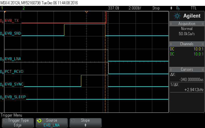

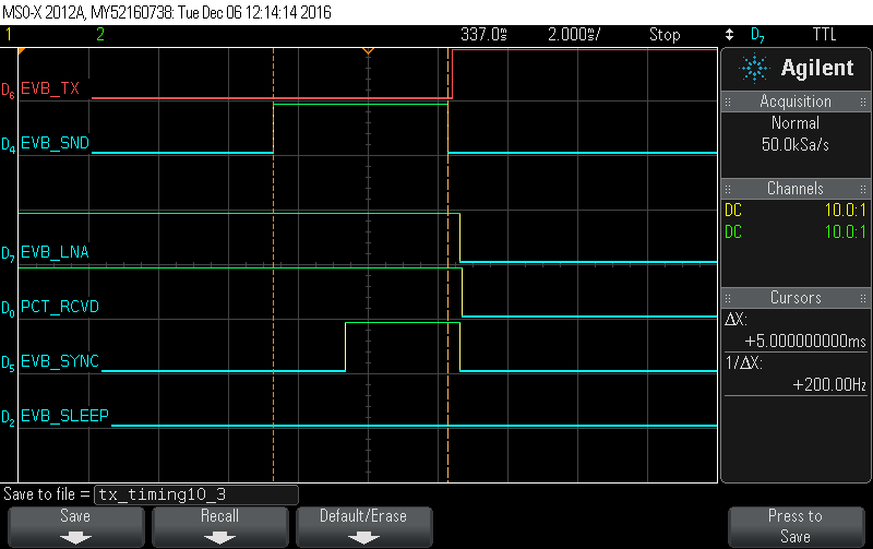

Here the results:
EVB_SND                     – PA is enabled ( packet transmit indication)
EVB_LNA                     -  LNA enabled  ( receive indication)
  EVB_SYNC                   – high when sync is found in the receiver, and low when the  packet is     received or   reception aborted)
Packet parameters:
Preamble length:8
Sync     length:2
Length field length:1
Data length:17
CRC length :2
Total:  30 byte
Datarate:50000
We see that :EVB_SYNC duration is 3.28 msec (20byte)
EVB_SYNC goes low 340mcs after end of packet transmission.
So transmission duration 30*8/50000=4.8 msec
We see that EVB_SND duration is 5 msec.
Q1: How can we estimate start of preamble transmission ?
Q2: When SYNC was found?
Q3: Why  packet transmition duration is more than packet length?(transition to TX mode duration was included?)
    The first preamble bit should on the air 384 RAT ticks (96 us) after the startTrigger fired. If you use absolute triggers, you should be able to estimate it precisely. Please also consider to use the modulator data output to analyse the transmission process.
    The "sync found" event is not highly accurate. It happens a bit after the sync word was received because of internal processing. I suggest to use the RX timestamp appended to the packet, because the RF core firmware calculates the correct packet start and compensates for the mentioned processing delay. If you want to have the time of the "sync found", then you need to add the duration of the preamble and the syncword to that timestamp.
    If you measure the "packet transmission duration" from EVB_SND 0/1 until EVB_SND 1/0 (PA signal), then keep in mind that this also contains the PA ramp-up time and some time after transmission has completed. I suggest to use the signal MCE_GPO0 if you want to know how the other signals relate to the packet timing. The following timing diagram shows the PA signal and TX data. It has been measured with the packet setup from above.
    • A: Enable PA (0)
    • B: First preamble bit starts (~15µs)
    • C: Last CRC bit finishes (4.815ms)
    • D: Disable PA (4.815ms + 185ms = 5ms)

  • Hi Richard,
    packet transmition duration is duration  from EVB_SND 0/1 until EVB_SND 1/0
    BR
