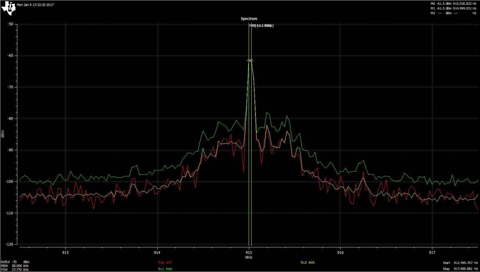

    I have verified the CC1101 is pretty spot on at 915Mhz, following is a screen capture of the CC1101 in continuous TX mode via RFsmart studio. The RED trace is current RF activity, GREEN is max and YELLOW is average.

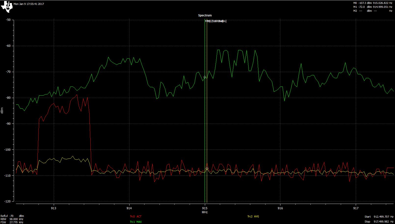

    Now here are some screens from the CC1201+CC1190. We have verified the clock is indeed spot on 40Mhz. Same settings as the CC1101. But the CC1201+CC1190 seem to be channel hopping, only in MHz not KHz..
  • What type of board are you using on the CC1201 + CC1190 side? You write that you use "EM Revisions = CC1200-CC1190EM 915Mhz", to my knowledge this is a EM that doesn't exist?
    I have seen a couple of cases where the spectrum from CC1200 is too wide when the cap between pin 23 and pin 24 has used a wrong value.

    Also the Cap between pins 23-24 is 1800pf
  • - Check if you get the same Tx spectrum from the CC1201 part of the CC1201 board (remove the SAW filter and use an antenna in this point)
    - Replace C12 in case of assembly error.
    -Does the software you are running with the CC1201 + CC1190 only send a CW? Have you tried to control the board with SmartRF Studio?
