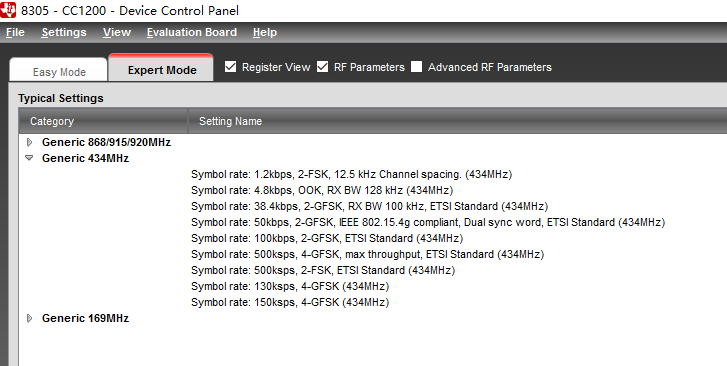

    When I use SmartRfStudio V2.5.1 to export the register settings for CC1200, I found it doesn’t have a default setting for 433M and 250k bps 2-GFSK. The following is the list of default settings:

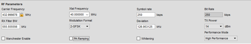

    So I start with the first one (1.2kbps). I can see value for register “AGC_CFG0” is 0x87. And then change the RF parameters as following, and I can see “AGC_CFG0” is still 0x87.
    If I start with 100kbps, 2-GFSK, “AGC_CFG0” is 0x80. After I adjust the settings to the same as the picture above, it is still 0x80.
    So “AGC_CFG0” is actually not tuned for 250kbps automatically by the software when I change the bit rate. It remains the value as when I select a default setting.
    Some other registers has the same issue.
    So my question is:
  1. Can SmartRfStudio tuned all the necessary registers to optimal settings when I change my settings automatically?
  2. If not, what should I do to get optimal register values for my setting (250kbps, 2GFSK, performance mode)

     I think SmartRfStudio should provides more default settings for different configuration for CC1200, like for CC1101/CC110L, where there are so many default settings for different data rates.
     I still have difficult in selecting the closest "Rx BW". 100k uses 208kHz, and "500ksps, 2FSK, ETSI Standard (434Mhz)" uses 833kHz. As I should use 555k, shall I select the latter to start? Since I use 2GFSK, I would first not consider 4GFSK or OOK. Thank you.
