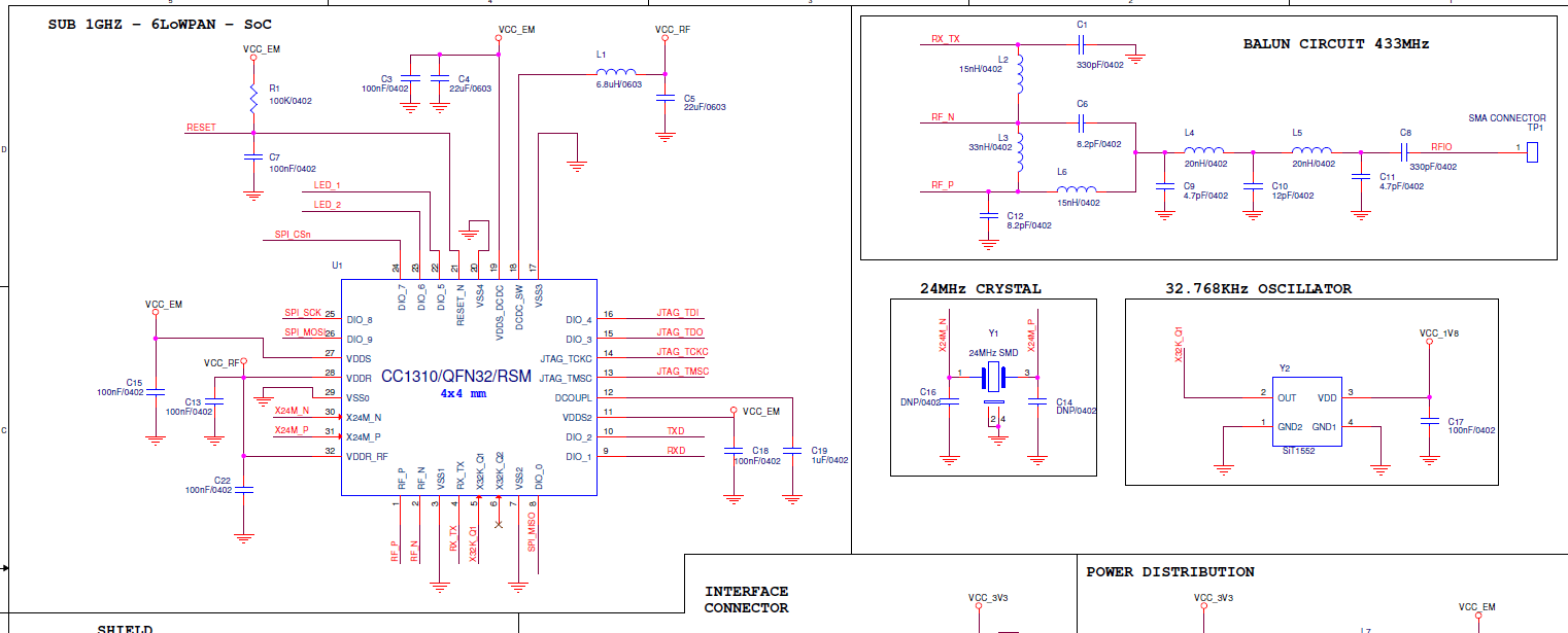

  • We are using TXCO on 32kHz. Here's the schematic:

  • I'm also checking in the TCXO supply from LDO, the voltage level seems correct (1.789V) and I check the TCXO pulse on my scope, it also works well. Could it be CC1310 problem?
  • It sounds like the 32KHz oscillator is not able to start, this can be due to various HW issue. The most likely is assemble related.
    /TA

    In the CCFG.c file you should set:
    #define SET_CCFG_MODE_CONF_SCLK_LF_OPTION 0x1 // External LF clock
    #define SET_CCFG_EXT_LF_CLK_DIO 0x01 // DIO number if using external LF clock
    This is not well documented, I'm going to add a ticket to change the clock section of the TRM.
    The hardware is designed to detect if a crystal connected starts to swing but doesn't have circuitry to detect if a TCXO has correct swing.
  • I see, so in order to use TCXO, we should configure it as external clock, not as crystal replacement for LF XOSC, right? Great to know now since we just perform sampling production and only produce few. Thank you very much for your great help!
  • Yes. This should be possible to test on the board you have by cutting the line to Q1 and solder on a thin wire to a DIO.
