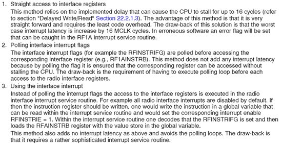

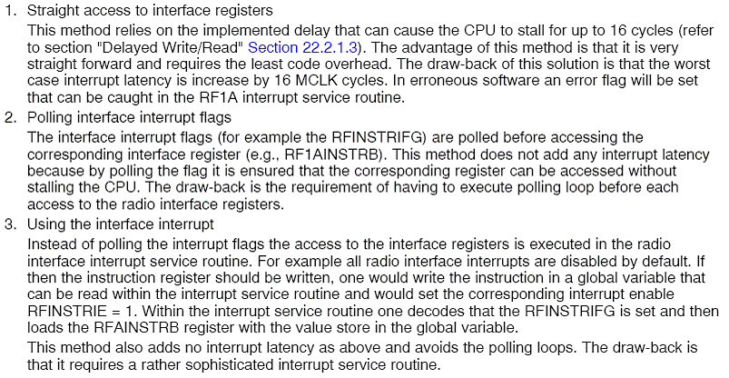

    2. The radio interface supports a few access modes, particularly this delay mode where it can cause the CPU to stall (up to 16cycles) to "catch up". UG, section 22.2.6 provides some guidance on this:
    Agreeably, this is not a very elegant method, but at least it provides a solution to using DMA with RF1A.
    Dung
