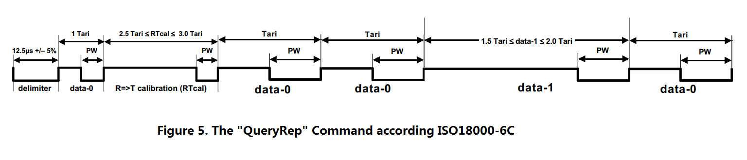

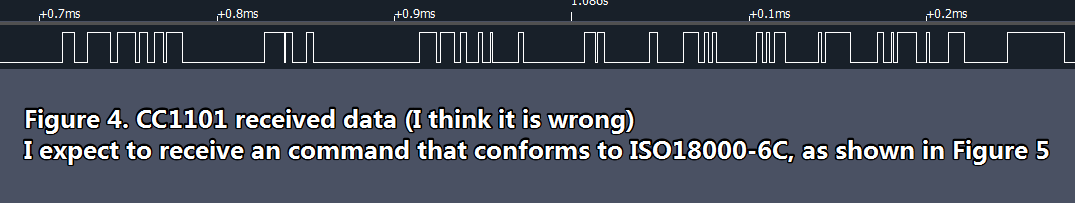

3. According to ISO18000-6C, the reader does not send information, the receiver should remain high, but in fact CC1101 is not the case.
4. How to configure registers to receive correctly. I tried a lot, but did not receive the correct command. I use a logic analyzer to observe the timing.

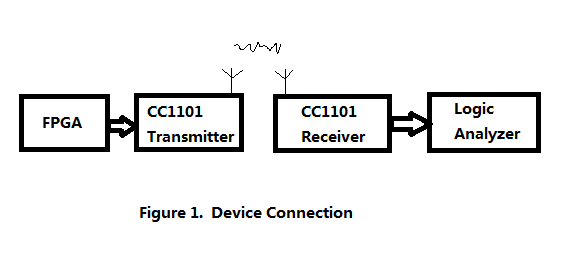

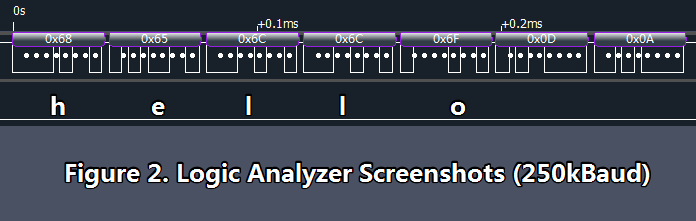

1.  I use a development kit to send and the other to receive. The receiver can normally receive data with a baud rate of 250 kBaud sent "hello" using an FPGA.

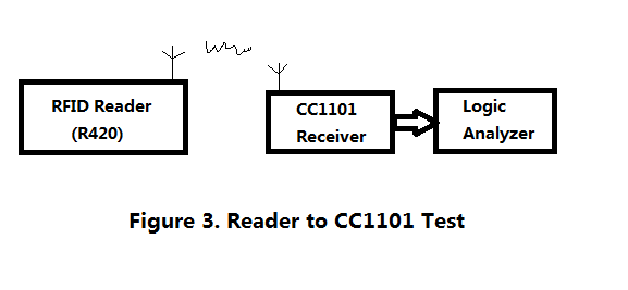

2. But it can not correctly receive the data sent by the reader

  • zhai ma,
    You write the "hello" example works between two CC1101, but when you try to receive the signal from the RFID reader it fails. The CC1101 is sensitivity to too much signal strength, for the settings you have you will need to be somewhere between -80 and -20dBm to be able to receive anything. Can you confirm your setup and the power levels going into the CC1101?
    I looked thru the register settings and could not find anything wrong.
