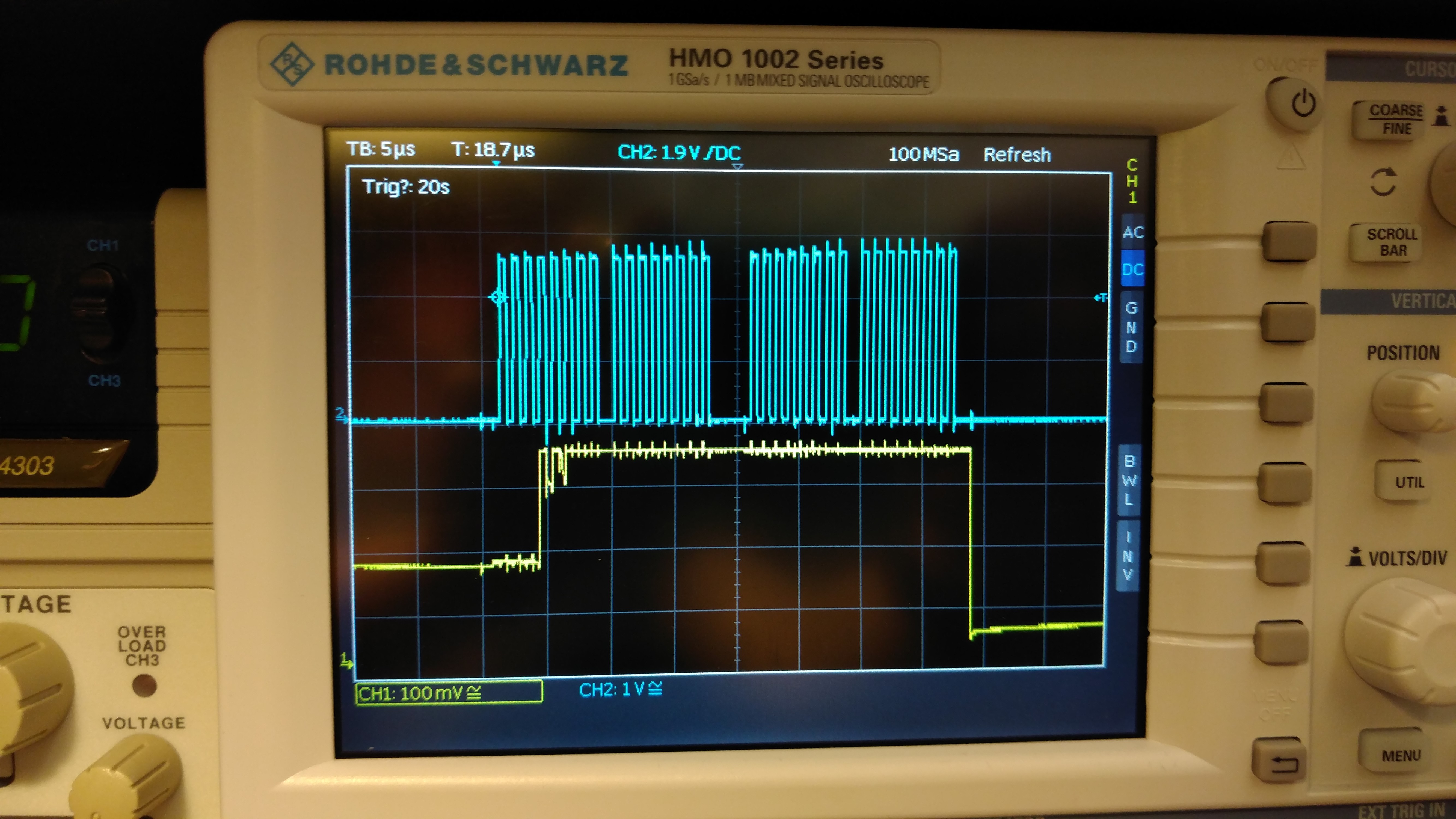

While trying to use the CC1125 on a custom board with the CC debugger, we're seeing logic level issues on the SPI MISO line. With our logic high as 3.3 V, we're only seeing a ~300 mV signal coming out of the MISO line and the reply itself seems incorrect based on the commands sent to the device at CC debugger powerup. (See attached photos, which show the clock pulses sent at CC debugger reset in blue, and the CC1125 reply on the MISO line in yellow)
Probing our CC debugger connector on the board, we were able to decode the first commands sent to the CC1125 when the debugger is first turned on (SRES followed by SFSTXON) and subsequently verify that those lines were working as expected. However, the CC debugger LED stays red.

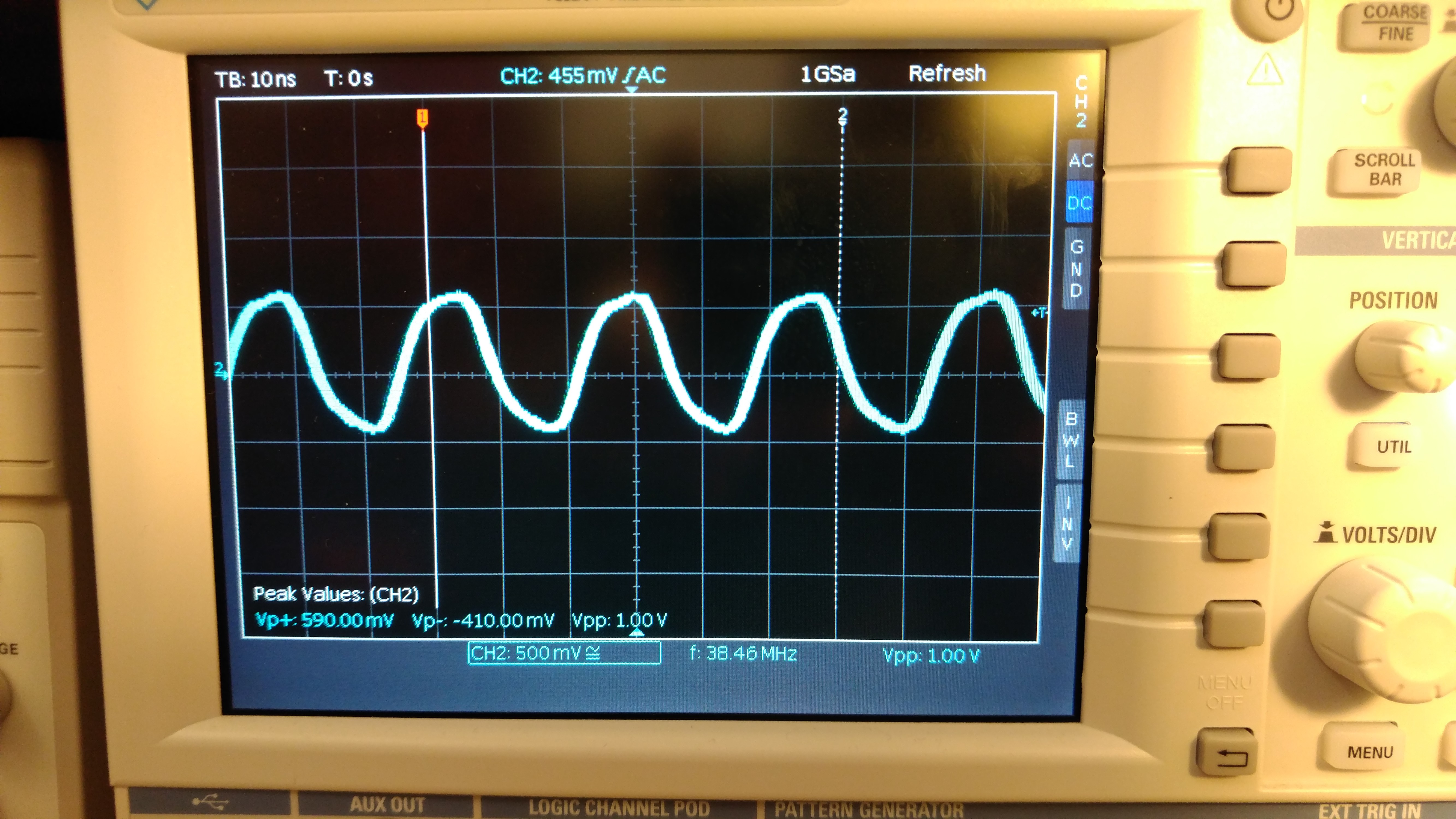

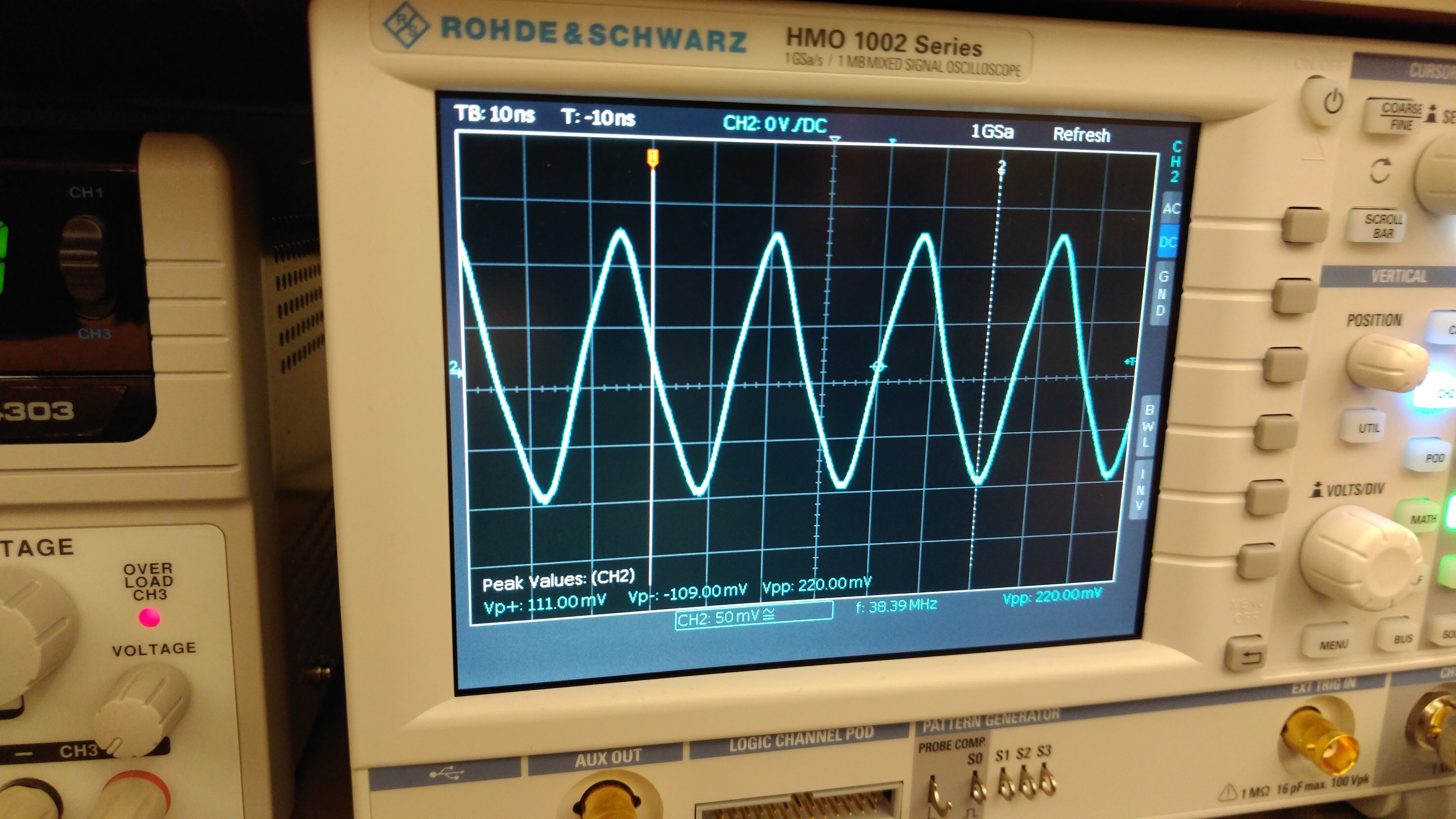

EDIT: We checked our oscillator, and the peak-to-peak voltage is too low (frequency is correct):
We're seeing ~0.2 mV peak-to-peak when our datasheet specifies a minimum of 0.8 V peak-to-peak when supplied with 3.3 V (supply voltage is correct).
