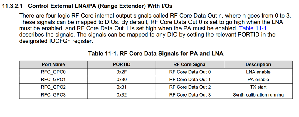

We are designing a gateway that has external front-end module. So we need to activate external LNA and PA during transmit and receive processes. For this, we used RF Core Data Signals to activate external LNA and PA according to SWCU117F document section 11.3.2.1.
We assigning these signals (RFC_GPO0 and RFC_GPO1) to DIOs. The code is shown below.

    there are many customers using those signals and I have never heard that they are not working properly. How often does this happen? How do you check how many symbols are sent on air? Which part of the transmission is missing? Are you sure that the front-end is working correctly?
    You can double-check what goes out on air by observing the MCE_GPE0 signal as described here and here. MCE_GPE0 shows the data that goes to the modulator.

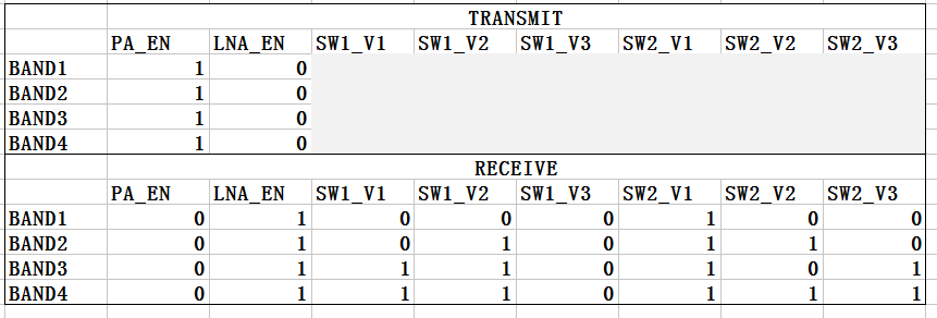

  • Hi Richard:
    Thank you for your reply. Well, may be I made a bad description for my application.
    Actually I need to control the switches according to the state of the RF core, transmitting or receiving, and also need to take the frequency band used into account at the same time. According to the filters parameters, we have divided the application frequency into three bands, the logic of these three switches' level aren't just the same or invert to the RF core signal, So I cannot just only route the RF core signal to these pins, I need to handle the state where the radio is neither transmitting nor receiving. So, how can I do?
    please create a truth table for all of your signals as Michael has suggested and post it here. Then we can see what is possible.
  • TRUE TABLE:
  • Again you've missed the state where the radio is neither transmitting nor receiving, and I assume the unfilled cells in your transmit table are "don't care" ?
    You could achieve most of that behaviour by re-muxing everything when you change bands.
    SW2_V1 and SW1_V3 never change, so just wire them directly to the relevant power rail.
