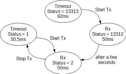

I need to receive a packet within a window. I have modified rx.c in the IAR\CC1310DK_7XD\rfPacketErrorRate example and have included the code in its entirety below. My changes are marked with the ADD_MY_CHANGES macro. Essentially I post an Rx command with:
RF_postCmd(rfHandle, (RF_Op*)&RF_cmdPropRx, RF_PriorityNormal, &rx_callback, RF_EventRxEntryDone);
The parameters are set so the command times out after 50.5ms, but would normally expect a packet every 50ms (from another board running tx.c). I am observing the status returned by:
((volatile RF_Op*)&RF_cmdPropRx)->status;
The behaviour I am seeing is:
1) if I start the board then run Rx with no packets being received, then the timeout is 92ms and status = 13313 (= 0x3401 = PROP_DONE_RXTIMEOUT)
2) if I then turn on the other board to Tx packets, the packets are received every 50ms and status = 13312 (= 0x3400 = PROP_DONE_OK)
3) after almost no time at all to few seconds (the time can vary) packets are received every 50ms and status = 2
4) if I then stop the Tx, the timeout is 50.6ms and status = 1
after leaving state 2 the board will be in either state 3 (Rx) or 4 (no Rx) and not return to either state 1 or 2. Diagramatically I'm seeing this:
I am using the IAR IDE and tirtos_cc13xx_cc26xx_2_21_00_06
Does anyone have any ideas why I am seeing this behaviour please?

    I have done those tests and also added some code to show the event value on the LCD in the case of !(e & RF_EventRxEntryDone)
    Repeating the test using RF_runCmd() instead of RF_postCmd() and not using the semaphore:
    Both Rx and timeout worked relaibly with the Rx period being 50ms but the timeout being 92ms.
    Modifying the callback function as per your code:
    (1) with RF_runCmd() and:
       (a) assert() in place:
           Rx - runs for a short time then asserts
           no Rx - asserts immediately
       (b) changing assert() for (a uint64_t type) event = e:
           the 'other' Rx callback value is 2 (although it could be preceded by another value quicky)
    (2) with RF_postCmd() and:
           as above
           as above but when going from state 2 to 3 the status value goes breifly to 1 before going to 2
    David.
