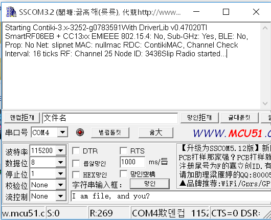

    And, this image shows how slip-radio.bin that I have compiled runs.

  • It seems that your slip radio still doesn't work. Do you download my attach slip radio binary to your CC1310DK? Can you attach full 6lbr.log?
  • Thanks for your attention, Yikai.
    My full log is
    6lbr.log
  • It's looks that your slip radio doesn't respond. Do you download my attach slip radio binary to your CC1310DK?
  • Try to use this attached slip-radio-cc13xxdk.bin to test again. It works on my CC1310DK.
    slip-radio-cc13xxdk.zip

    2017-04-24 5:23:42.177860: INFO: SLIP: Starting Contiki-3.x-3245-gfbffcc2
    With DriverLib v0.47020
    TI SmartRF06EB + CC13xx EM
    IEEE 802.15.4: No, Sub-GHz: Yes, BLE: No, Prop: No
    Net: slipnet
    MAC: nullmac
    RDC: ContikiMAC, Channel Check Interval: 16 ticks
    RF: Channel 25
    Node ID: 3436
    Slip Radio started...

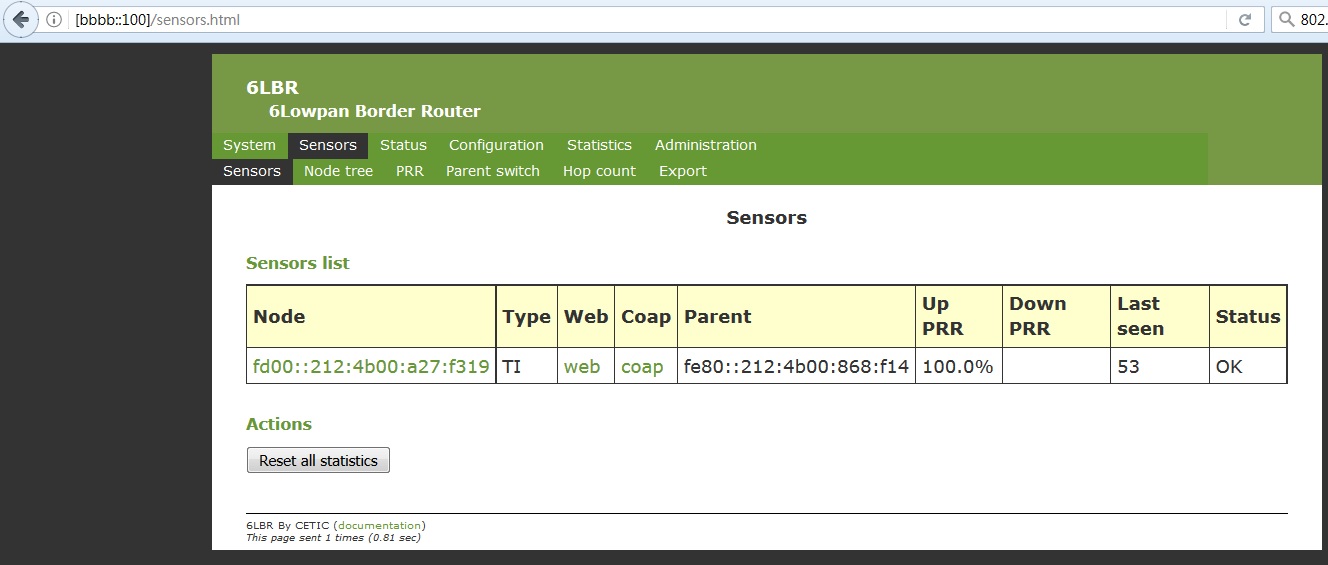

  • According to your 6lbr.log, 6lbr starts correctly now. You can try to use Firefox to access to [bbbb::100]
  • If I enter [bbbb:100] in firefox, then google search window is shown.
  • It should be double colon between bbbb and 100. You should use [bbbb::100] instead of [bbbb:100].
  • Oh, come on. I can access to first page.
    But if i press 'sensors' tab ( any other ), then browser shows "Unable to connect ...", and after some time, if press refresh button, same thing happens.
    And, it operates properly only when 6lbr service is restarted.

  • Do you mean when you click on Sensors link, you can not see the page like the followings?
  • Sorry, Yikai.
    Page access is permitted only once, and any more accesses are refused.
    That is, if I enter [bbbb::100]/sensors.html instead of [bbbb::100], then browser show that page.
    But if I do something on the page, browser show Unable to connect.

    I can access to 6lbr page only once.
    Next time the access is refused. I am going to have total blood pressure.
    Why?

  • I can access 6lbr page first time and further access are refused. Ping [bbbb::100] works, so I tried to troubleshoot using windows internet connections troubleshooter which gave error that board is not configured to accept connections on port 80. Any idea how to resolve this?
  • There's something wrong with latest 6lbr. You can go to /6lbr folder and run "git checkout ff69ae4214407eeec4c71f87589ac4bc7d3a8a49". You will get 6lbr version on 2016 Dec. 22th and you can rebuild 6lbr to test again.
  • That worked like a charm....Thanks YK!
