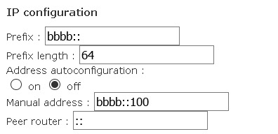

I have a problem with 6lbr.

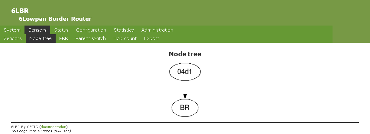

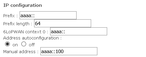

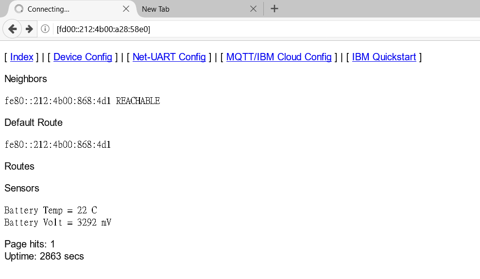

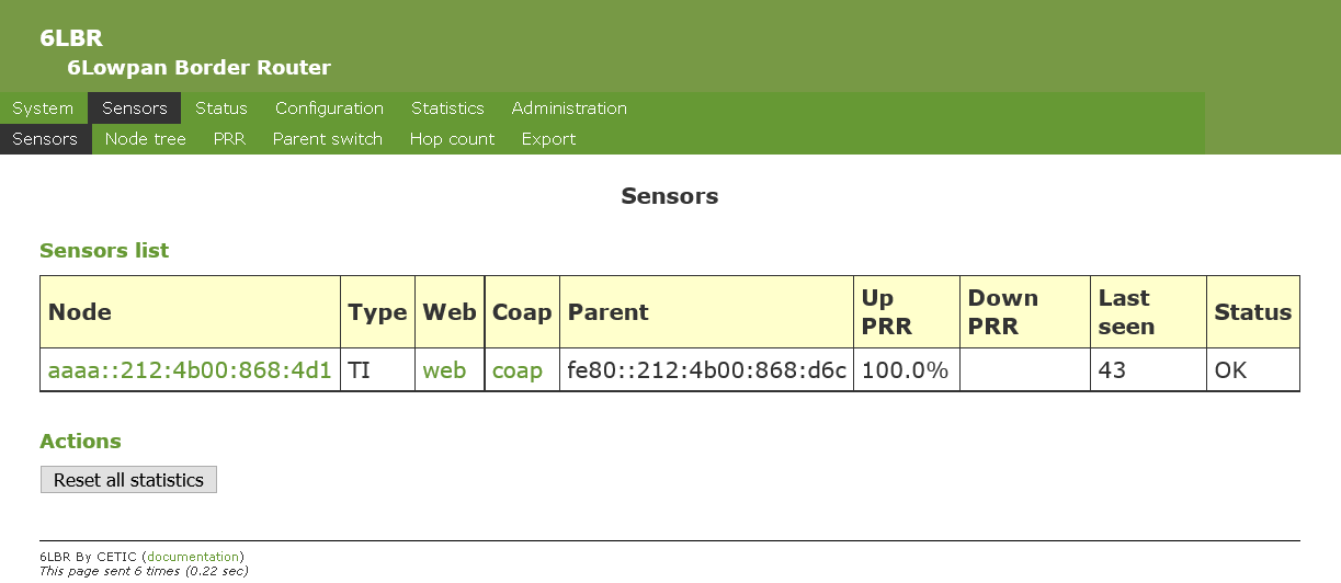

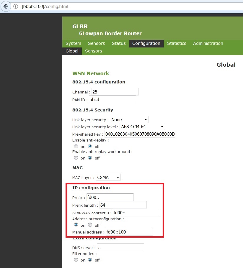

I could get 6lbr page, but when I press other tabs, browser couldn't be connected to that pages.
I don't know why message 'WEB: Buffer overflow' is appeared.
