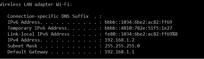

I have some questions about 6lbr border router.
Can I access to 6lbr border router from external network?
And, when enter 'sudo service 6lbr start', what processes can be run on beaglebone?
Best regards.

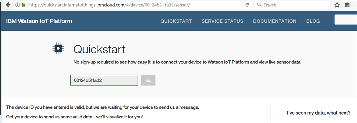

Thanks, Yikai.
It works fine.

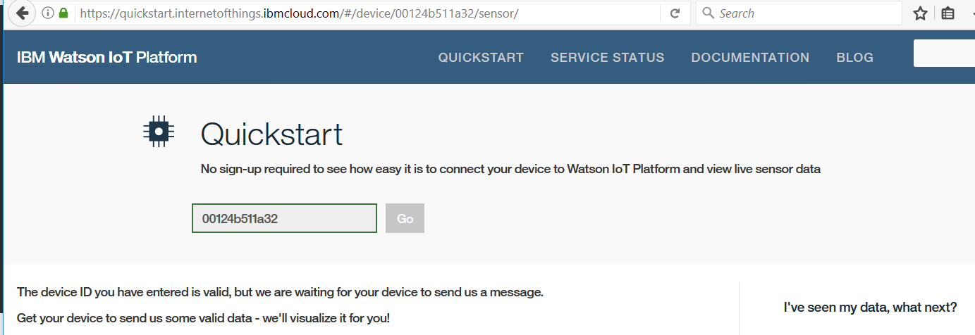

Can I send my data from 6lbr-BR to special center through the internet?
But there is no sensor data on ibmquickstart page when i open that page.
Go button is disabled.
I can see some data of cc1310dk.
But it is only for ti-origin boards.

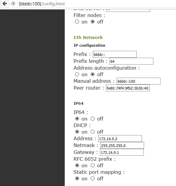

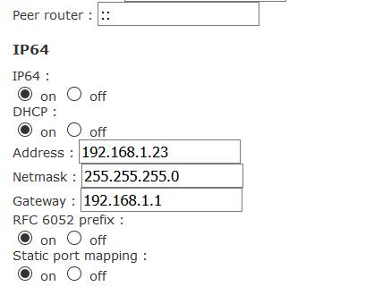

Thanks, Yikai.
Ok.
But beaglebone has another network address different from origin assigned by dhcp once 6lbr is started on beaglebone.
And network address is incremented by 1 whenever beaglebone restarted.
If Address item in IP64 list is less than current beaglebone, then can't access to beaglebone via SSH.
I'll try.

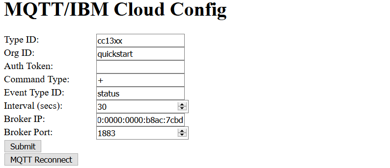

MQTT is a protocol between 6lbr and cloud server, and not between sensor node and 6lbr. Right?
I don't know exactly how does work cc26xx-web-demo.
