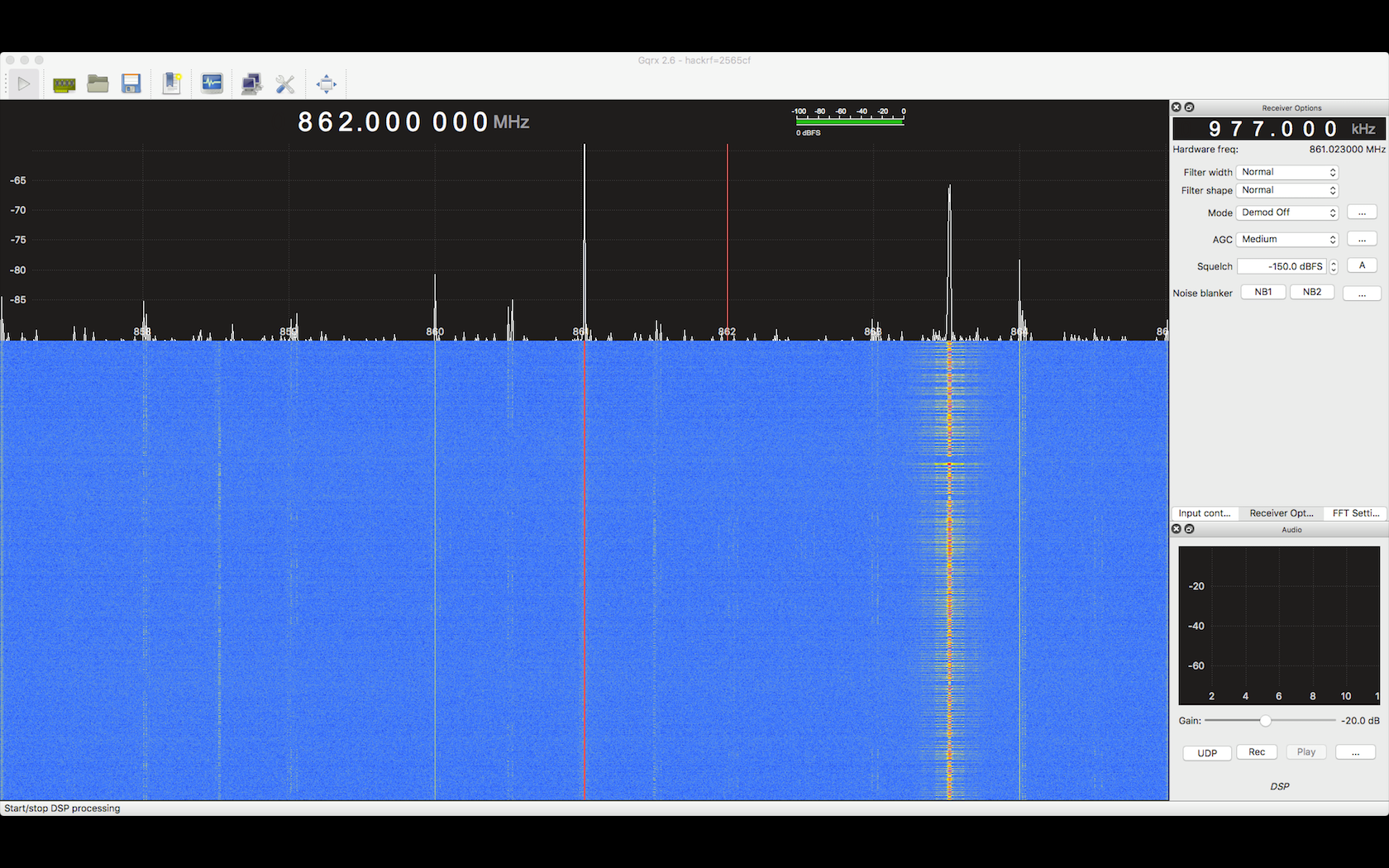

We are developing a sensor network using TI-15.4 stack on CC1310 chip. We've used the example codes for the sensor and collector and modified the following:
  • CONFIG_PHY_ID to APIMAC_GENERIC_ETSI_LRM_863_PHY_131
  • CONFIG_SECURE to false (for packet sniffing)
  • CONFIG_REPORTING_INTERVAL to 160000ms
  • CONFIG_POLLING_INTERVAL to 480000ms
  • TRACKING_DELAY_TIME to 1600000ms
  • TRACKING_TIMEOUT_TIME to 320000ms
  • CONFIG_TRANSMIT_POWER to 7 dBm (testing was done indoors)
We are using a CC1310 Launchpad as the collector, 9 as sensors, and a CC1350 Launchpad as our packet sniffer via Wireshark. We also used a HackRF One to check radio signals sent by the sensors.
First, we initialized the sniffer, followed by the initialization of all 9 sensors, then the initialization of the collector.
During the test, Sensor 9, as identified by its short address, flooded the collector with data requests as shown by the packet sniffer. Below is a screenshot of how the data requests looked like in HackRF:
This went on for a few minutes so we decided to remove the battery of Sensor 9. We checked the device with SmartRF Flash Programmer and it was still fine. We put back the battery and still saw the same results. We thought this was a hardware problem until Sensor 6 suddenly showed the same behavior. This went on for a minute until the collector acknowledged the requests. According to the logs in the packet sniffer, the collector and Sensor 6 had a configuration realignment. Sensor 6 was then able to report, then polled, underwent reconfiguration with the collector. After a few seconds, the collector was flooded again by data requests of Sensor 6. This went on for a few minutes until we decided to remove its battery. The other sensors polled and reported as it normally would.

    This is interesting because I haven't seen this behavior before. I have a questions about your setup.
    1. did you change MAX_POLLING_INTERVAL and MAX_REPORTING_INTERVAL in sensor.c to be a higher value? (it should be at least 160000 your desired polling/reporting interval interval). PS. According to your sniffer log the polling interval is 160s and reporting interval is 480s. The polling/reporting interval gets updated by the collectors configuration request soon after joining a network. So the default sensor polling interval in config.h should be a shorter value so the association process is short, but then the CONFIG_POLLING_INTERVAL and CONFIG_REPORTING_INTERVAL in collector.c should be the value you want the sensor to poll/report after joining the network (this value must be between the min and max polling/reporting interval set in sensor.c).
    I assume the changes mentioned in your first post were all the changes made to the project? If so i can try an reproduce the issue.
    EDIT: The polling rate is controlled by a timer in Ssf.c. The timer can be accessed with the pollClkHandle variable.
  • Hi Brocklobsta,
    I'm part of Ralph's team. We forgot to mention that we also changed the MAX_POLLING_INTERVAL and MAX_REPORTING_INTERVAL to 200000ms and 1920000ms respectively. MIN_POLLING_INTERVAL and MIN_REPORTING_INTERVAL were left unchanged so our values for CONFIG_POLLING_INTERVAL and CONFIG_REPORTING_INTERVAL are between their min/max intervals.

    Sorry for getting back to you late. We've made a few more tests to replicate the flooding and we probably narrowed down on why it happens.
    1. Data flooding was not experienced when testing with Rev. B chips but it was observed when Rev. A chips were used.
    2. Data flooding did not occur when CONFIG_TRANSMIT_POWER was 14dBm. When it was set to 0dBm and 7dBm, data flooding was observed.
    We hope that with this information, you could help us find out why and how this behavior occurs.
