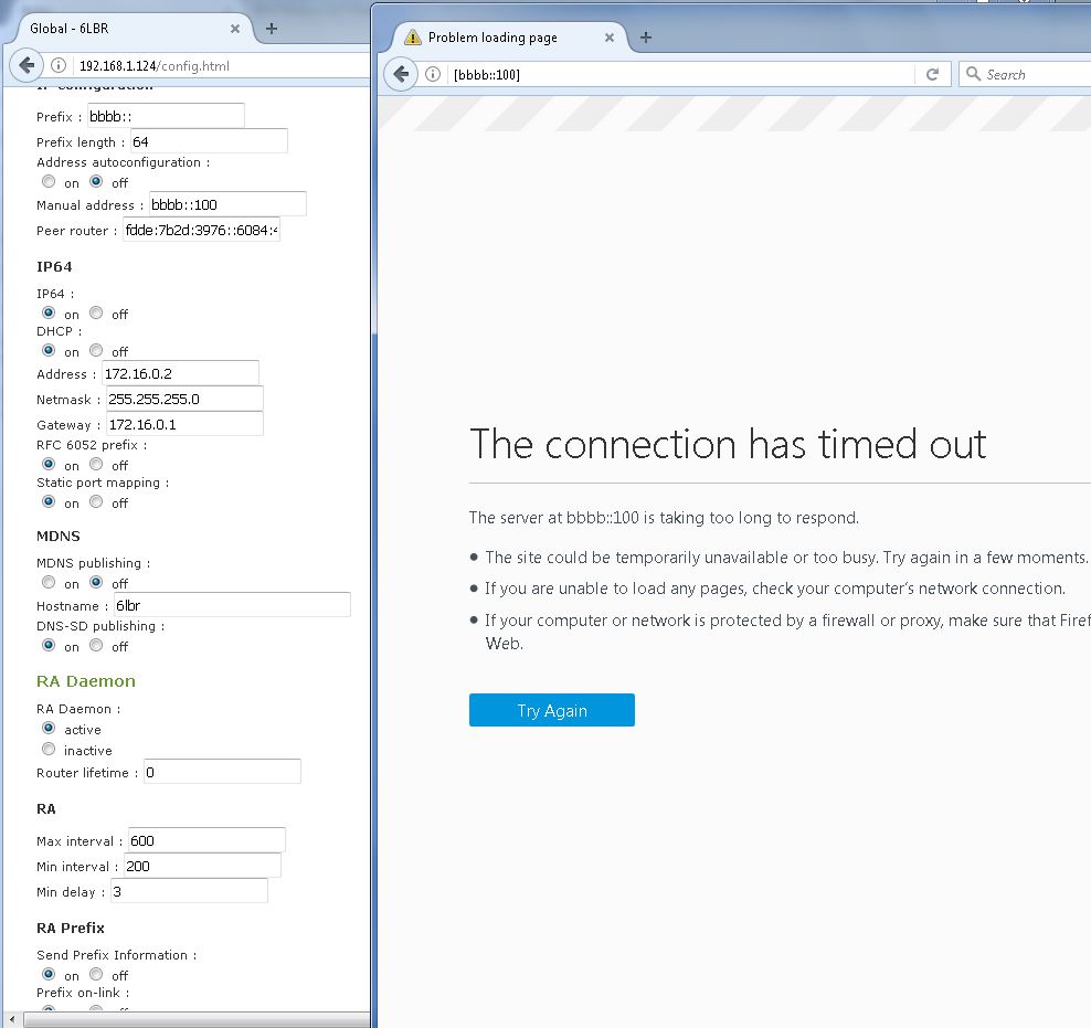

Adding 1 more, We are not able to get the webpage [bbbb::100] if both IPV4 and IPV6 is enabled in Network settings of PC. We are able to get the webpage [bbbb::100] if we only enable IPV6 in network settings or connecting directly to PC. We are using IPV6 Router and ISP is IPV4.

  • en we disable IPV4 and enable IPV6 in PC Network settings we are able to get the webpage [bbbb::100]. But when we enable both IPV4 and IPV6 we are not able to get the webpage after sometime. So i assume that when IPV4 is enabled we are not able to get the IPV6 webpage. So i enabled the IP64 in configuration page.
    So that we can access IPV4 IP and we are able to get the webpage. But the link for web and coap is missing.

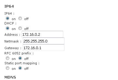

  • Yes. I assume if we are enabling IP64 in webpage so we dont need NAT64. Is that correct? Either way we have configured NAT64 also.

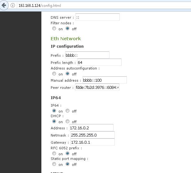

  • You should input IPv6 address of your desktop as Peer router.
  • We have configured the peer router.
    But everything seems to be same. I assume after doing this we will be able to access webpage [bbbb::100] without changing network settings to IPV6 only. Is that what you are expecting after doing this step?
  • IPv6 address of your Peer router should be with fe80::... as prefix.
  • I tried that too, mine is starting with fdde:7b2d......

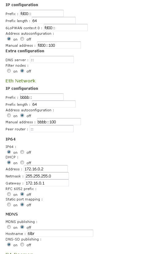

  • Please check the image
  • Try to also enableRFC6052 prefix and Static port mapping.
  • We tried that too.

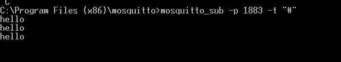

    Please check the following images of the MQTT server running on PC.
    MQTT Subscription on port 18883 on all topics,
    MQTT publishing to a particular topic, i tried publishing by giving IPV6 address also. In both cases i can see the messages in subscription

    No, If we are enabling both in PC network settings. If we enable both IPV4 and IPV6 in PC network settings and the Mosquitto broker is running on PC, then Nodes are not able to connect to the broker. If i enable IPV6 only in PC network settings then i can see the data coming from the Nodes. Why if both IPV4 and IPV6 is enabled in PC network settings we are not able to see the webpage as well as MQTT data.

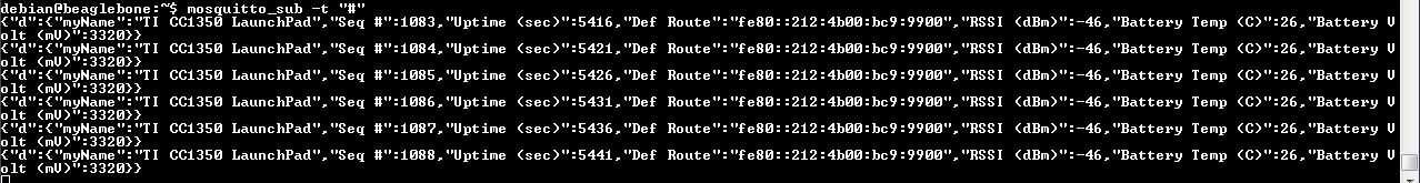

    I can see the data coming when we we execute sudo tcpdump -i eth0 -v -X port 1883
    but we are not able to see the data in MQTT subscribe.
    We tried with local publish and subscribe and it is working,

    One update is there like after trying many things today we could see some mqtt data in tcpdump for sometime, but seems like only data is coming from nodes and no response is going from BBB even though we are able to connect to the BBB mqtt broker from another pc connected in same network. But mosquitto broker log is not showing anything when nodes trying to connect.

    Along with this, we did the following
    1. we configured peer router as the IPV6 address of br0.
    2. Started MQTT broker in br0 IPV6 address.
    3. Configured broker ip of Nodes to the IPV6 address of br0
    Please note that some of those steps that we did may not be really relevant for its working, we are just posting all our configurations.
    Rahul

  • Cheers!!!
    We could able to do that by giving the broker ip as bbbb:0:0:0: x : xyz : xyza : xyz instead of giving bbbb : : x : xyz : xyza : xyz
    Now we are able to connect to local MQTT broker on BBB with both IPV6 and IPV4 routers connected to BBB.
    Rahul
