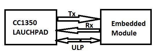

I am working on project in which CC1350 launchpad needs to communicate with a embedded system module through UART which keeps in sleep mode. For achieving communication between two following conditions are there
1. To send data from CC1350 to Embedded module, CC1350 should make ULP pin high for few seconds
2. To send data from Embedded module  to CC1350, Embedded module should make ULP pin high for few seconds
To do so ULP pin should act as as Input as well as Output. How could I make one pin on CC1350 to act as input and output to work as an ULP pin?
  • A pin can't be both in-and output at the same time. But in this case it should be possible to set the pin as an input default (waiting for the embedded module to pull the pin high) and then set set the pin high when CC1350 want to send data to the embedded module.
    You can use the PIN driver to set the pin.
    Thanks for help.
