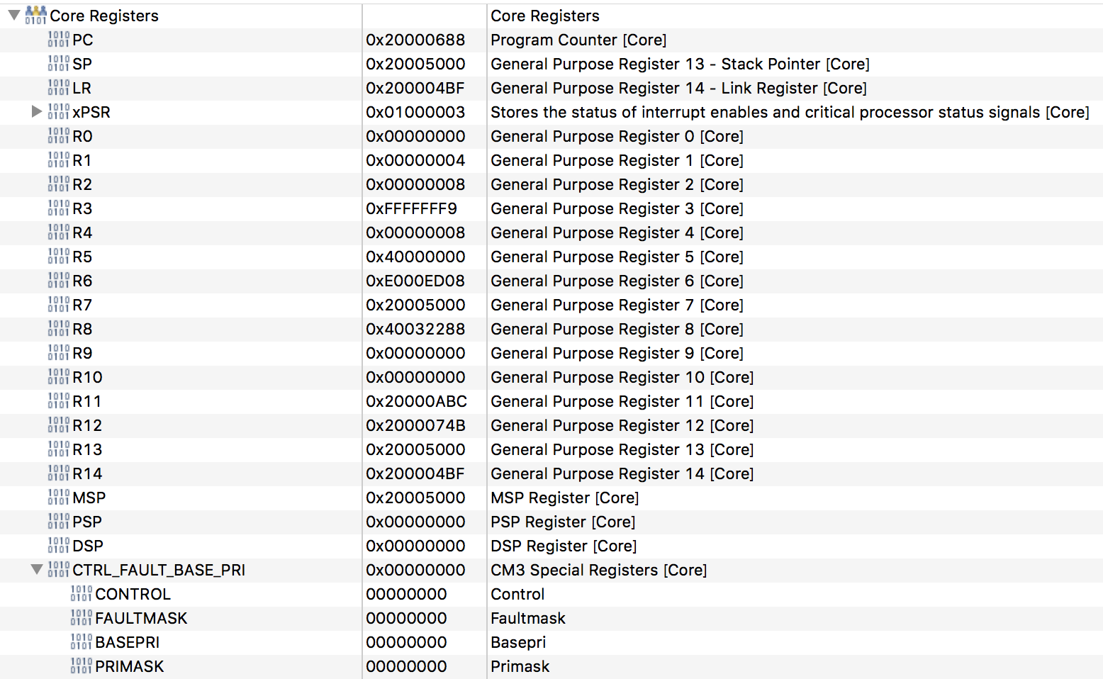

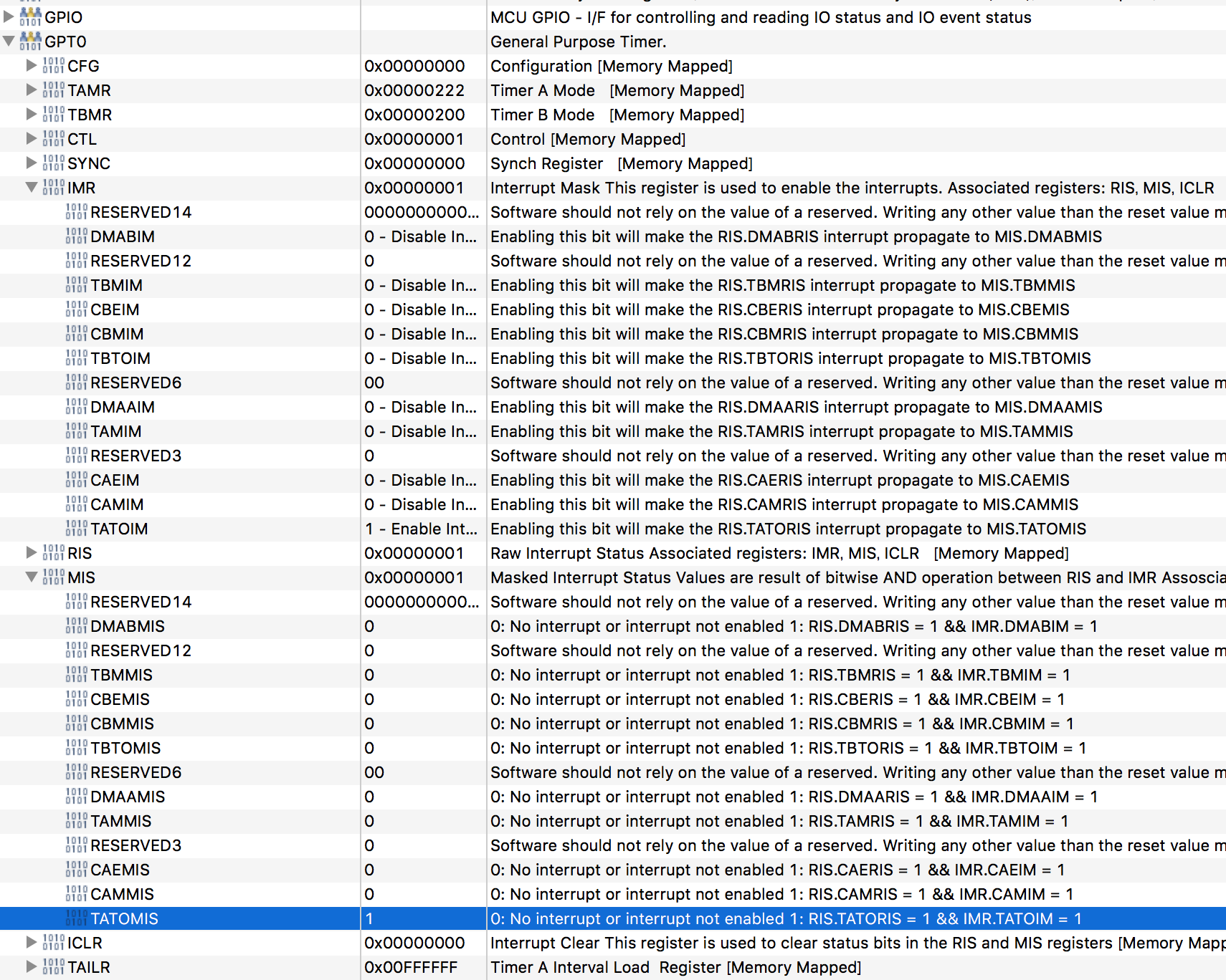

This is going to be a little on the technical side but I can confirm some registers are set properly...
Register 0xE000ED08 (CPU_SCS_VTOR, the vector relocation register) has a correct value of 0x20001000.
If I pause execution I can bring up these registers, which are associated with the timer, which shows that the interrupt is properly enabled (TATOIM = 1), the interrupt has occurred (TATOMIS = 1), however, the function registered with the interrupt is not being called. PRIMASK is 0x00000000 (global interrupt mask disabled).
Everything seems to be setup correctly, but no interrupt occurs.
Suggestions of where to go from here to try to narrow down this issue would be highly appreciated.
