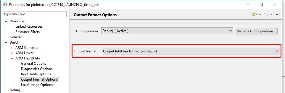

Hi, everybody.
I am using CC1310 launchpad and going to make hex file from CCS7 after building.
I just checked "Enable ARM Hex Utility" from project properties dialog.
As a result, a hex file was made, but it doesn't work properly.
Of course, the program work properly when I flahed it directly to CC1310 through CCS.
How can I get correct hex file from CCS after building?
Best regards.
MF.
  • Hi MF, I too see an issue with the generated hex file compared to the generated out file with default settings.
    For reference I tested with:
    - CCS 7.2.0.00013
    - simplelink_cc13x0_sdk_1_40_00_10
    - pinInterrupt_CC1310_LAUNCHXL_tirtos_ccs (hex and out file)
    - SmartRF Flash Programmer 2 v1.7.5
    - UniFlash 4.2.0.1435
    When testing with CCS6.2 and tirtos this was working out of the box.
    With CCS7/SDK, you have to specify a few things to get the hex file in correct format.

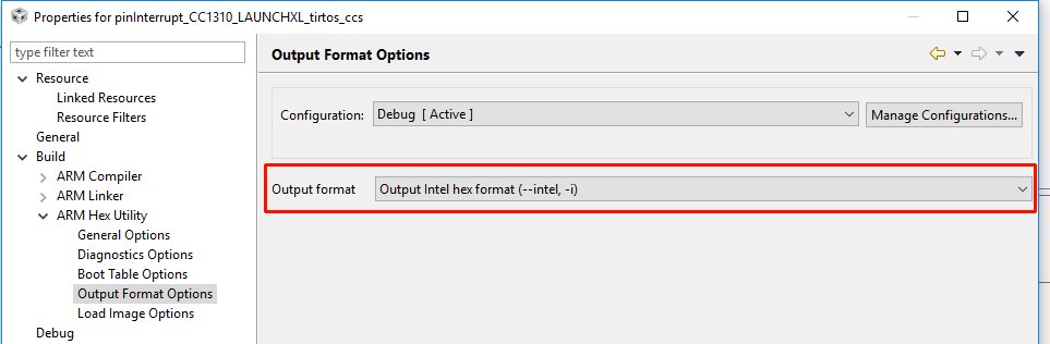

    In the project properties, under ARM Hex Utility -> Output Format Options
    Change the Output format from blank (default) to Output Intel hex format...:

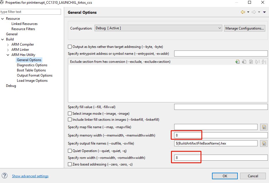

    In the General Options, change specify memory width and specify rom width from blank (default) to 8:
    Why these settings are blank by default now I do not know, I will inquire.
    Try to change the above and see if your hex file works...
  • Thanks.
    It works fine.
