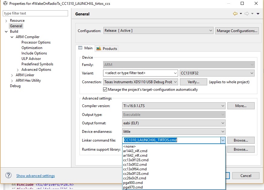

I am trying to compile a project from the CC1310F32. I am using an example project rfWakeOnRadioTx_CC1310_LAUNCHXL and made some modifications to it. The orignal project settings was for the CC1310F128 and it compiled without any problems.
I just made a custom PCB based on the CC1310F32 and I want to compile the project and generate the HEX file to download into the chip. I change the device to CC1310F32 but I don't know whether I need to leave the linker command file as it is or I will have to change it to cc13x0f32.cmd.
Anyone can advise on this?
  • Hello Kian,
    Please change the linker cmd file to match your custom board profile. In this case cc13x0f32.cmd
    Prashanth
  • In addition you have to remove the .cmd file you don't need (selecting a new linker file adds the linker file but doesn't delete the original one.)

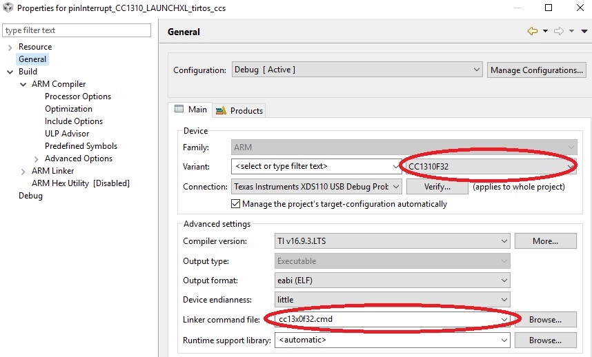

    This is what I have tried so far. I decided to use an unmodified example from Resource Explorer in CCS. I am using  SimpleLink CC13X0 SDK - v:1.40.00.10 with a custom PCB and a CC1310F32RHBT.
    From Resource Explorer, I imported the example Software -> SimpleLink CC13x0 SDK - v:1.40.00.10 -> Examples -> CC1310 LaunchPad -> TI- Drivers -> pinInterrupt -> TI-RTOS -> CSS Compiler。
    Next, on CCS project explorer, I right click on the project folder, go to properties, and changed the device to CC1310F32. I also changed the Linker command file to cc13x0f32.cmd.

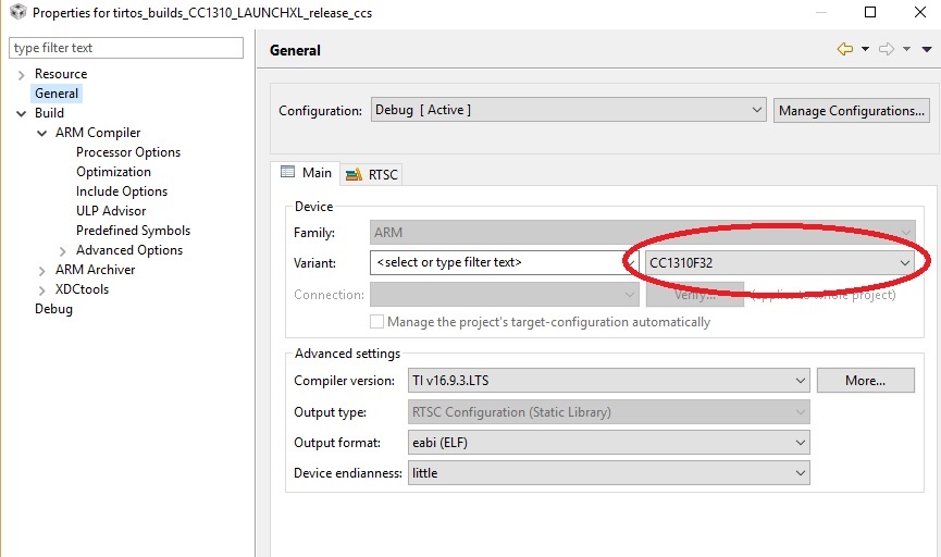

    Next I right click on the tirtos_builds_CC1310_LAUNCHXK_release_ccs folder, select properties, and also changed the device to CC1310F32:

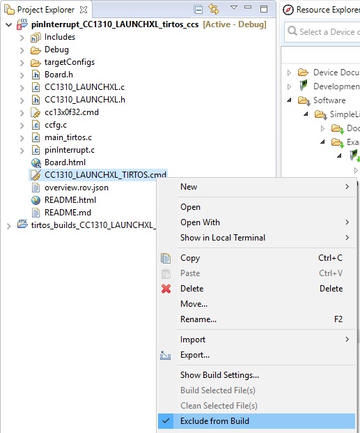

    After that, under Project explorer, I right click on the file CC1310_LAUNCHXL_TIROS.cmd and select "exclude from build".

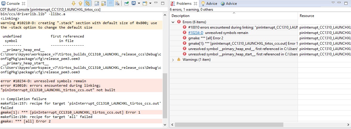

    Next I build the project.
    And I have 6 errors. Can anyone help? Thanks!
