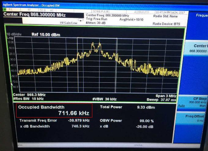

The Occupled Bandwidth is 711.66KHz, while the testing mechanism requires less than 300kHZ. Which parameter should I tune on the software, DEVIATN or data rate? Is it bigger or smaller?
Data rate:48.0042kBaud
Deviation:5.157471KHz
Base Frequency:868.299866MHz
Carrier Frequency:868.299866MHz
Xtal Frequency:26MHz
Modulation Format:2-FSK
RX Fiter Bw:58.035714KHz
Channel Spacing:199.951172KHz
Signal BW of = Data rate + 2 x frequency deviation
58.319142=48.0042 + 2*5.157471 Is there any error in this formula?
Thanks!
https://e2e.ti.com/cfs-file/__key/communityserver-discussions-components-files/156/48k.WMF
No, here is the spectrum when I measured with the parameters you gave.
Note that setting the deviation very low compared to the datarate will give poor performance on the RX side.
