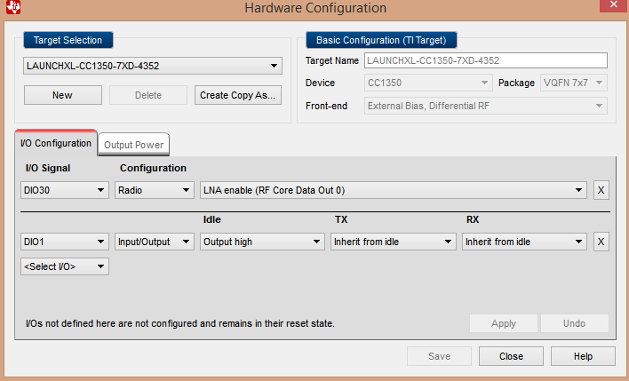

To do that I saw that in SmartRF studio I can go to "Configure Target..." and set that up. So i did.

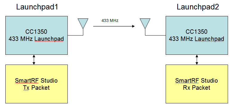

I went back to my initial setup of having 2 launchpads communicating with each other. block diagram below of my experiment:
For the launchpad running Tx Packet (Launchpad 1) I setup the following:
For the launchpad running Rx Packet (launchpad 2) I setup the following:
If I understand this correctly when i press Start and run Packet Tx and Packet Rx on 2 different launchpads I should see some sort of transition from LOW to HIGH or HIGH to LOW on DIO30 when the PA is active on Launchpad1 and when the LNA is active on Lauchpad 2.
To observe that I connected an oscilloscope and had ch1 observe launchpad1 DIO30 and had ch2 observe launchpad2 DIO30. I got no transitions at all, it was constantly at logic '0', i couldnt see the control signals for the external PA and LNA toggled on either launchpads on DIO30. The system is working, the data is going through, plz see below (RSSI is high because the boards are 20 cm apart):
Could you please help me with this? What am i doing wrong here? Why cant i see any control signals for the external PA and LNAs on DIO30 on either launchpad? Thanks.

    Yes, you are correct. You can configure the DIOs for controlling external LNA/PA operation.
    We used the following DIOs in CC1310+CC1190 Launchpad ( LAUNCHXL-CC1310-CC1190). Design files are available on our website. You can use the same DIOs for your control signals, so that you can use our tools without any changes.
    DIO30 for PA Enable
    DIO29 for LNA Enable
    DIO28 for HGM ( High Gain mode) - If you don't need this line, you can ignore it.
    Did you press Apply Button? If you don't press then it won't apply the settings.
    I tested those controls (DIO30) are I observed transitions.
    Please try again.
    You can test DIO settings ( High and Low levels) by selecting the Configuration as Input/output and set to appropriate states. But don't forget to Click on Apply Button.

    Ive definately pressed the Apply button in Configure Target window.
    1. Are you saying my Configure Target options should be set to Input/Output instead of Radio?
    2.Can you please explain a bit more the difference between Radio and Input/Output configuration?
    3. Do you have a link to the LAUNCHXL-CC1310-CC1190? Cant seem to find it.
    Stevan
  • On the LAUNCHXL-cc1350-4 DIO1 and DIO30 are used to control the RF switch so you should select different IO(s) to control an external switch/ PA.
    You have to select "radio" as you have done to get the system to automatically control the PA/ LNA.
    The reference design for LAUNCHXL-CC1310-CC1190 is here: www.ti.com/.../swrc338
  • Hi TER,
    OK, Ive got this working now. Thank you to the both of you.
