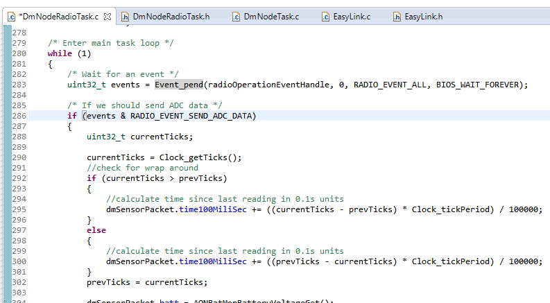

    B. So, do I just have to find and use the right Easylink functions in each XXXRadioTaskFunction? I actually just need the concentrator to be able to send a message that would change the reporting interval of the nodes. Let me tell you what I tried unsuccessfully until now.
    I thought of using the acknowledgment packet "format" from the concentrator side to send that message, but I don't  really know how the Event_pend function works...
    On the Node side, I tried to do the following:
    1) create different report intervals (5s, 10s, 20s, 30s, 60s) that I will put into a "mode" variable.
    2) create a new event called "RADIO_EVENT_ASK_MODE" for when the Node gets to be asked to change the mode (=report interval) by the concentrator
    3) change the mode when that event occurs
    But I still don't know how the Event_pend function works, if I wanted to have that new event...
    So if you have any suggestion, using what I tried or not, I'll be happy with it.

  • Well, I get it now, I actually need to check the rxDoneCallback function in the DmNodeRadioTask C file.
    I'll let you know if it works or not.
