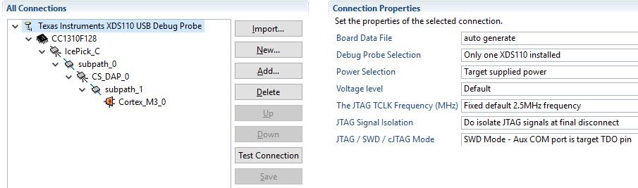

  • Mad River said:
    Now, our own board is ready and we are trying to connect and download firmware to it using SWD.
    As far as I am aware the CC1310 doesn't support SWD mode.
    When I tried setting an XDS110 to use "SWD Mode - Aux COM port is target TDO pin" with a CC1310F128 the test connection fails with the same SC_ERR_SWD_PROTOCOL error as your are getting.
    Does the following work for you?

  • Mad River said:
    I was able to download my program after trying your suggestion.
    But now I am getting the following error when trying to connect again:
    From a quick search think the downloaded program may have locked the debug interface, leading to the SC_ERR_ROUTER_ACCESS_SUBPATH error.
    The last post in https://e2e.ti.com/support/wireless_connectivity/bluetooth_low_energy/f/538/t/463274 suggests disabling "custom configuration" in the target configuration file and you should be able to launch the target connection file and use Scripts > CC13x0_CC26x0 > MassErase to wipe the chip flash, and unlock the debug interface.
