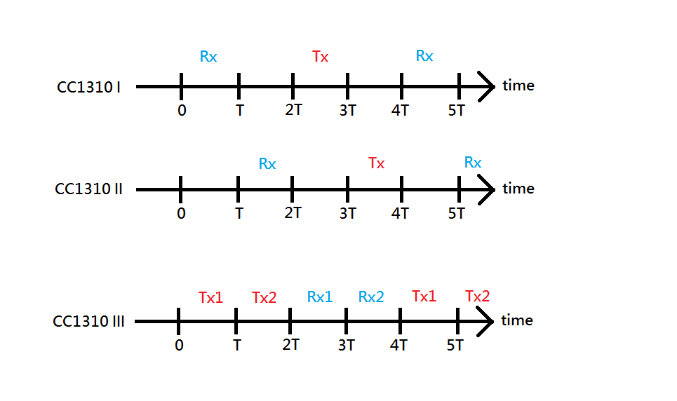

CCS/CC1310: Utilizing CCS to Operate Time-Division Multiplexing
Part Number: CC1310
I would like to operate time-division multiplexing by using CC1310s and Code Composer Studio (CCS). Here is my diagram to illustrate each CC1310’s time slot (2-to-1). Initially, CC1310 III transmits its data to CC1310 I and CC1310 II sequentially (The packets of Tx1 and Tx2 are not identical). Then, CC1310 I and CC1310 II transmit their own data to CC1310 III, and CC1310 III receives their data in order.
By combining rfPacketRx.c and rfPacketTx.c in CCS, I successfully operate a 1-to-1 system (The time slots are shown below). The attached file is the code of CC1310 II (The other code is slightly different from this for CC1310 I).
However, I am stuck over modifying my code to realize time-division multiplexing which is mentioned at first. Therefore, I feel like requesting the solution. Thanks!

/***** Includes *****/

    thank you for sharing your example. Do not access the RF driver from different tasks. I suggest to implement your communication protocol in a single task. Use a state machine to achieve a simple and robust structure.
    You may have a look at the synchronized packet examples which, I guess, is closer to what you want to achieve.
  • Hi Richard,
    At first, thanks for sparing time for answering my question. However, after referring to the code you mentioned above, I am confused about that how could I modify the data I would like to transmit in "rfSynchronizedPacketTx.c". Thank you!
    one way would be, to extend the BeaconPacket struct in rfSynchronizedPacket.h.
    If you understand, how absolute timing of commands works, then you could also think about using the EasyLink API instead of raw commands. EasyLink allows also absolute timing for TX/RX operations.
