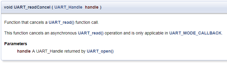

    UART_readCancel() should cancel the current read command (UART_read() ). But it still does not enter standby.
    I think the question is as simple as:
    How do I make the UART enter standby, when RX is waiting for a en RX byte?
    Copy from TI doc, which tells that I should call the UART_readCancel() to enter standby when using CALLBACK mode.
    But it does not work:
    General timeout
    A timeout value can only be specified for reads and writes in UART_MODE_BLOCKING. If a timeout occurs during a read when in UART_MODE_BLOCKING, the number of bytes received will be returned and the UART_Object.status will be set to UART_TIMED_OUT. After a read timeout, RX will remain on, but device is allowed to enter standby. For more details see Power Management chapter below.
    In UART_MODE_CALLBACK there is no timeout and the application must call UART_readCancel() or UART_writeCancel() to abort the operation.
    Note
    A new read or write will reset the UART_Object.status to UART_OK. Caution must be taken when doing parallell reads and writes.

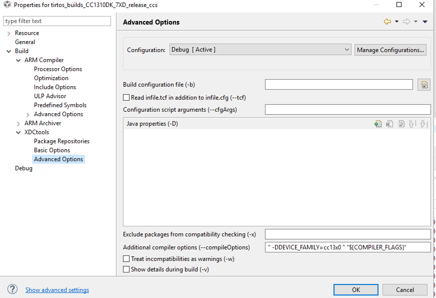

    In the doc for updating SDK version, it says:
    If you are upgrading from a version of the SDK 1.40 or older to a version greater than 1.40 you will also need to add ${COMPILER_FLAGS} to the advanced settings for the XDC Tools.
    It is not 100% clear to me where I shoudl insert the "${COMPILER_FLAGS}.
    It just says inthe "Advanced settings".
    There is a section called "Advanced options". Is this the place? And where should I insert it?
    Or is it in the "Package Repositories" section?

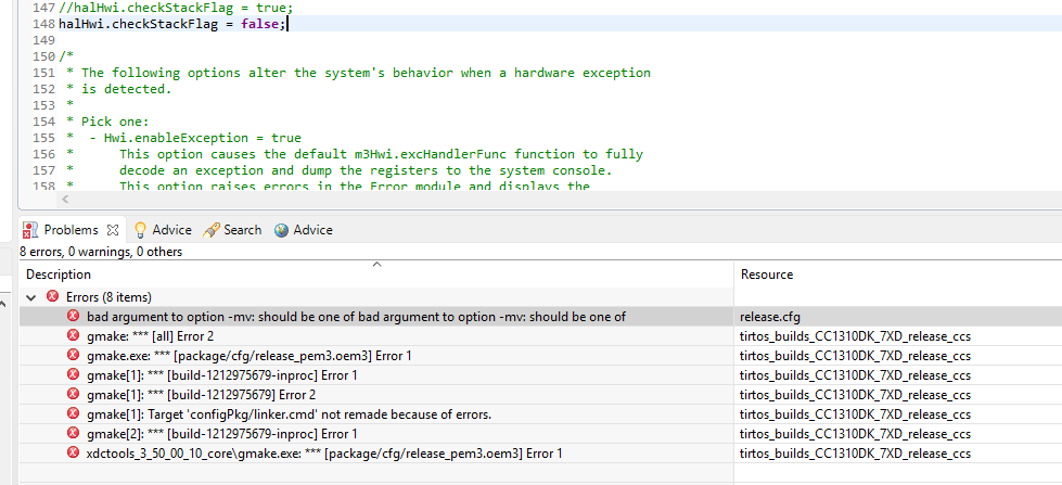

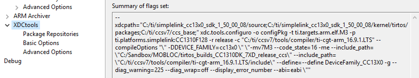

  • I get this error after installing new SDK / XDC tools, and made a Clean and Rebuild:
    I can't google a usable answer... Can you help with this?
    I also tried installing the newest CCS V7.3, but with same result.
    gmake[2]: *** [build-1212975679-inproc] Error 1
    gmake[1]: *** No rule to make target 'build-1212975679', needed by 'configPkg/linker.cmd'.
    gmake[1]: Target 'configPkg/linker.cmd' not remade because of errors.
    gmake: *** [all] Error 2
    I placed the "${COMPILER_FLAGS} in the "Package repositories":
  • Try adding the compiler flags under the "Additional compiler options" under XDCtools->Advanced Options and see if that solves your problem.
  • OK, it removed the error, but added 18 new... I always fear when updating to newer versions...
    First, it claims that device family is not set. The rest of the errors may be caused by this.
    I have copied screenshots of the error description and how ${COMPILER_FLAGS} is inserted.
  • If you have not already, add "DeviceFamily_CC13X0" to your predefined symbols under "ARM Compiler->Predefined symbols", that should take care of the device family error.
    If this does not solve all the errors, can you post screenshots of the XDCtools, ARM compiler and ARM linker flag summary?
  • I added the device family, and then 17 errors :)
    Screenshots attached. But the linker flags is not present (see screenshot). I can find it in the application projects, but not in the "tirtos_builds-...." project.
  • The "--define=--define DeviceFamily_CC13X0" strikes me as odd. I would expect it to be simply --define=DeviceFamily_CC13X0.
    Can you try edit the flags so that the compiler flags are "--define=DeviceFamily_CC13X0"?
    Also, for the XDCtools flag, change "-DDEVICE_FAMILY=cc13x0" to "-DDeviceFamily_CC13X0".

  •  Ah, Compiler define was inserted wrong. My bad. CCS is not my daily tool...
    Still errors, though. but not so many.
    Changed the XDCtools flag as you told, but no change.

    I think TI should write in the documentation, that readCancel() forces a callback call, and maybe make a better UART example. The UART examples are really simple.
    I can now move on to finalize my application :)
    Kaare
  • Glad that you were able to get it to work!
    As far as I can see, the documentation actually specifies that the readCancel will call the callback no matter what.
    "This function cancels an asynchronous UART_read() operation and is only applicable in UART_MODE_CALLBACKUART_readCancel() calls the registered RX callback function no matter how many bytes were received. It is the application's responsibility to check the count argument in the callback function and handle cases where only a subset of the bytes were received."
    Is this full text not present in your documentation? In that case, where di you find the documentation?

  • I copied the explanation out of the SDK documentation. Typically, I would recommend you look there for documentation.
    You can find this in the SDK folder under "docs/Documentation_Overview.html" and navigate to TI-Drivers (or what ever else you might need to look into). There is often two levels to the drivers, UART for example has an UART.h and CC26XXUART.h level. The first is the top level skeleton, while the second one is the actual device specific implementation (in this case, CC13XX and CC26XX uses the same driver).
    I recommend to look in to both headers when you are looking for a feature. There are some cases where some of the top-level functions are not supported bu the device specific driver. Also, the device specific header can contain some information on device specific behavior that is not mentioned in the top-level.
