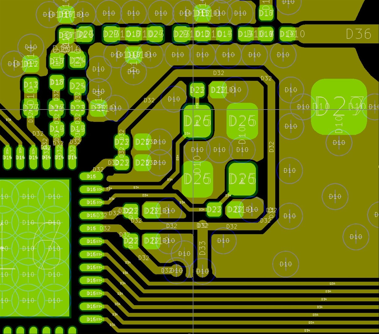

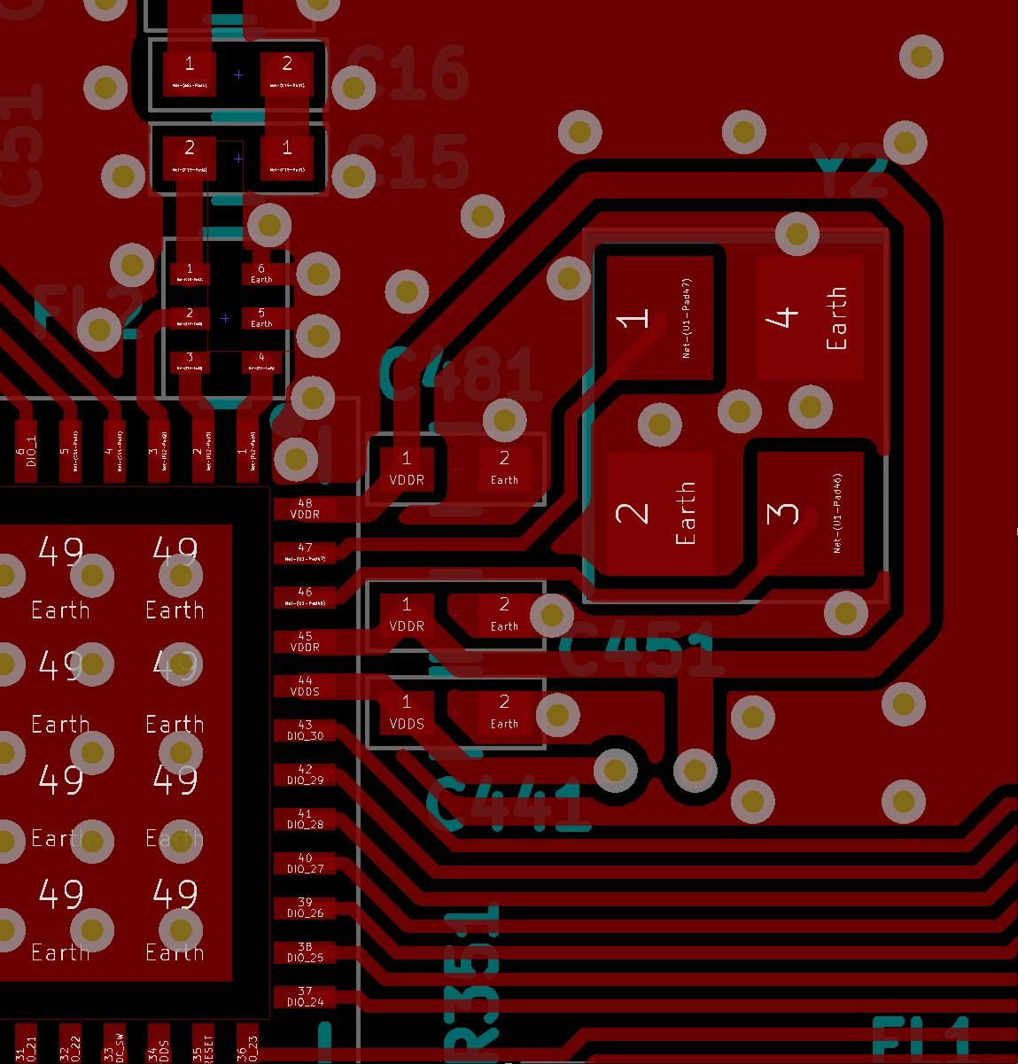

  • I have followed the reference design as close as I could, so I didn't mount external load caps. I did use same Epson Crystal and I read and followed the recommendations from the Crystal Oscillator and Crystal Selection for the CC26xx and CC13xx Family of Wireless MCUs document (SWRA495A–December 2015–Revised December 2015).
    My custom PCB design in this area is nearly the same but, of course, there are minimal differences (not included the PADs for DNM capacitors, for example). I have attached custom and reference design of the crystal area so you can compare. There is a solid ground plane under this area in my design.
    Can they affect enough to modify the loading capacitance on the Crystal? If not, and as I don't use external load caps, what other factors can affect?
    On the other side, how adjusting the internal loading capacitance through programming affects the final frequency? Increasing CL increase the frequency? Vice versa? I didn't find an equation in your link or in the document I mention before that shows the relation. No other way other than trying and seeing the effects?
    I think changing CL is a smarter way to solve the problem than setting a not real frequency in the code to get the expected frequency.
    Crystal area in custom design:
    Crystal area in reference design:

  • I still don't understand why you get the offset since your layout looks good (btw, do you have the same stack-up as in the ref design?) but as long as you know the offset you can adjust for it with modifying the cap array.
  • My stack-up is the same as the reference design: 2 layers of 0.035mm of copper in a 0.73mm FR-4 dielectric.
