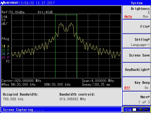

    I have downloaded the latest version of SmartRF Studio 2.8.0 and performed a couple of modulation tests like you have done and here are my results.
    Sorry about the image, but its taken with a phone.
    • White trace is 500kbps, 250kHz deviation, 2FSK using RBW/VBW of 30kHz.
    • Blue trace is 500kbps, 125kHz deviation, 2FSK using RBW/VBW of 30kHz.
      I see modulation width very close to what I would expect and not exactly what you are seeing.

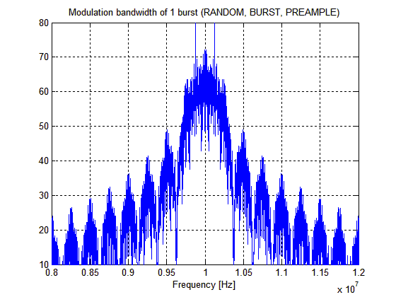

    Here is my matlab simulation for both
    • This one compares with the white trace is 500kbps, 250kHz deviation, 2FSK using RBW/VBW of 30kHz.
    • This one compares with the blue trace is 500kbps, 125kHz deviation, 2FSK using RBW/VBW of 30kHz
    I think you might be using an earlier version of SmartRF Studio and it might have a bug, can you please upgrade to the new version that was released on December 20th, 2017. (version 2.8.0)
