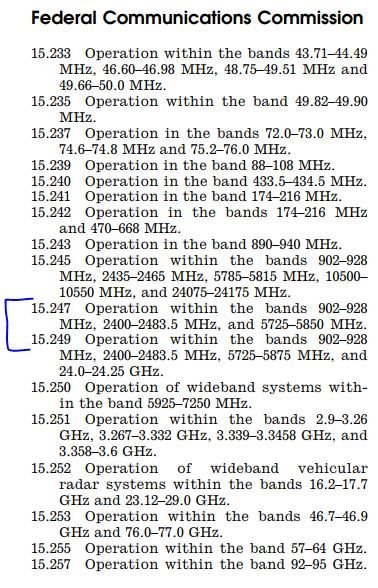

     Does  CC1125 support frequency hopping for FCC15.246 ?
Thank you!
  • Eggsy,
    I think you mean FCC15.247 and not 246. There is no 246 in the list below:
    But if you do mean 15.247, then yes, it is possible to create a solution based on the CC112x series of devices that becomes compliant with the frequency hopping set of regulations.
    Here is an appnote that describes a possible solution.
    When doing this, the software is what is important. The transceiver just executes the commands of the MCU and if done right the overall system will become compliant.
