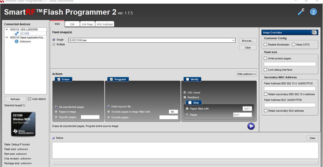

In the process of using CC1310, some CC1310 is locked, and is locked during the operation of the program, there is no operation CCFG, and was locked into a CC1350, may I ask how so?
can you still do a forced mass erase? Click on the tool button on the top right corner and select "CC26xx/CC13xx Forced Mass Erase". If that doesn't worked, you have locked your device completely up and there is no way to recover.
