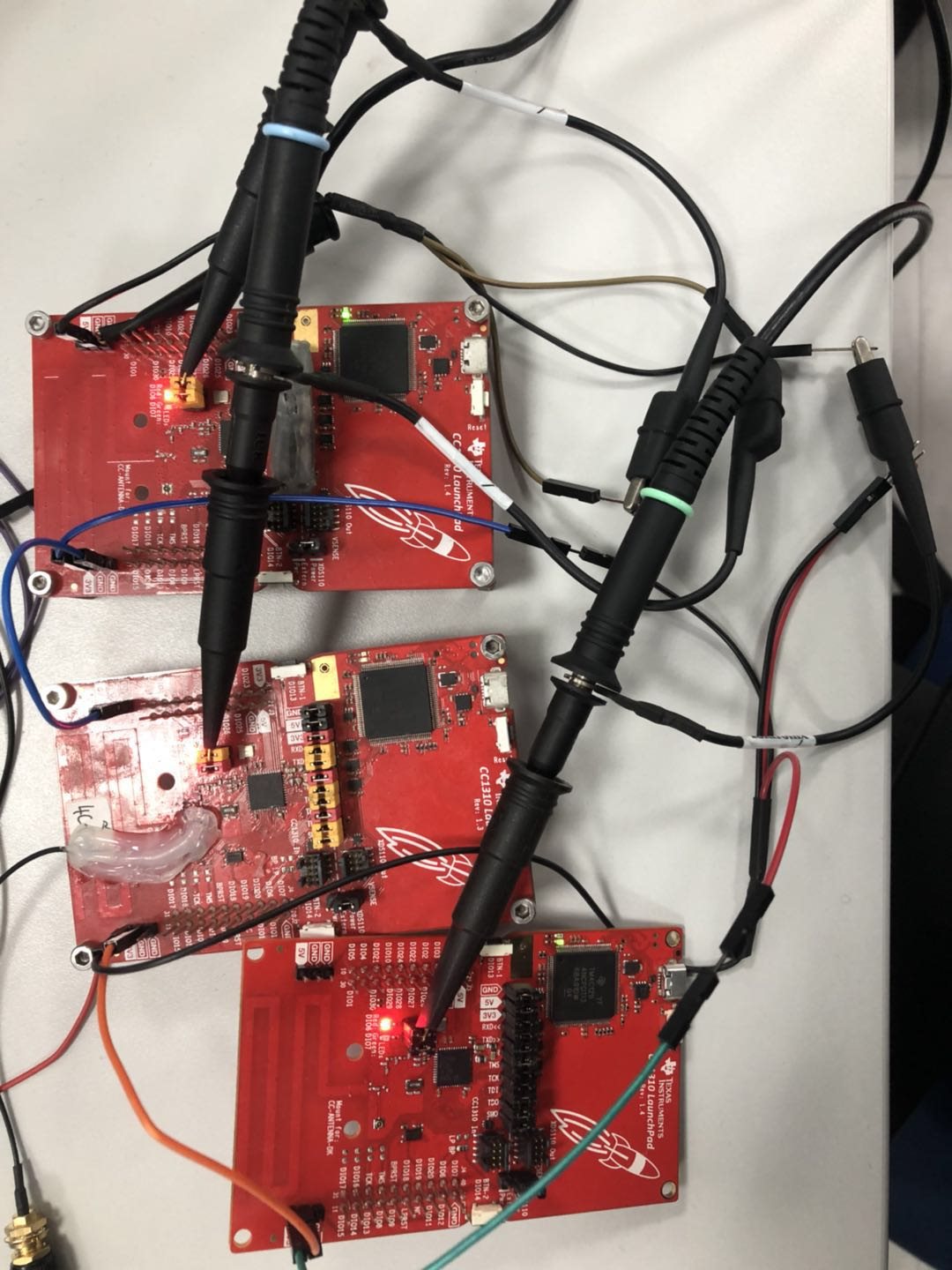

       Customers feedback a problem. There were 4 CC1310 Launchpad.
        One CC1310LP is as TX device, running the demo rfPacketTx_nortos; while another three CC1310LP all are as RX device, running the demo rfPacketRx_nortos.
          CC1310 TX device sent a packet in the air.  Why does three Rx devices not receive this packet at the same time? And sometimes it delay a lot.
We do a test, when Rx device receive the packet from Tx device, Rx device code will go into the callback function. In the callback function, we make a pin output from high to low level.

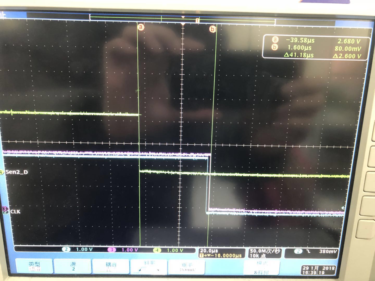

Let's see below Waveform. Do you have any suggestions? Thank you!
  • Is it always the same device that reads first? Or do they change order?
    The sleep function that the radio calls causes interrupts to be accurate only down to 10uS.  I think your receivers clocks are probably out of sync enough to cause the buffered receive interrupt to raise at different times.
    Can you try monitoring your LNA active pin instead of turning an LED on after the hook?
    PINCC26XX_setMux(PinHandle, PinWhateverPinYouWant, PINCC26XX_MUX_RFC_GPO0); // Route out LNA active pin
    a small difference of +-1/4 symbol rate is expected. But 40µs is indeed huge. I think the root cause is that something preempts the software interrupt (SWI) which is responsible for the callback. Possible that the clock subsystem is running a SWI as well. In the No-RTOS kernel implementation, there is not much you can do because SWI scheduling is non-preemptive. In TI-RTOS, SWIs are implemented preemptive and you can increase the RF driver's HWI and SWI priority above the Clock system.

    Whether TIRTOS or NORTOS, the problem still appear. Do you have another way to deal with this problem on NORTOS? Sync way is complex. Thanks!
  • Hi Chris,
    they change order!
  • When you use this signal:
    Assuming that you configured your RX command to stop after one packet, do you still see 40µs deviation when the signal goes low (packet reception finished)? What PHY mode are you using at which symbol rate?
  • Test the LNA, but can you also show us the code around your RX command? Are you receiving in a loop with a timeout? Are you waiting forever?
  • Hi  All,
            Based on the project of rfPacketRx_CC1310_LAUNCHXL_nortos_ccs,   I call the API what you said,
    PINCC26XX_setMux(ledPinHandle, Board_PIN_LED2, PINCC26XX_MUX_RFC_GPO0); // Route out LNA active pin
    but when it receive the packet, the Board_PIN_LED2(LNA pin) keep high level. Do you know why?

  • The signal is kept high since the example uses repeat mode:
    RF_cmdPropRx.pktConf.bRepeatOk = 1;
    RF_cmdPropRx.pktConf.bRepeatNok = 1;
    To have it to exit RX after a packet is received, you should set repeat mode to 0.
