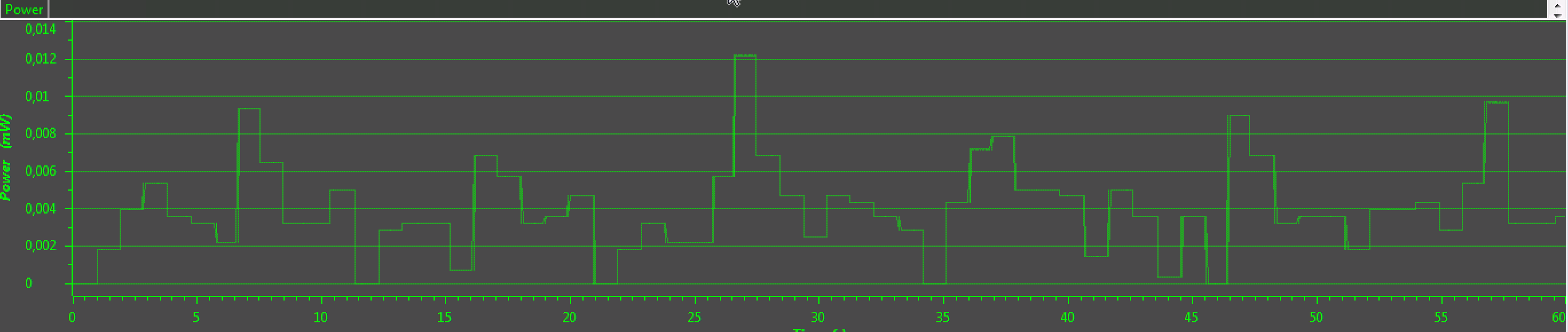

Then Sensor controller is enabled, current consumption rises to 2uA in Standby mode.
I run SC task every second. Even then SC Execution task is empty (zero lines of code) - current rises to 2 uA in Standby mode on cc1310 4x4. On cc1350LP all ok - 1 uA.
Then i run SC task every 10 seconds on cc1310 4x4 - current drops to 1 uA. Without SC (and before first execution of SC task) current - 0.7 uA.
I inserted this code in "pinStandby" example:
scifOsalInit();
scifInit(&scifDriverSetup);
scifStartRtcTicksNow(0x000A0000);
scifStartTasksNbl(BV(SCIF_EMPTY_TASK_ID));
Power log from EnergyTrace for SC task executed every 10 seconds:
My SC empty project: 8637.Empty.scp.zip

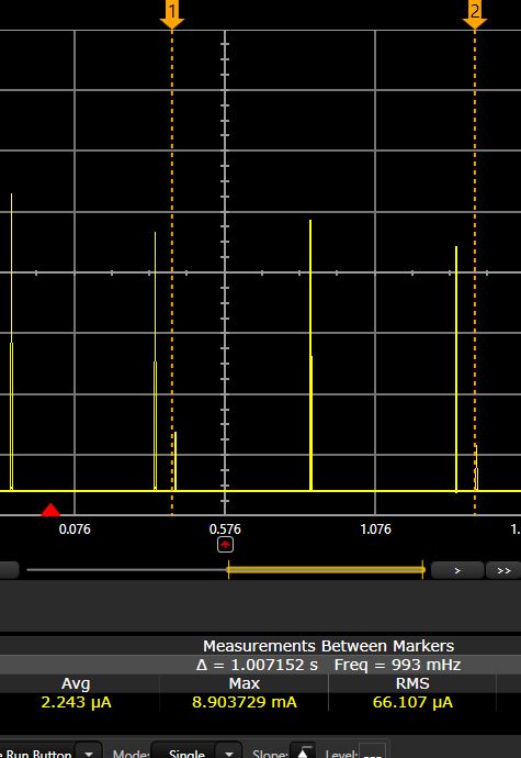

  • Hi, yes I did. I measured 'your' project on a launchpad, it draws 2.2uA (for Vdds = 3.3V):

  • Rustem: Could you point to the exact section in the datasheet that indicate that you should get 0.95 uA when you have a SCE process running?
  • On the first page of datasheet:
    – Sensor Controller, One Wakeup Every Second
    Performing One 12-Bit ADC Sampling: 0.95 μA
  • I have been trying to find out which code that has generated this number. As far as I understand it the CM3 has to be woken up at least 10 times to get the re-charge pulse generation to be optimal. I intended to do some measurements last week but the instrument was busy.
