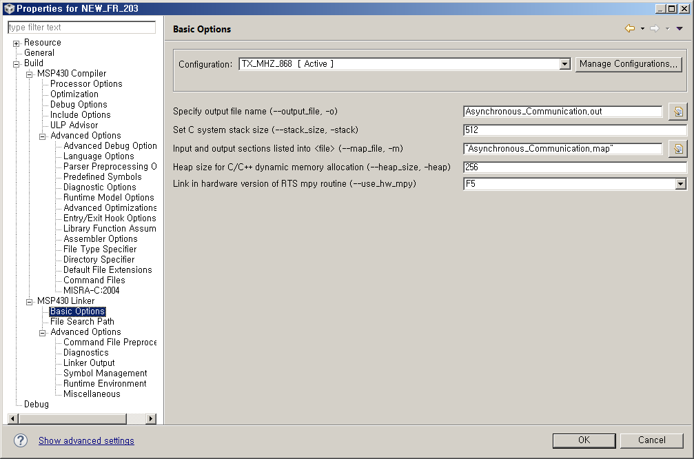

    You may also want to check your CCS project properties to ensure the watchdog timer is held during cinit. In the CCS window, go to Project >> Properties >> Build >> MSP430 Linker >> Basic Options, and make sure that the box next to "Hold watchdog timer during cinit auto-initializtion (--cinit_hold_wdt)" says "on".

    2) I can't find "Hold watchdog timer during cinit auto-initializtion (--cinit_hold_wdt)". Where is it?

  • That is the page where you should be able to find the hold watchdog timer setting. Are you using the most updated version of CCS? If not, what version of CCS are you using?
