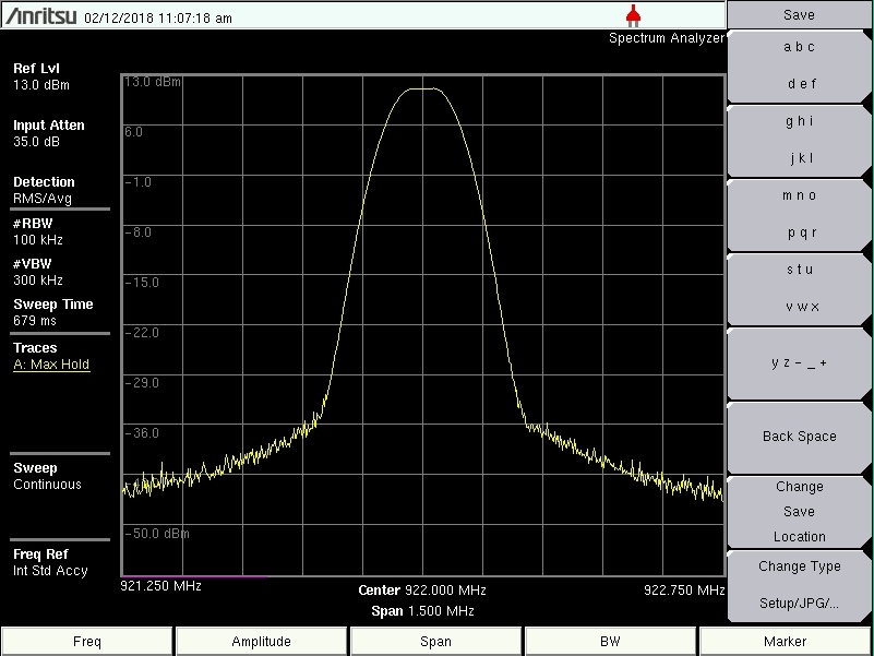

  • Hi TER,
    No as shown in my screen shots I am using RBW=100KHz (VBW=300KHz). If I use RBW=1KHz then peak amplitude will fall and easily will pass the mask but the thing is that peak value will fall as well and wont be 13dBm as shown above. How would I compensate for that.
    Your measurement with CC1200 for -T108 doesn't show the screen shots and the SA RBW and etc.
    -Reza
  • As I read the spec (T-245) the measurement should be done with a modulated signal (not with a CW as you show in the first plot). Then the peak value should not be an issue.
    I would recommend to read T-245 since this describe how to do the measurements required by T-108.
  • Hi TER,
    Sure. I'll read T-245 although haven't been able to find it on the web yet.
    My 2nd and 3rd snapshots are the modulated signals using the CC1120 random data and register contents are used from SmartRF Studio.
    Since I am showing the SA screenshot in peak save mode it's very smooth but if I put it in normal live mode I can see the frequency deviations on carrier signal.
    Q) Do you mean if I modulate the 2GFSK as in snapshot 2 and 3 and set the RBW=1KHz (VBW=3KHz) I still will get Pout(max) = 13dB?
    I tried this but what saw was that the whole spectrum amplitude dropped.
    As another note STMicro has an appnote about -T108 (AN4953) on page 10/34 under 3.1 they have described RBW=1KHz, VBW=1KHz for ACP measurement, but they have mentioned "In this case and settings measurement limits are adjusted downwards by 10xlog(100KHz/1KHz)=20dB"
    This is what I saw in my measurement this correction factor that I am not sure how to consider it in my measurement to make sure I am doing it correctly.
    Appreciate your Very helpful comments!
    -Reza
  • As you may have noticed T-245 is very precise on how you should do a measurement. My version is a version translated by TI Japan so I would assume that the page numbers etc could be different from your version. But if you look at "Conditions of equipment" under "Adjacent channel leakage power" it's clearly stated which RBW and VBW to use. The next "Condition of Test equipment " state that the signal shall be modulated.
    The output power doesn't change as a function of RBW. If you look at "OperationProcedure of Measurement Operation" the power is the integral of all datapoints within the unit channel. Here, I used the ACP functionality of the spectrum for the measurements and set the channel equal to the unit channel. In addition, output power is measured differently and has a separate section in T-245.
    It looks like the app note you refer to haven't done the measurement according to T-245. Again, the standard is very clear on how this should be measured.

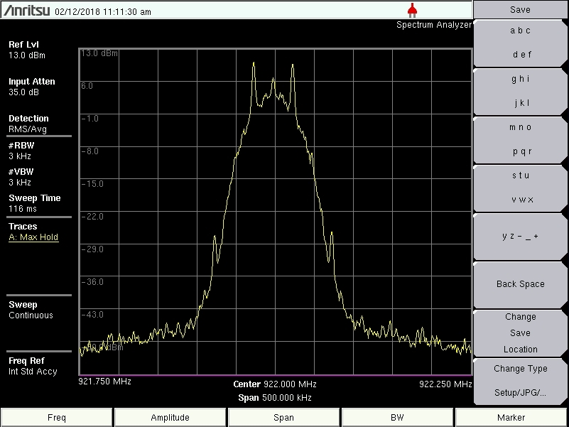

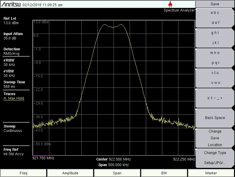

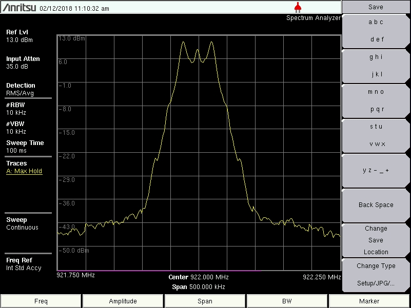

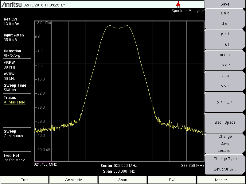

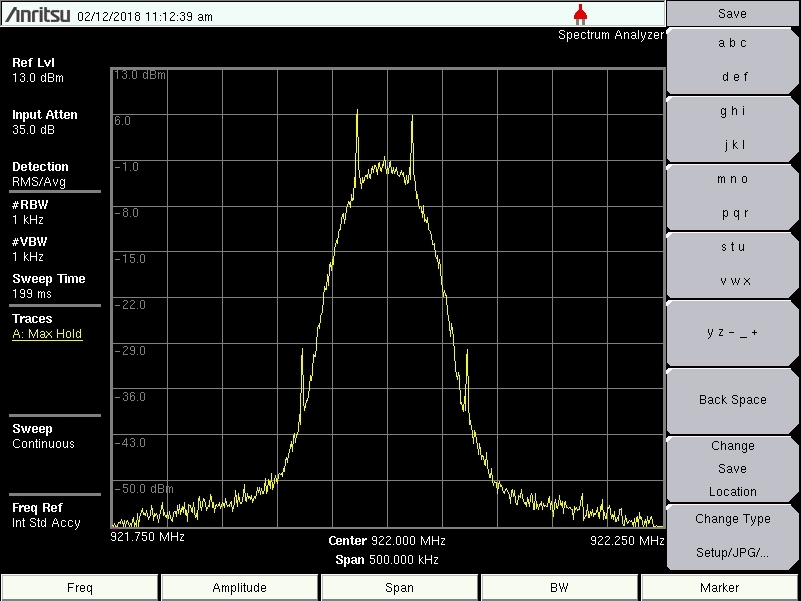

  •      Hi TER,
    Thank you for the reply.
    I ordered TI CC1120 EM/Smart tRF TrxEB and tested my PCA side by side with TI using the same setup on my SA. I can reproduce the same exact snapshots on SA and like what I said before to check the ACP resuls when I set the RBW to 1KHz signal amplitudes change.
    Here are the settings
    f=922MHz, 2GMSK, 50kbps (50ksps), deviation=25.024414 KHz, Random Data, Continuous mode, P(out)=13dBm
    Your measurements on SWRA445-March 2014 under 3.3.2 Table 14 numbers are your ACP measurements that I cannot reproduce your numbers by using different RBW settings.
    Please advise how could I reproduce your readings or say how could I make sure that I am passing the T108 based on T245.
    I've attached the snapshots for (modulated with random data at different RBW's) which are the same for TI and my PCA.
    -Reza
  • The numbers in the app note is measured with a built in ACP function in the SA. If your SA doesn't have this functionality you have to measure ACP as described in T-245.
    Not sure what the plots are supposed to show, could you elaborate a bit since the plots are not showing ACP as far as I can see.
  • Thanks TER.
    If you look at one of the snapshots I sent you on this thread last week, I had the SA at RBW=100KHz and also drew the ACP mask on it showing that it cannot pass the the ARIB-T108 ACP requirement.
    You replied that RBW should be set to 1KHz. My reply back was if I set the RBW=1KHz then amplitude of the signal will drop and it will pass the ACP but the peak value of the signal also drops. You didn't agreed on amplitude drop. My recent snapshots show what I mentioned before.
    But it sounds like you have measured using ACP function of the SA.
    I don't have access to TELEC-T245 but based on what you said I thought, I need to use RBW=1KHz but was concerned about amplitude drop in my measurements.
    -Reza
  • I'm not sure why you are worried about what looks like a amplitude drop. This clause measure ACP, not output power. If you measure ACP as described you will see the energy in the channel (output power) is close to 13 dBm. It's not relevant to look at the peaks when measuring with a low RBW.
    When measuring according to a standard it's important to follow how to measure to the letter.
