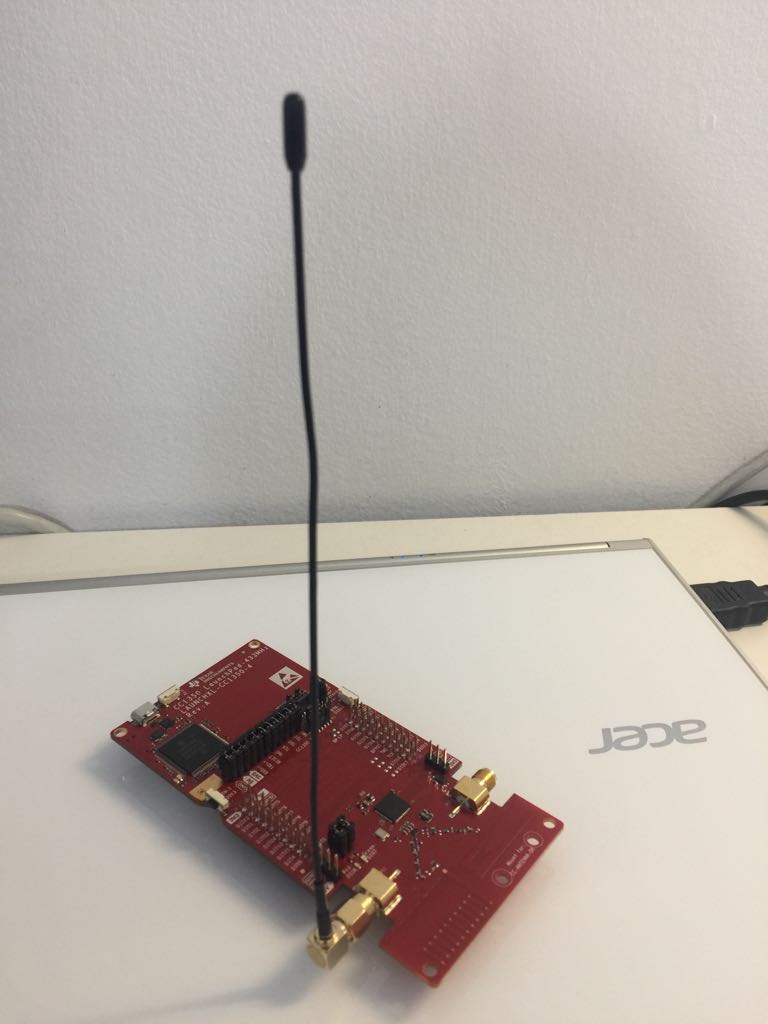

We are having a work project that includes copying a 433-MHz parking remote control signal  (a very basic one that transmits each time the same O.O.K signal).
what we have already done:
  • install CCS and download projects from SDK.
  • we know that the remote control emits each time the same OOK signal to copy at 433-Mhz.
  • we have the CC1350+ USB and we added an antenna to extend its reach.

    Thanks for your help.
    We have a 433.900-Mhz remote.
    We want to get the signal to the launchpad somewhere ( register / struct) and print it - or any other way.
