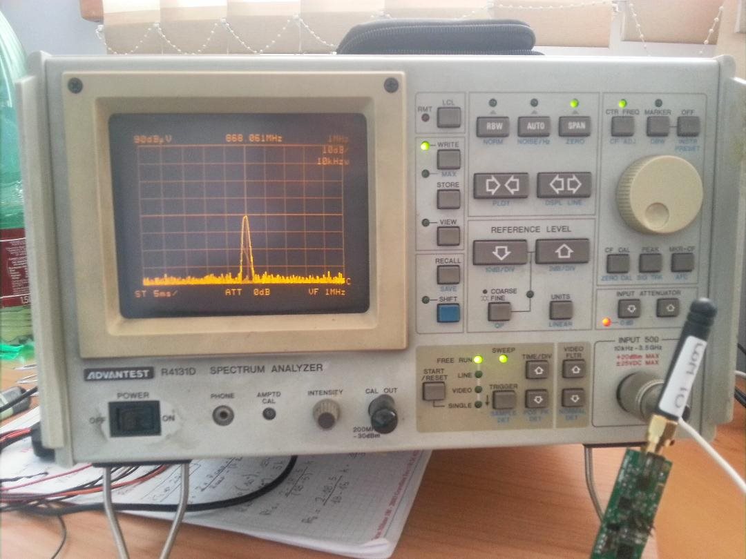

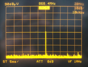

  • Do you have a signal generator? Just set this to send a carrier wave (tone) on the frequency you are interested in and connect this to the 50 ohm SMA input on your board. Apply (as an example) -50 dBm and read out the RSSI. If you have set the RSSI offset according to SmartRF Studio you should read out close to -50 dBm from the RSSI register. Set the chip in cont. RX.
  • I have Spectrum Analizer.
    Which kind of measure I can do with it?
  • For the suggested test you need a signal source with a known signal power. The ideal for this would be a signal generator to do this. As an alternative you can use a CC1101 as TX and use a cable and attenuators to connect this to the DUT. This method is not as accurate since my experience is that it's difficult to know the exact power level.
    A spectrum analyzer is not too useful for this.

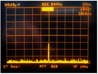

    Another device transmit on 868MHz:
    My code return alway 228 also when I remove the above transmitter. Why??

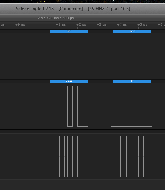

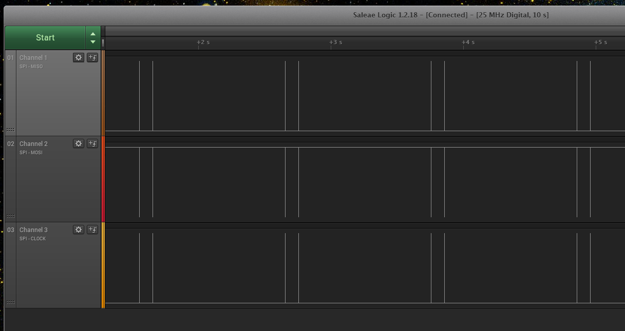

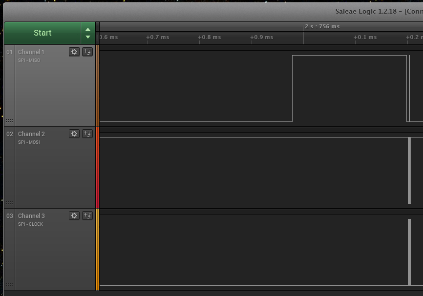

  • Could you post a plot showing the SPI lines when:
    - You read the RSSI
    - When you try to put the device in power down
  • You can also output one of the CLK_XOSC/n signals on the GDO pins and hence monitor if the crystal stops when trying to put the device in SLEEP.

  • I have measured crystal on XOSC_Q1 pin and it still oscillate. Voltage on DCOUP is 1.77V.
    Indeed I always see signal on Spectrum Analizer.

    In a while I try do record SPI SIGNAL

    PANORAMIC: xome_cc1101.power_Down() and xome_cc1101.Power_Level_on_Channel()
    ZOOM POWER DOWN
    PANORAMIC SLEEP:
    ZOOM SLEEP:
  • I have notified someone to look at the SPI plots.

  • - The SPI plots looks OK given that the CSn signal is correct.
    - To check that your SPI reads work: Could you try to read the value from the VERSION register.
    - Could you check that you comply with 19.1 in the datasheet?

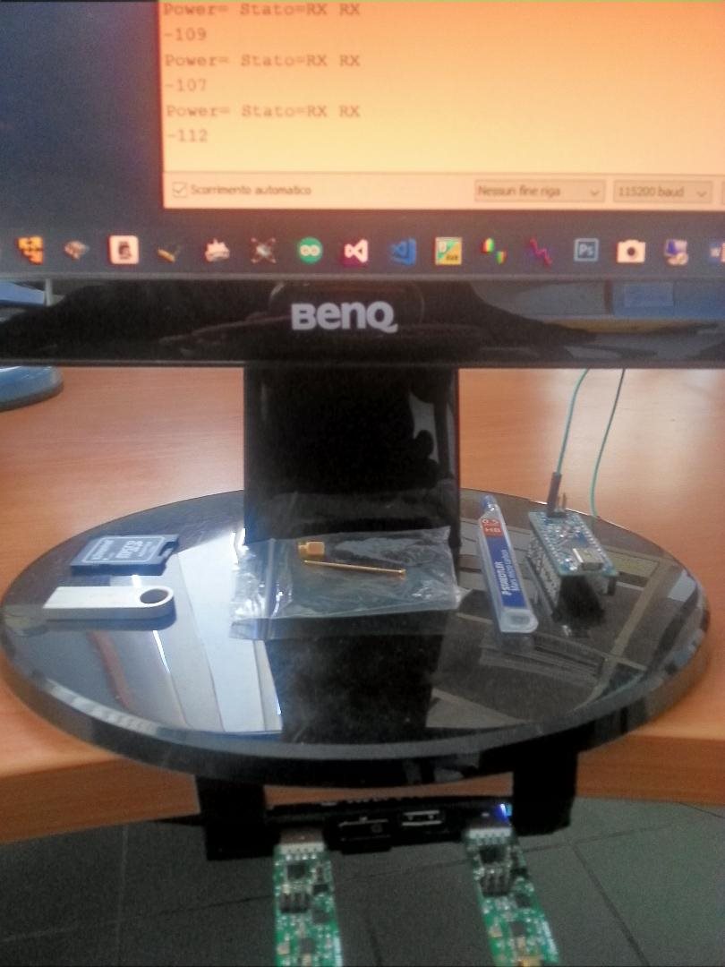

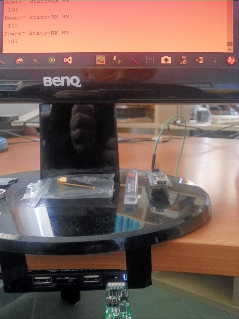

    The last 2 command to validate are always RSSI and CCA mode:
    Why Transmitter send packet every 2 second but channel is always busy?
    Are RSSI value plausible?
    void loop()
    if (xome_cc1101.is_Channel_Clear())
          Serial.println("CH FREE");
          Serial.print("Power= ");Serial.println(xome_cc1101.Power_Level_on_Channel());
    else
          Serial.println("CH DUTY");
    delay(200);

    this is signal take ad 60cm distance:
    Transmitter and Receive are at 5cm of distance

      The problem is that if I put TX antenna very close to RX antenna, value don't change!
      The same TX antenna near spectrum analizer antenna show strong signal

  • Hi TER
    The two device RX and TX are the same. this is value raw of RSSI:
    State=RX RX
    rssi_dec= 176
    rssi in dBm= -114
    This is the TX only:
    this is RX without TX:
    This is TX close to RX
    Also moving TX little bit more far NOTHING CHANGE
    Please reply me asap. with solution. Thanks
