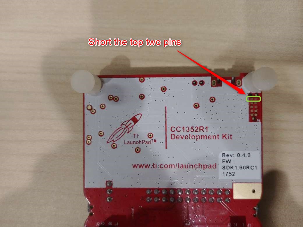

    I just did a test here with an ancient firmware on Linux so I could purposely brick my CC1352 launchpad.
    In my case even Windows was unable to recognize the CC1352 board plugged into USB - if that is happening to you, then check the document shown in section 7.1 of the XDS110 page below:
    http://processors.wiki.ti.com/index.php/XDS110
    The simplest procedure to bring the debug TM4C device back to DFU mode (and thus to allow updating the firmware on a Windows host) is to ground the JTAG TDO pin of the debug device (not the one in the header) and plug the USB cable.
    After doing that, you can follow the procedure shown in section 7 of the page below but skipping step 3 (as the device will be in DFU mode already).
    Hope this helps,
    Rafael

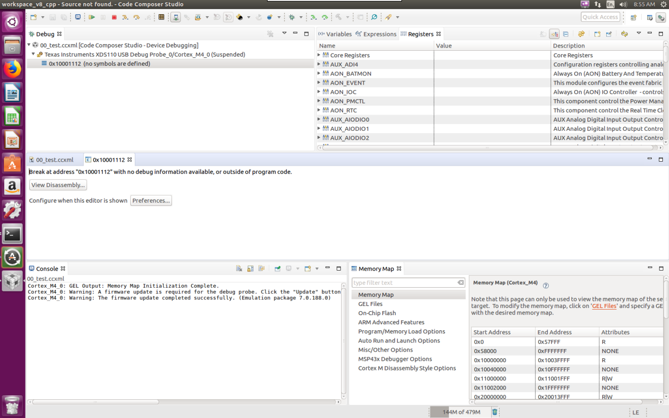

  • Hi Rafael,
    is there any progress on the issue? I'm fine with NOT updating the debugger firmware, just need to get the software into the device (CC1352R) one way or another. I've got no windows machine available unfortunately. Some earlier version of uniflash or something?
    The recently released TI Emulators package 7.0.188.0 seems to handle this issue. I just downgraded the firmware on my LAUNCHXL-CC1352R1 and was able to successfully upgrade it using this version.
    You can either install CCSv8.0.0 or update your existing CCSv7.x version.
    Hope this helps,
    Rafael
  • Great, thank you. I couldn't make CCS see my device yet, but I will try. Do you know if it is also run firmware update with Uniflash under Linux? And if yes, then what is the earliest working version?
    Differently than CCS, Uniflash version 4.x does not usually pick updates to its components, requiring an entirely new version to be released.
    I imagine this new TI Emulators component will be picked up when the next release will become available, which will happen soon - I don't have an exact date, though.
    Rafael
  • Great, thank you. Now I can blink my LEDs =)
