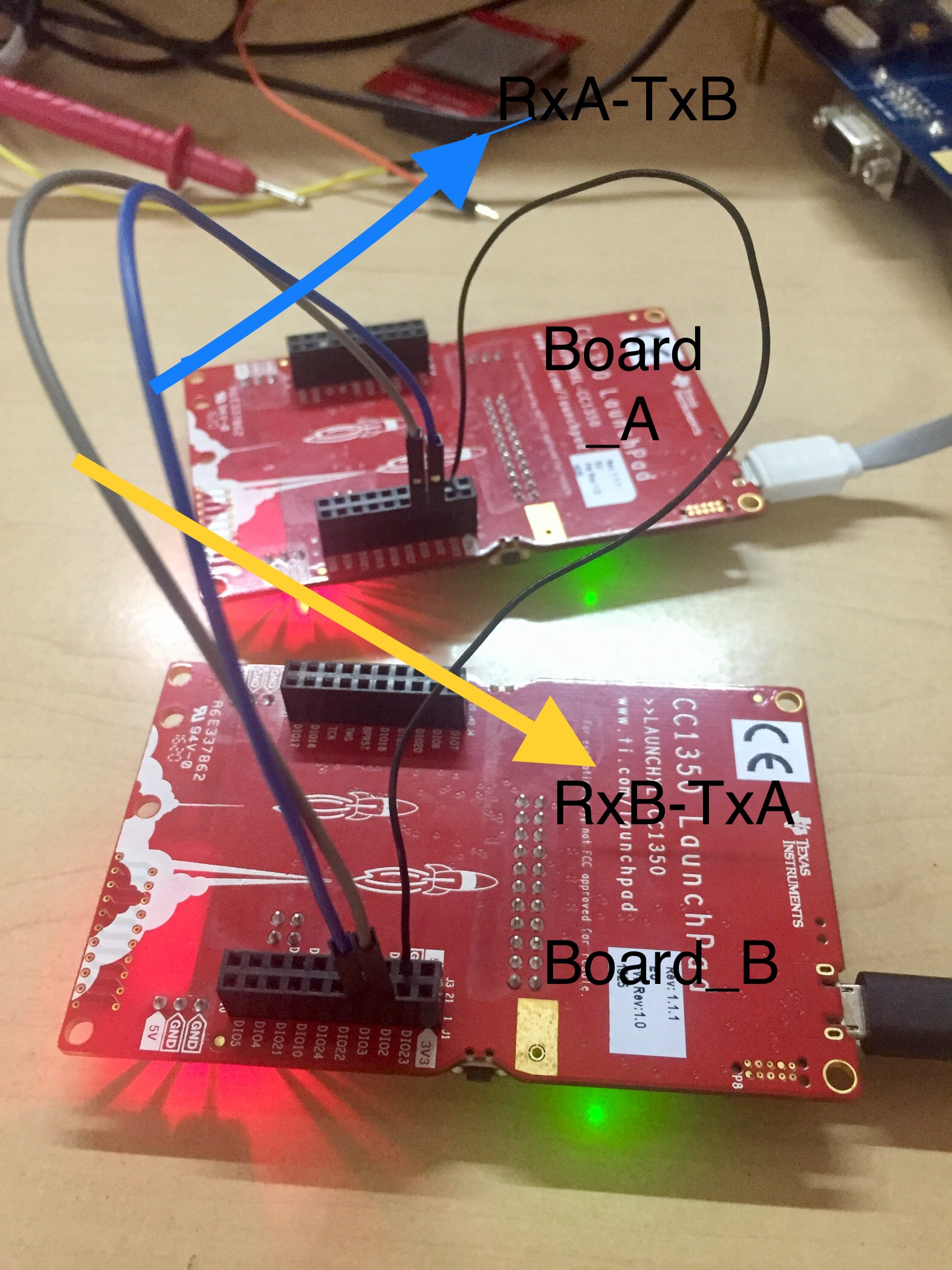

HI All,
I am trying to connect two cc1350 board with Uart.but unable to do send/receive data on both board.
But when i try to send data to from PC application(Hercules) then its working. I am not getting why this communication is not working with two board. Following is the uart configuration setting

Do i need to set any other pin configuration, please help.
