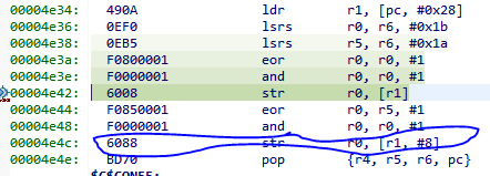

I've designed a custom PCB using a CC1310F128 IC, and am running into an issue when I try to run my software on it.  I developed the code on a Launchpad, and I've never had issues with it.  Importantly, the issue is happening well before my application code is even called.
When my PCB resets the CC1310, i can successfully enter the ResetISR, and single step through the boot assembly until I reach the function "NOROM_TrimAfterColdResetWakeupFromShutDownCfg1()".  During this function there's a block of assembly where it tries to write a value to the address 0x43200008, and it causes the debugger to lose control of the core.  I haven't been able to find out what's supposed to be in memory there, or if there's a way around this issue searching the forums.

    What JTAG connection are you using to debug your IC? And are you sure address 0x43200008 is accessed? Would appreciate it if you supplied a screenshot of the CPU registers as well at the same debug point.

  • I'm using the XDS110 from one of the Launchpads I have laying around.  Here's a screenshot of the CPU registers on the exact instruction that fails.
    and this is what we see on the Launchpad:
    I'm certain that the memory being accessed is 0x43200008, because R1 has 0x43200000 and the instruction is a store at r1 + 0x8.

    The strangest part about this is that when I write to the address just above, it writes 0x1.  When it tries to write to the troublesome address, it's also trying to write a 0x1.  If I use the debugger to manually change the address to write to (setting R1 8 bytes lower for example), it overwrites that earlier value with an identical value.  When I do this, I can single step past this just fine and enter my application code.

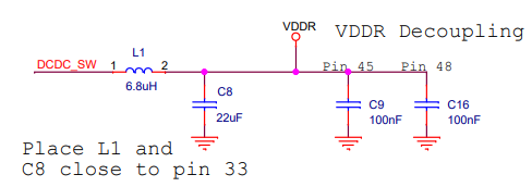

  • In the reference document outlining how the VDDR pin is connected on the launchpad, theres a 22uF capacitor and what looks to be an inductor.  We used a 220uF thinking that the value of the capacitor on that pin wouldn't change the operation of the IC.  In the image below, we only have a 220uF in place of the 22uF (C8), and none of the other components (L1, C9, C16).  To my knowledge, pin 45 and pin 48 are connected directly to VDDR, and DCDC_SW is connected with a trace to VDDR.

  • Why haven't you followed the reference design with regards to the power system. If you read 1.3.13.1 Supply System in www.ti.com/.../swcu117h.pdf your way to connect VDDR is not a valid way to connect power.
    CC1310 uses a DCDC converter means that the DCDC_SW output are pulses getting filtered by L1 and C8. I assume that you are not measuring 1.67 V on VDDR in your case?

    I'd be surprised if the problem was a circuit issue though.  I mentioned in an edit to a previous post that if I use the debugger and manually change the memory address being written to in that single operation to any other value, the issue vanishes.  A few instructions prior, the code writes a 0x1 to an address 8 bytes lower.  Since the instruction that fails is also trying to write a 0x1 to memory, I can change R1 so that the STR overwrites that earlier value.  When I do this, I can successfully single step past the instruction and enter my application code without issue.  Unless the DCDC circuit has and makes use of hardware registers in the memory block at hand, I can't see how a noisy VCC would cause a failure in the area I'm seeing.
