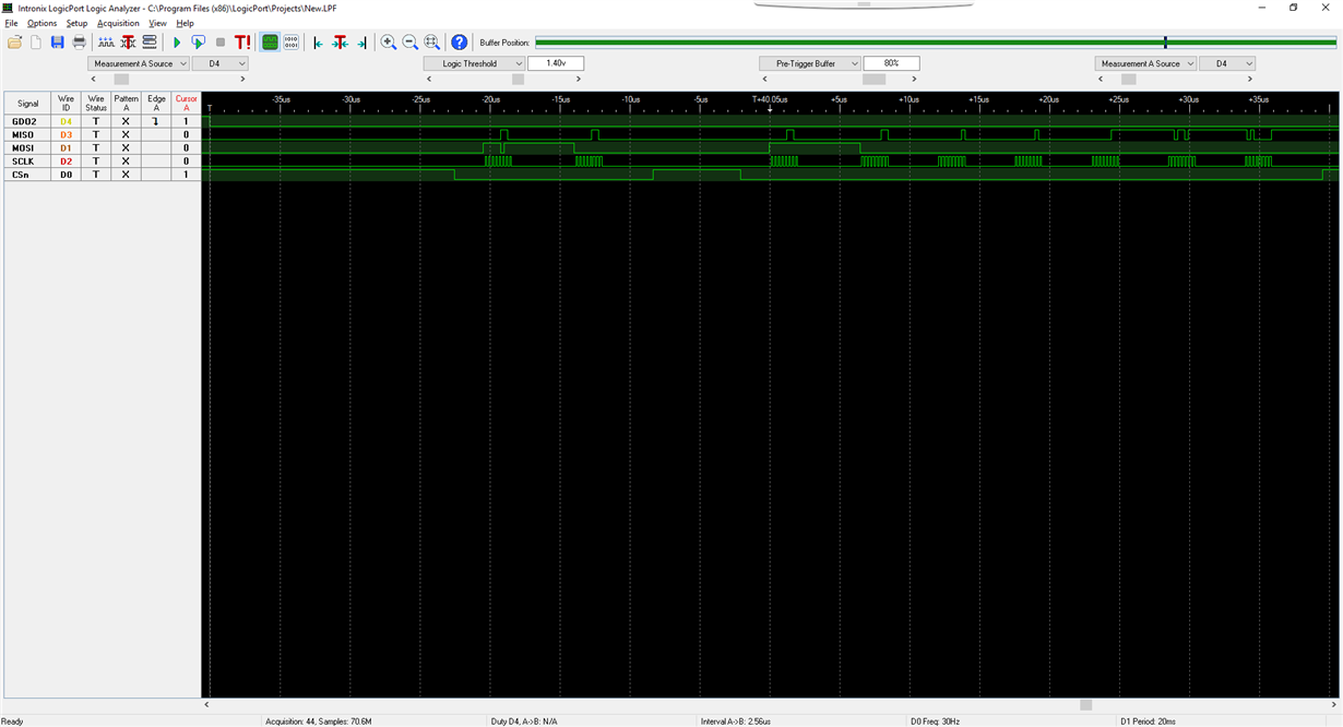

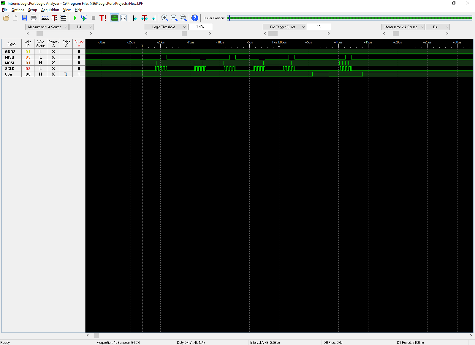

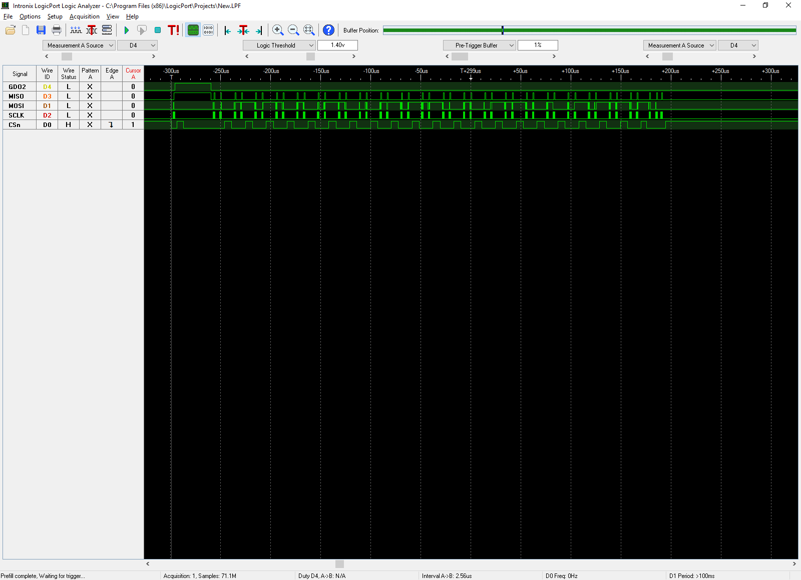

    I was running this code and all SPI plots showed the expected results (no extra bytes). Please try to do something similar and post a plot of where you are reading the unwanted byte.

  • Your explanation was most helpful, particularly the use of RXBYTES to get the packet length. In coding this up I found the "bug" that was locking out the CC110L. I put your simple "packet" into Studio7 (03 01 02 03) and when I sent it and looked at RXBYTES it returned 07...!! and the packet was 04 03 01 02 03 XX XX.... It turns out that Studio7 (I was using the "expert" mode) counts the data packet and inserts the packet length itself.... I should have twigged this earlier... as the "extra" byte was always the packet length +1... !!! so mystery solved...
