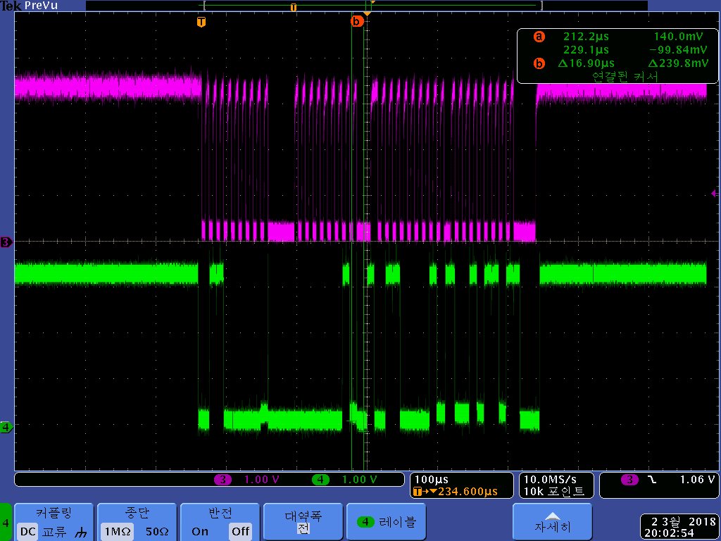

    It is success case. slave address: 0x30, register address: 0x01, value: 0x96
    It is failure case. Slave address NACK.
    The waveform looks fine.
    It was confirmed through slave debugging that the received value was broken.
    I think the slave address nack also happens because the value is broken.
    There seems to be no problem on the waveform, but it seems to be different in the MCU. Could it be?
    Thanks for the screen dumps, as you say, there seems to be no obvious problem in the waveforms.
    I understand it as the top one is when the CC1310 Slave is interfaced with any of the working MCUs and that the other two are when it is interfaced with the Altera, is this correct?
    For the screens related to the CC1310 <-> Altera setup, could you add in what data the slave actually receives (i.e. make it clear what you mean by broken)?

    The screenshots are CC1310 - ALTERA.

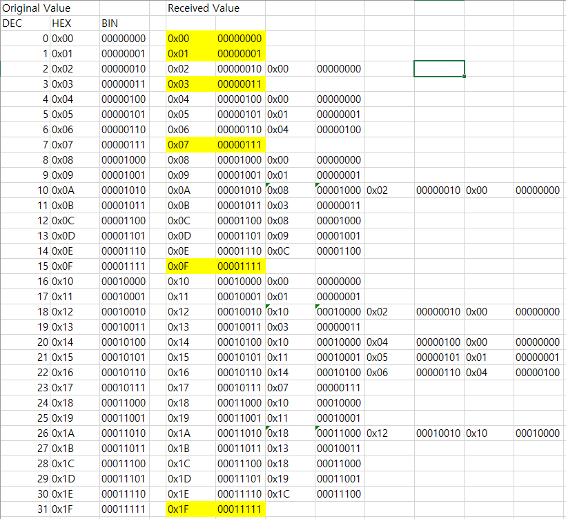

    I'm using function ti_lib_i2c_slave_data_get(I2C0_BASE);
    This is an example of data broken.
    When I send "0x05" from altera(master), cc1310(slave) receive "0x05" or "0x01".
    Sometimes, some high bit change to low bit.
    Last bit is not change. Bits connected last bit are not change.
    In the case of two or more connected bits, only the last bit is changed.
    Thank you.

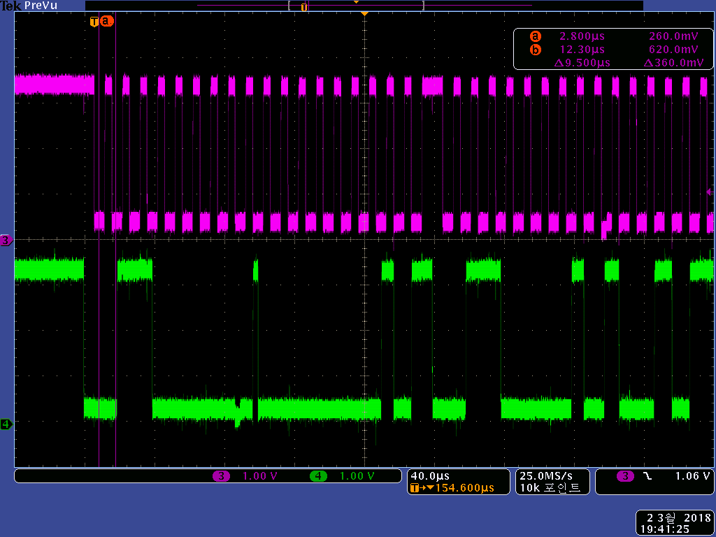

    There seems to be a difference the clock period and low level.
    ARTIK
    CC1310(Master) It is divided into two.
    No Renesas screenshots, sorry.
    I'm starting to run out of ideas I'm afraid. You could give an extra check on the master to look on things like clock stretching.
    Looking at the CC1310 master scope and the Altera master scope, the clock signal does seem a bit difference (like you noticed as well). Seems like in the working MCU cases, the pow period is a bit longer then the high period.
    Maybe what you are seeing is the the device ending up in some corner case with the Altera implementation due to some difference in clock timings? It would have been helpful if you were able to run an actually logic analyzer on this and compare the analyzer data to what the slave receives.
    Doe it affect that the low period is a bit longer than the high period?

    At this case, I would maybe doubt the hardware itself. I noticed now that it does not seem that the signal actually gets pulled to GND in the Altera case. I assume the small (3) and (4) symbols in the edge of the scope mark the GND level of the signal (seems to align with the assumption that the devices run at 3.3V).
    I noticed that in all the working cases, the signal goes to near GND, while in the ALtera case they seem to stop at ~0.5-0.6V. This is quite close to the limit of what is to be consider a safe logic zero (0.2 * Vdd). The pull ups on the i2c bus I assume comes from the Altera, if that is the case, can you figure out the value of them?
