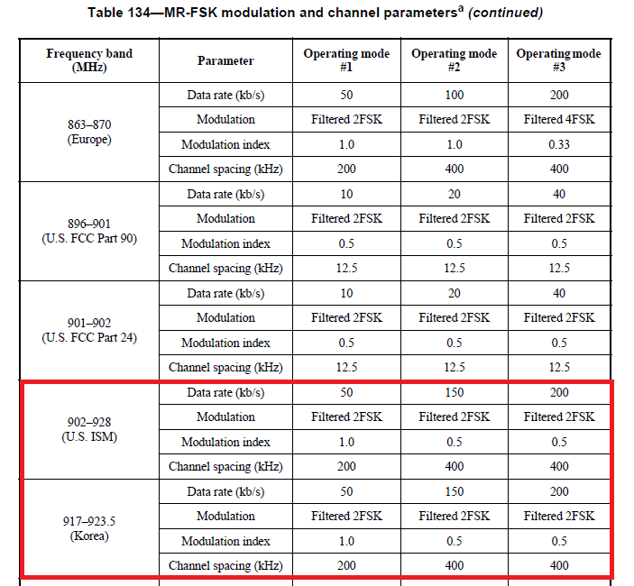

Thank you so much!
the 1st center frequencies for mode 1 and mode 2 are 907.1 and 907.3, respectively.
The only thing to change the center frequencies are updating the macro? If so, the transceiver will lock to the specified frequencies by the macros?
Fortunately, US(ISM) 902-928 is covering the Korean frequency band(917~923.5MHz by changing the center frequency macro and the channel number properly. Of course, the other phy spec. are the same as the following, according to the IEEE 802.15.4g-2012,
Hello Seon-eun,
Thanks for the information. Glad to know that Korea requirements are same as US. Yes, you should just be able to change the values of frequencies and it should work. Please let us know if face any issues.
