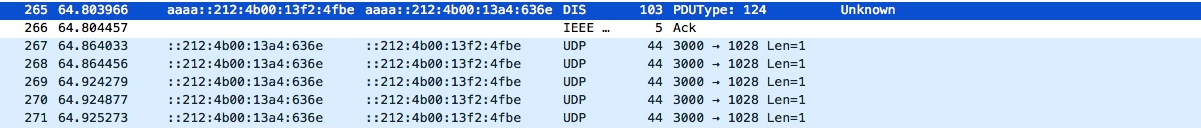

I have 6lbr (Router mode) running with RaspPi + CC1310 launchpad (slipradio).
I got one more cc1310 launchpad into WSN. This end node is discovered and I am able to open web page to it.
I couldn't find it on IBM quickstart page.
I enabled prints in cc26xx-web-demo.bin and found from serial logs that it is stuck in MQTT connecting phase itself:
I don't see any packets in the output of tcpdump for port 1883 on RaspPi:
pi@raspberrypi:~ $ sudo tcpdump -i eth0 port 1883
tcpdump: verbose output suppressed, use -v or -vv for full protocol decode
listening on eth0, link-type EN10MB (Ethernet), capture size 262144 bytes
However, I see some packets in 6lbr.log with IP address matching the IBM quickstart messaging server (MQTT broker) with debug level increased to 8:
2018-03-27 1:04:46.797544: PACKET: SLIP: read: 73
2018-03-27 1:04:46.797676: DUMP: SLIP:
61dc1ccd abec63a4 13004b12 006e63a4
13004b12 007af000 000064ff 9b000000
00000000 00b8ac7c bd060063 04001e02
00040507 5b000000 64000000 00600200
809a8700 00020400 80
I tried reducing debug level also to understand if logging is leading to any timing issue. It didn't solve.
Not sure if IP64 setting in 6lbr also comes into picture for this behavior. But i have enabled IP64 as well.
Can I get some help on this ?
Is this because IBM quickstart broker IP is not reachable from my network ? OR
is the tcpdump indicating something is wrong in mqtt message communication in WSN itself ?

  • Try to run wrapsix instead of IP64 on 6lbr to see if it works.
  • Hi Chen, thanks for reply.
    I ran wrapsix on RaspPi with below settings:
    pi@raspberrypi:~/wrapsix-0.2.1 $ sudo wrapsix wrapsix.conf
    [Info] WrapSix 0.2.1 is starting
    [Info] Using: interface eth0
    [Info] prefix 64:ff9b::
    [Info] MTU 1500
    [Info] IPv4 address 192.168.0.111 <== Random unused IP in my LAN
    [Info] host IPv4 address 192.168.1.7 <== RASPPI IPV4 address
    [Info] host IPv6 address bbbb::101 <== 6lbr IP
    But, still the mqtt connection is not established on CC1310 end node.
    However, i see tcpdump dumping all the 1883 packets now on eth0 of RaspPi and en0 of my MAC but only in one direction.
    Mqtt packets are received from my CC1310 end node on these interfaces but i dont see any response to them.

    I observe that i couldn't ping6 to 64:ff9b::b8ac:7cbd from my MAC or RaspberryPi as well.
    However, i see the corresponding IPv4 address () is going fine.
    Ganis-MacBook-Pro:~ ganikoduri$ ping 184.172.124.189
    PING 184.172.124.189 (184.172.124.189): 56 data bytes
    64 bytes from 184.172.124.189: icmp_seq=0 ttl=53 time=383.334 ms
    64 bytes from 184.172.124.189: icmp_seq=1 ttl=53 time=304.242 ms
    64 bytes from 184.172.124.189: icmp_seq=2 ttl=53 time=330.629 ms
    64 bytes from 184.172.124.189: icmp_seq=3 ttl=53 time=345.046 ms
    64 bytes from 184.172.124.189: icmp_seq=4 ttl=53 time=364.187 ms
    64 bytes from 184.172.124.189: icmp_seq=5 ttl=53 time=283.909 ms
    64 bytes from 184.172.124.189: icmp_seq=6 ttl=53 time=303.555 ms
    Has it got anything to do with my router config now ?
    Please help.

  • When you build cc26xx-web-demo example, IBM QuickStart IPv6 address is preprogrammed in it and you shouldn’t change it. Please use the default IPv6 address to test again.
  • Yes. I restored it back to the old quickstart ipv6 address that came with example code. behavior didn't change. connection still fails.
    I dont find these packets being routed to wireless interface on my MAC as i dont find them in the tcpdump on the interface corresponding to my wiress LAN on my MAC.
    They arrive on eth0 but they seem to be not getting forwarded outside of my MAC.
    As i am using 6lbr in router mode, am i supposed to do some ipv4/ipv6 forwarding as mentioned in router mode section of the below wiki ?
    github.com/.../6LBR-Interface-Configuration
    It says as below:
    IP Forwarding can be enabled by adding the following two lines in /etc/sysctl.conf:
    net.ipv4.ip_forward = 1
    net.ipv6.conf.all.forwarding=1
    But i didn't find /etc/sysctl.conf on my MAC to do this.
    How to know if it is already enabled ? Is there any alternate command to do this ?
    Gani
  • Its a partial success for me. I am able to make the CC1310 to publish to mosquitto on my RaspPi.
    But for accessing the quickstart ibm server, i shall understand if it is mandatory to use smartbridge mode of 6lbr or any extra forwarding to be enabled on host side to get this done.
    Gani
  • Basically, it is enough to enable NAT64. Anyway, what do you see now when you do tcpdump on port 1883?
  • For some one's reference, i had to configure the bbbb address configured on my br0 interface on Raspberry Pi as MQTT broker IP for the end node.

    I have analyzed further with the sniffer in place.
    I find that the 6lbr is stripping off the first 64 bit prefix of the destination IPv6 address when it puts on the slip-radio.
    I tried to send ping packets to the aaaa ipv6 address of the end node that i find on 6lbr nodes page, but it removes aaaa from it.
    Packets originating from MAC :
    08:15:32.955005 IP6 bbbb::e87a:f98:144e:97b5 > aaaa::212:4b00:13a4:63ec: ICMP6, echo request, seq 0, length 16
    08:15:33.955412 IP6 bbbb::e87a:f98:144e:97b5 > aaaa::212:4b00:13a4:63ec: ICMP6, echo request, seq 1, length 16
    08:15:34.956674 IP6 bbbb::e87a:f98:144e:97b5 > aaaa::212:4b00:13a4:63ec: ICMP6, echo request, seq 2, length 16
    but the destination ip address is shown as ::212:4b00:13a4:63ec in the packet capture through sniffer.

    I see from packet capture that ONLY packet that gets exchanged with aaaa address between the 6lbr on Raspberry Pi and web demo end node is DIS packet.
    Here, aaaa::212:4b00:13f2:4fbe corresponds to slip-radio node(6lbr) and aaaa::212:4b00:13a4:636e corresponds to the Web-demo node.
    After this, communication is getting into problem, probably because of the missing 64 bit prefix in the IPv6 address fields of the packets. Any idea, what is this DIS packet is about ?
    Please let me know if you need any more info on this.
    Gani

  • The dissectors for RPL (for which DIS packets falls under) and UDP are different, and for RPL the address prefix is not omitted. I don't have a good answer to why one dissector omits it and one doesn't, however, that's how it is.
