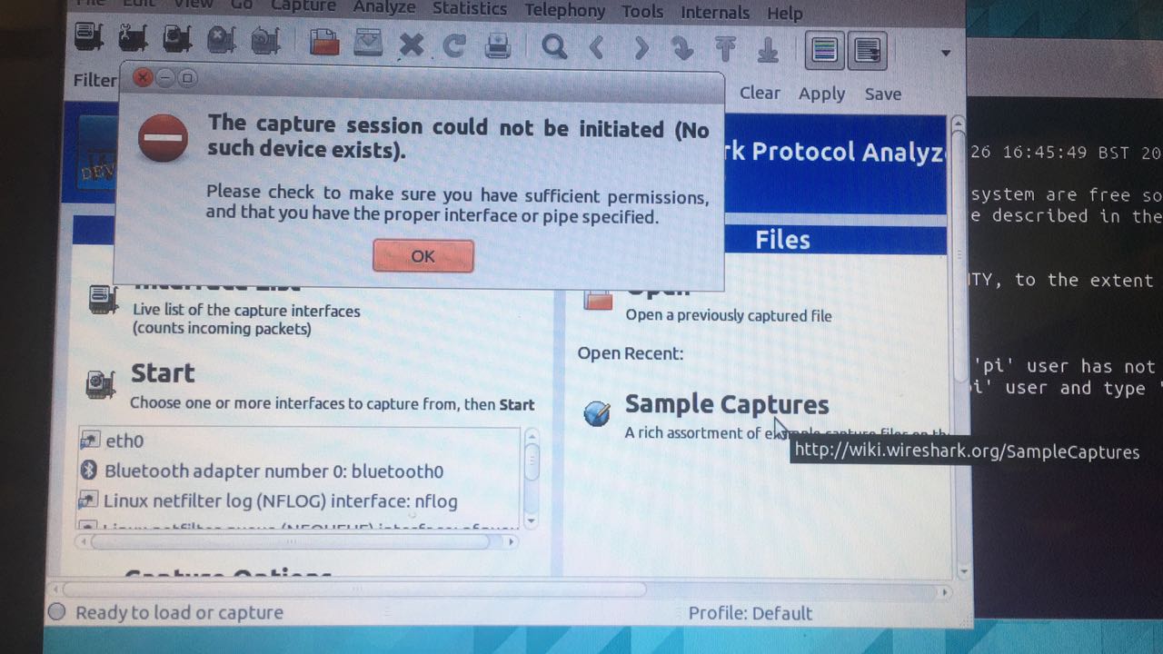

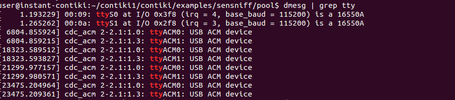

I have built an IoT system that consists of 2 cc1310 launchpads running cc26xx web demo and they are connected to a gateway (cc1310 launchpad + Ethernet controller ) that runs 6LBR lite.
Now I want to capture the packets between the gateway and the launchpads. However, when I run Ettercap to find the IPv6 addresses, it only shows the IPv6 address of the gateway. While the other launchpads connected to it, already have IPv6 addresses according to the 6LBR page but I can't find them using Ettercap.
Is there a way to detect the IPv6 addresses of the launchpads?
