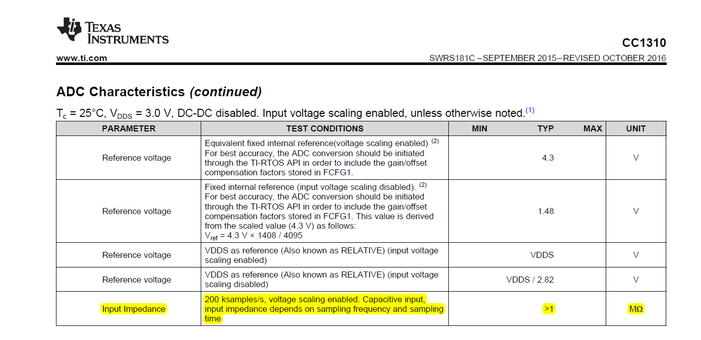

Dear anyone,
Is anyone can help to clarify the input impedance value of the ADC in TI CC1310.
In the documents SWRS181C, it only write the value will more than 1 Mohm. And also give one more information is
Capacitive input,input impedance depends on sampling frequency and sampling time.  That mean the input impednace will have different value in the frequency and sampling time.
 Is possible we can know how many input impednace in such 3h = 2P7_US : 16x 6 MHz clock periods = 2.7us ? If there are a table list for all of them will be very great.
