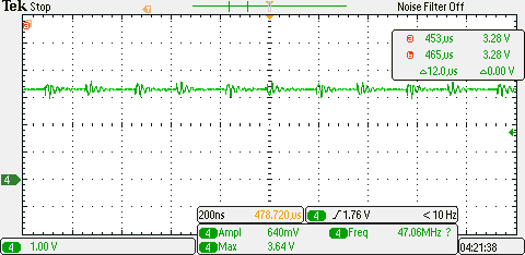

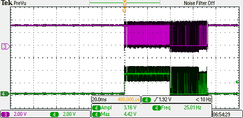

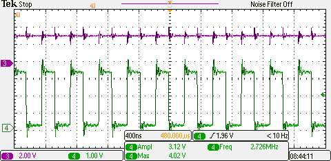

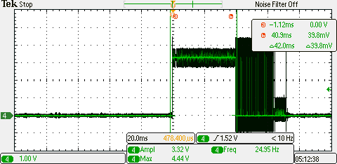

Below are some captures of the TCK & TMS during connect attempts. Our board does seem to have more overshoot / oscilation stabilizing new level, but not sure if it is enough to make a difference.
TMS ( at different time sample rates)
TCK(left), TCK(pruple) & TMS(green) (right image)
Any suggestions on where to go next? Please..
