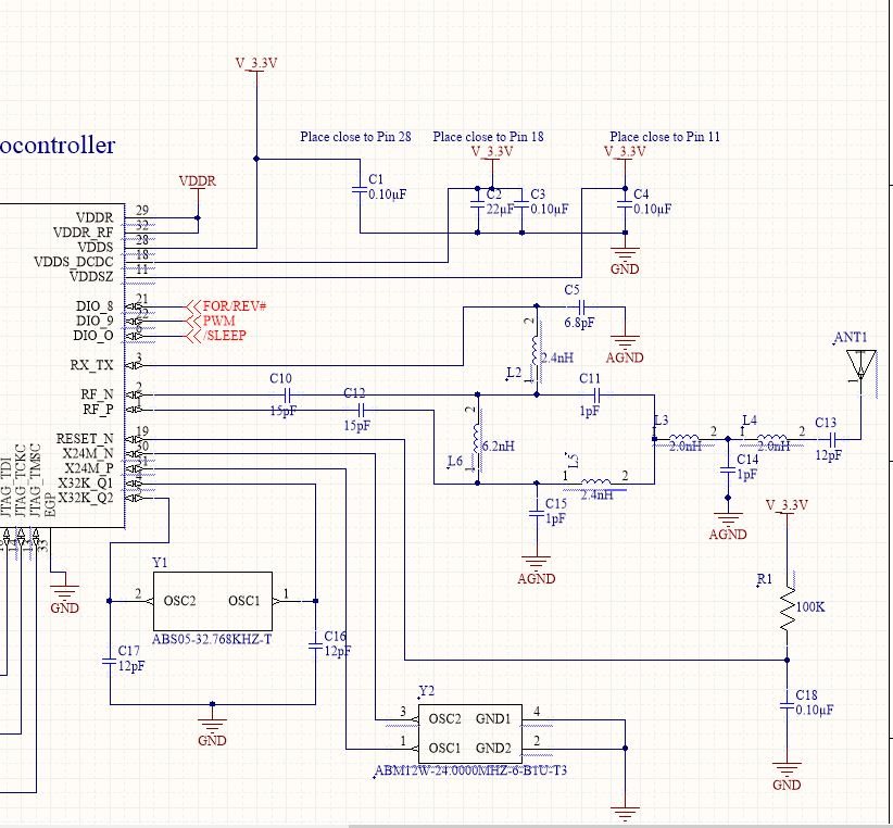

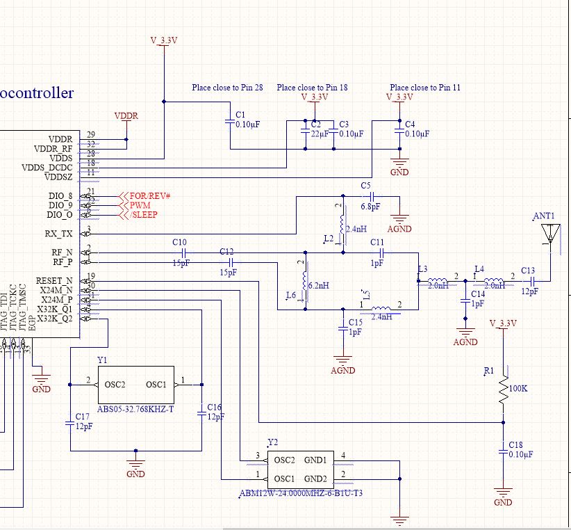

I am working on a design utilizing a CC1350F128RHBR with BLE only wireless communication.  I have followed several TI App notes and reference designs are would like to share the RF side of my design in the hopes that the community would have some feedback.

For my schematic design, I referenced the CC2650 Datasheet (specifically Figure 7-1, shown below).  My schematic implements differential operation.

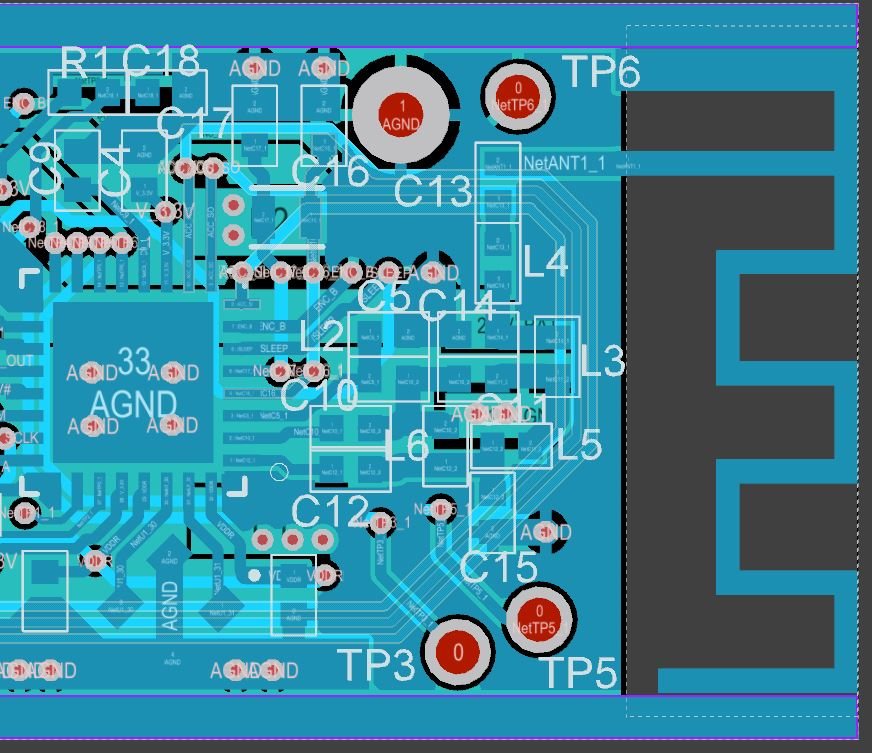

My antenna design is copied from AN043, Small Size 2.4 GHz PCB antenna (swra117d.pdf).  I copied the Inverted F Antenna from the files provided by TI and imported it into my design.  The antenna fits perfectly into the space I have available on my board and thus I have not modified the layout or dimensions it in any way.
I am using the Solidworks PCB package.  I am usually a Cadence guy but my new gig uses Solidworks PCB.  It drives like Altium in most ways but not all.
My board is 6 layers, SIG/GND/SIG/CORE/PWR/GND/SIG.  0.031" thick.  1oz copper.  Top and bottom of the board are flooded and tied to GND.
Impedance calculations for the NetANT1_1 trace between C13 and the feed point come back as 83.8Ω.  That seems a little high to me but to get it down required a flood between C13 and the antenna and that is not what I am seeing in reference designs.
Questions:
In my schematic I have most things tied to GND and the antenna connections to AGND.  In the layout these are implemented as the same net.  Does anyone see value in keeping them separate and tying them together at one point?  I know this depends a lot on the reset of the design but I am less sure what to do related to the RF part.
Has anyone laid out a Differential Operation Antenna as shown in the CC2650 datasheet and then later DNP and 0Ω components to change to Single Ended Operation?   I started with differential for the better performance but may want to cost and size reduce to single ended if possible.  It seems like I could pop some parts off a board and 0Ω some others and have a crude conversion.  Just wondering if anyone has tried this and can share what they found.
Am I missing anything glaring?  I have a few ARM core micro designs under my belt but this is my first RF design and the first project where I was the sole person working on the layout.
Any help is greatly appreciated.

    1. No, better to use a common ground
    2. You can convert differential circuit into a single ended circuit but please make sure you have No Stubs in the PCB Layout. Please note that the same RF Signal (either 2.4GHz or Sub 1-GHz) will be available on both RF_N and RF-P pins. Also please note that you need to have a separate Antenna for Sub 1-GHz. You may consider in using CC1352 instead of CC1350, as it has 2 separate RF ports ( 2.4 GHz and Sub1-GHz)
    I don't see C13 and associated circuitry to comment about port impedance. You can post your Schematic in PDF for our review.

  • My placement and schematic are shown above.  I have also attached the snippets as a pdf below.
    The designs with Sub 1GHz will not use BLE, our design will be one or the other with BLE being the first round of Dev hardware, Sub 1GHz, presumably the 2nd round of Dev hardware and then carried on into the production device.  BLE was chosen for the first round (proof of concept) due to the quicker integration with COTS tablets for demo purposes.

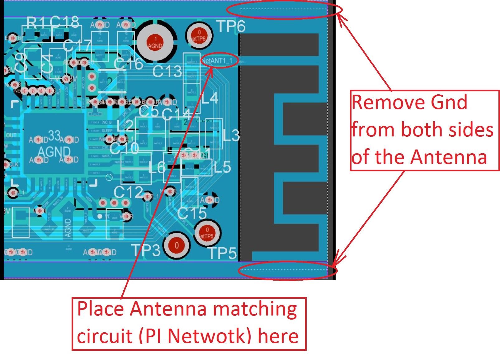

    The two long rectangular sections at the top and bottom of the board are intended to be top and bottom layer keep outs. I need to confirm they are actually implemented that way. My internal layer/planes end at the vertical dashed line that is shown in the layout about where the antenna traces start.
    Based on the CC2650 datasheet, I was thinking that my C15, L5/L4, C14 would form the PI network. If I start out in differential Mode, would I still need to add this additional PI network 'downstream' from C13?
    Thank you for the help!
    Yes, No routing underneath the Antenna (Dashed Rectangle) on any of the Layers.

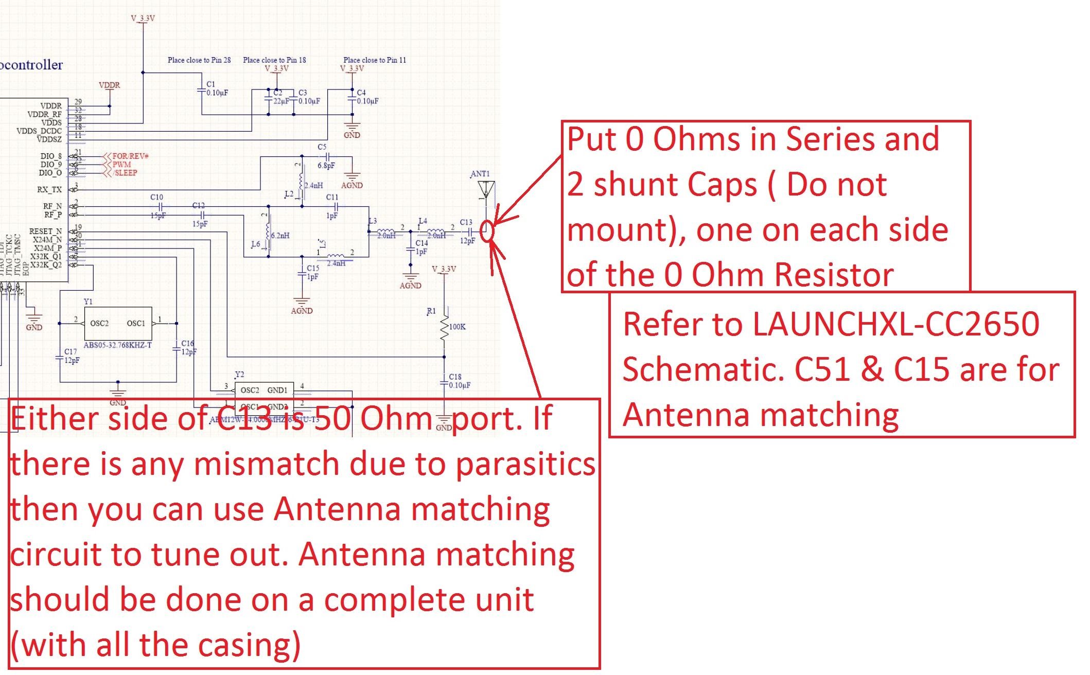

    Yes, you need to add PI network after C13 towards Antenna.

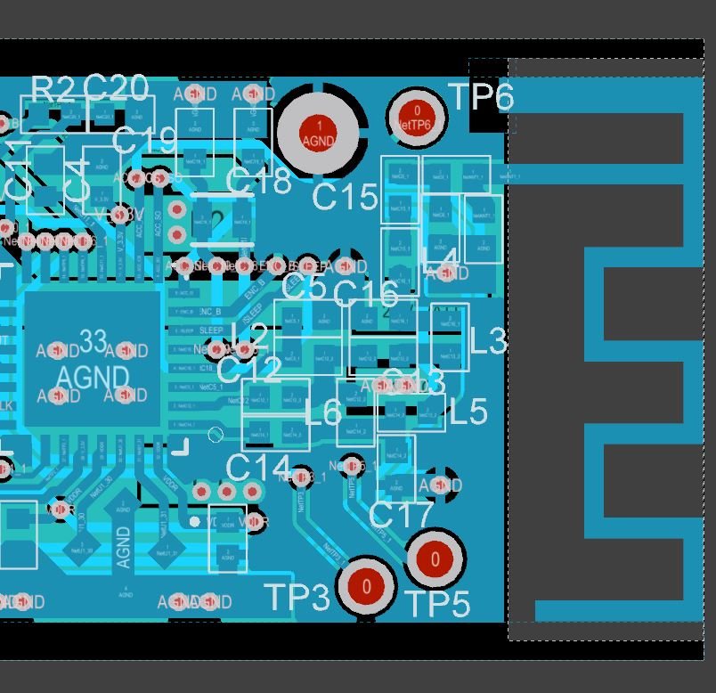

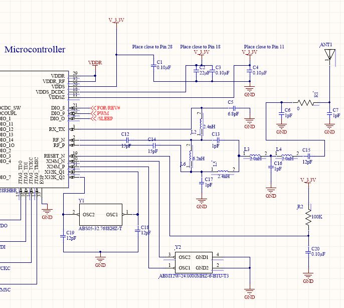

  • Ok, I have added the PI Network.  How does this look now?
    Thank you!
    The PI Network has been added to between C15 (renumbered from C13) and the antenna feedline.  A 0Ω in series and two caps to GND.
    Yes, it look OK.
    Please make C6 and C7 to DNP (Do not Populate). Tune C7, R1 and C6 for Antenna match on your Prototypes and then finalize those values.
    Antenna matching should be done on a complete unit.
