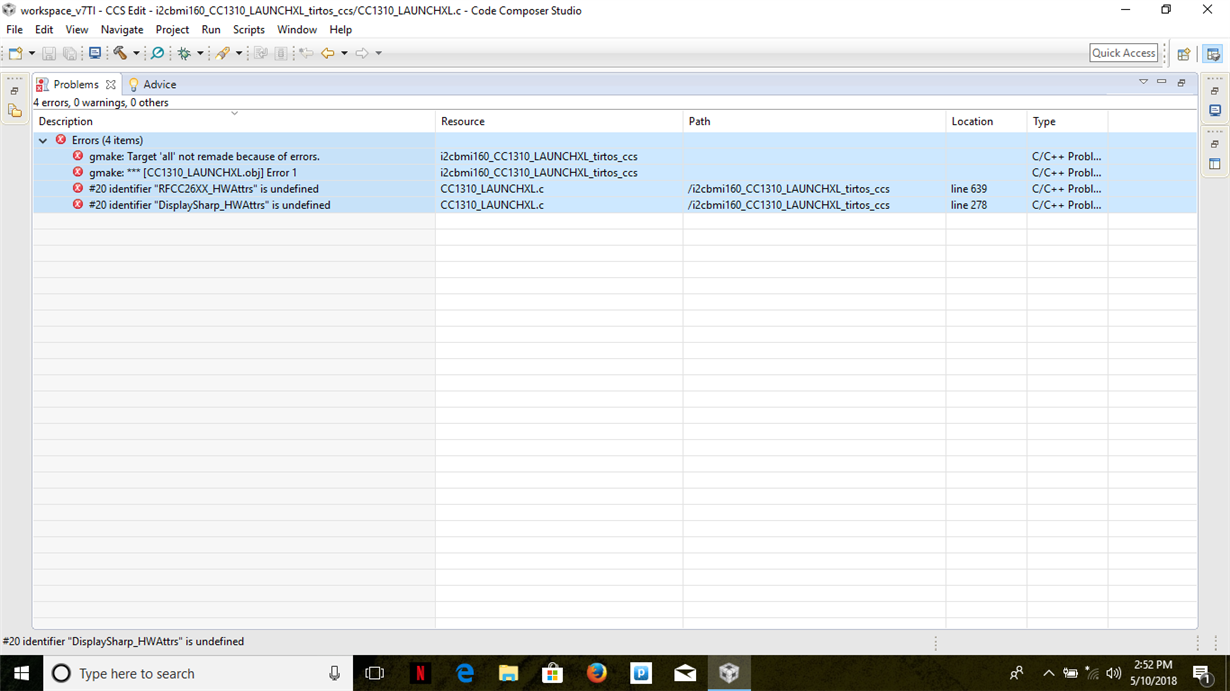

    I have rebuilt project i2cbmi160 and still get the following errors:
    Description Resource Path Location Type
    #10010 errors encountered during linking; "i2cbmi160_CC1310_LAUNCHXL_tirtos_ccs.out" not built
     i2cbmi160_CC1310_LAUNCHXL_tirtos_ccs    C/C++ Problem
    cannot find file "C:/ti/simplelink_cc13x0_sdk_2_10_00_36/source/ti/grlib/lib/grlib.aem3" cannot find file "C:/ti/simplelink_cc13x0_sdk_2_10_00_36/source/ti/grlib/lib/grlib.aem3" i2cbmi160_CC1310_LAUNCHXL_tirtos_ccs    C/C++ Problem
    cannot find file "C:/ti/simplelink_cc13x0_sdk_2_10_00_36/source/ti/mw/lcd/lib/lcd.aem3" cannot find file "C:/ti/simplelink_cc13x0_sdk_2_10_00_36/source/ti/mw/lcd/lib/lcd.aem3" i2cbmi160_CC1310_LAUNCHXL_tirtos_ccs    C/C++ Problem
    gmake: *** [all] Error 2 i2cbmi160_CC1310_LAUNCHXL_tirtos_ccs    C/C++ Problem
    gmake[1]: *** [i2cbmi160_CC1310_LAUNCHXL_tirtos_ccs.out] Error 1 i2cbmi160_CC1310_LAUNCHXL_tirtos_ccs    C/C++ Problem
    These files are not in Simplelink_CC13x0_SDK version 2.10.0.36.  Do you have any suggestions.

  • Hello Cecil,
    We started a new workspace and imported i2cbmi160 project from sail_1_20_00_02__win.  It did
    not build.  We get the same errors show in the att ached file.  I don't know about "tirtos project dependency it has is from the 1.60 SDK", but we are using simplelink_cc13x0_sdk_2_10_00_36
