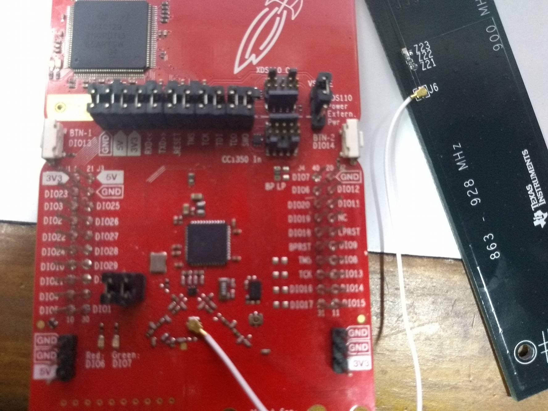

I moved the C15 capacitor in order to connecting an external antenna from the CC-ANTENNA-DK2-kit, as it says in the instructions.
I have tried to measure the RSSI values with SmartRF Studio and it is worse if i compare this results with a Launchpad CC1350 without the external antenna ( and without replacing C15). I cannot transmit over a few meters without losing packets.
I used antennas for the corresponding frequency (863 MHz).
Does anyone know what im doing wrong? It's impossible that the signal power falls down with an external antenna.

  • It looks like you have done the connection correctly but it's a bit difficult to see from the picture since it's not in focus.
    It looks like you are using antenna #6 which is the same antenna you have on the launchpad. In addition you add a cable with a loss so I would not expect any improvement.
    But: You should get better range than a few meters.
    First, could you see if you get a difference on 868 MHz? If you use SmartRF Studio and put one board in cont RX (without any known TX on), what RSSI are you seeing on 863 Mhz and 868 MHz? Have you also tried the 50 kbps to see if that make a difference?

  • The white cable you use to connect the LP and the external antenna together has a loss of 1 - 2 dB meaning that you get poorer range using the #6 antenna compared to the antenna used on the LP.

  • If you have the antenna kit, then it will be better to use antenna nr 9 for your tests. The range will only be degraded using antenna nr 6 since the cable will introduce more losses.
