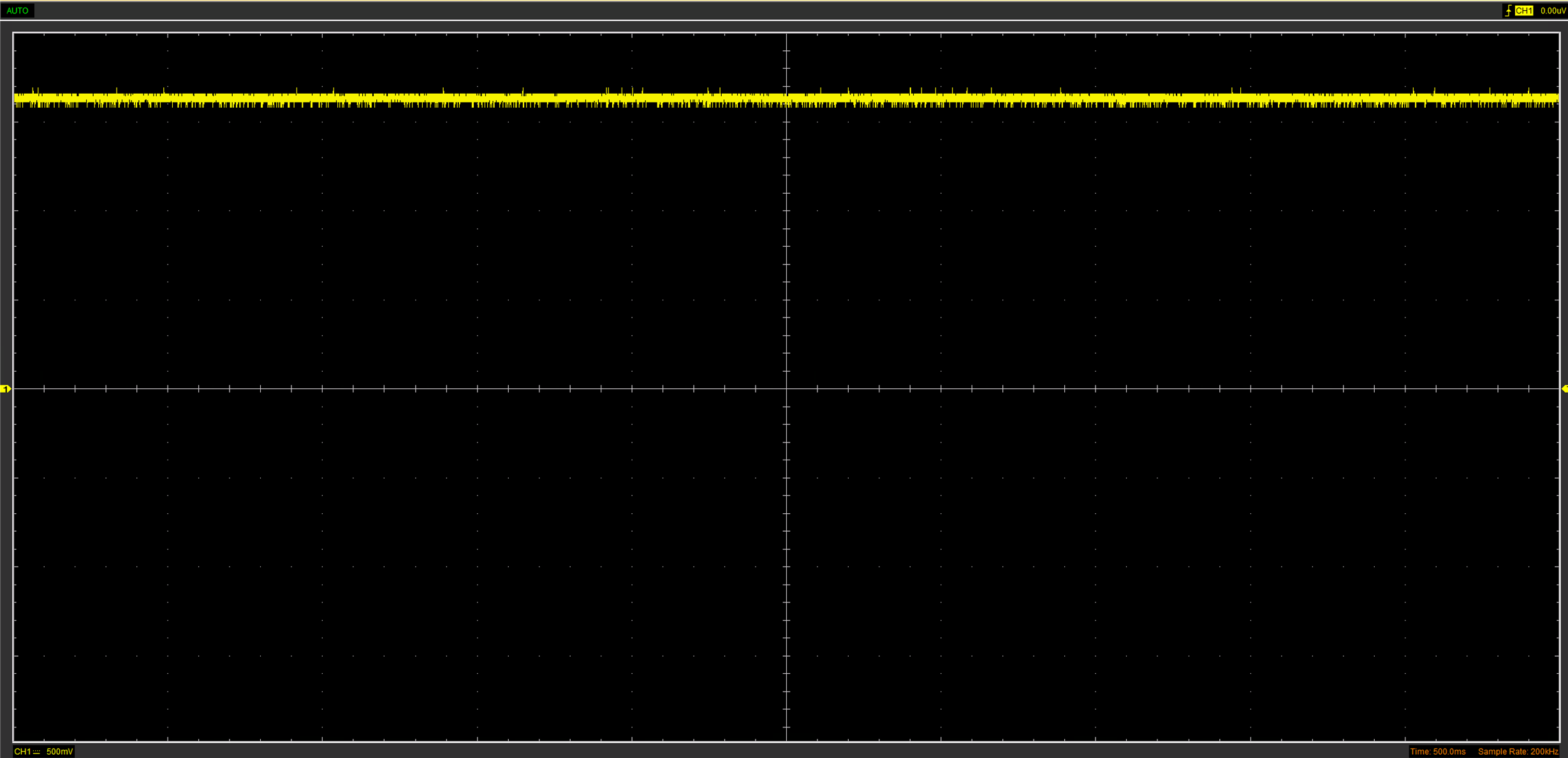

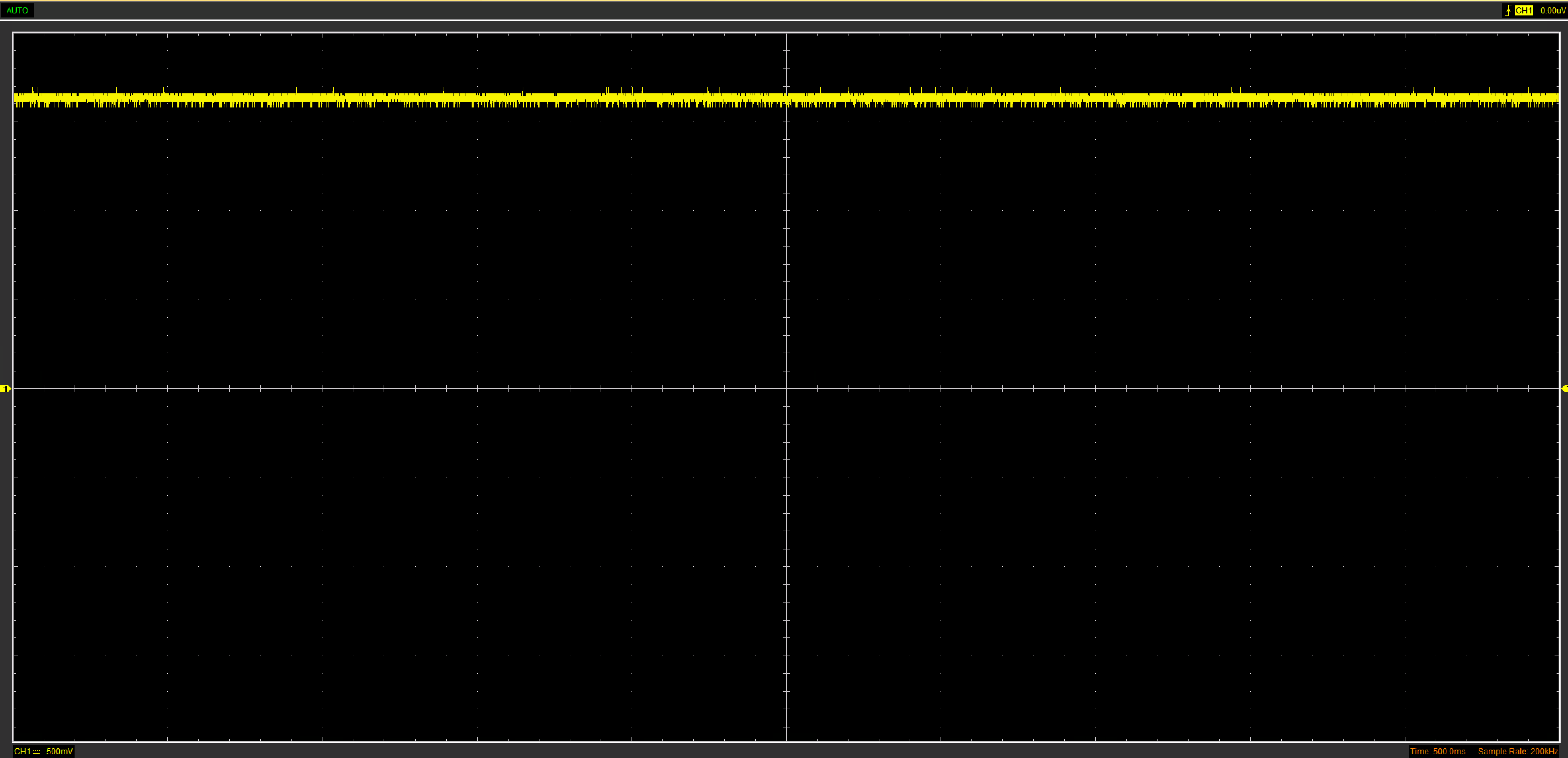

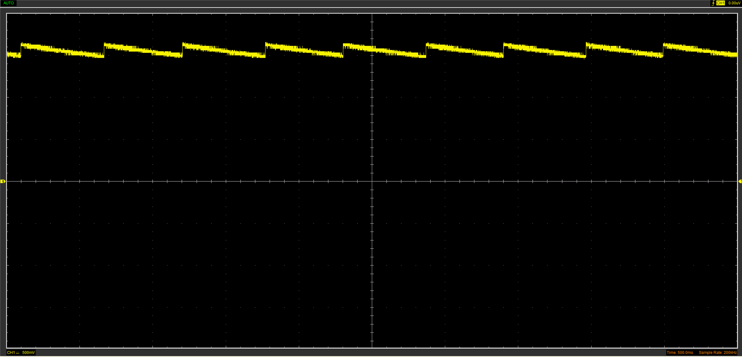

    2. After enter in 470 uA state VDDR becomes constant: 1.95V before changing ccfg.c, 1.67V after changing.
    In 0.7 uA state VDDR is floating: 1.88V-1.94V before changing ccfg.c, 1.58V-1.66V after changing

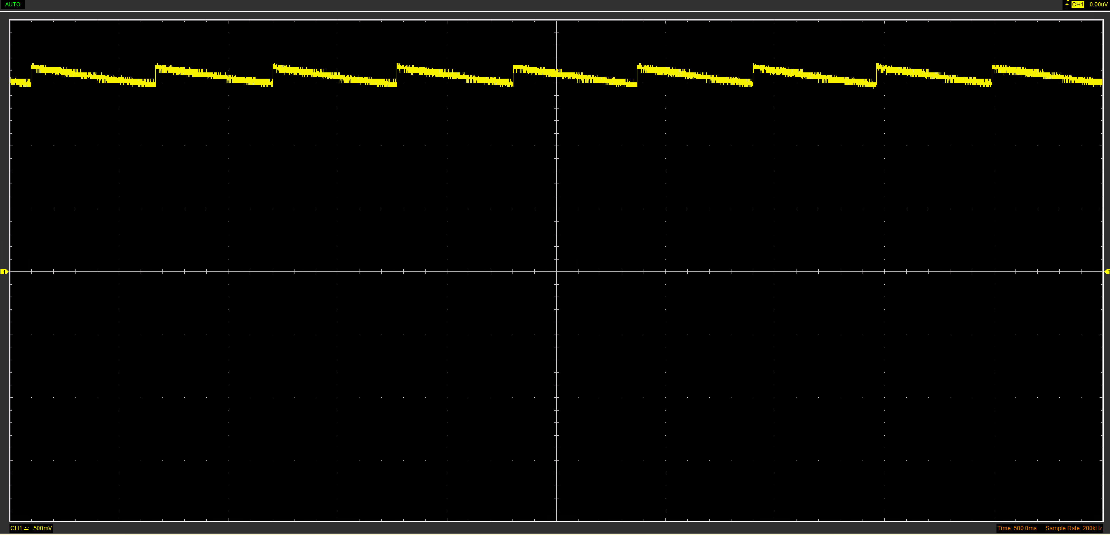

  • Are you able to use a scope and make a screenshot of the waveform in both cases?
  • 0.7 uA state
    470 uA state
    Time to transition from 0.7uA to 470 uA - less then 15 minutes.

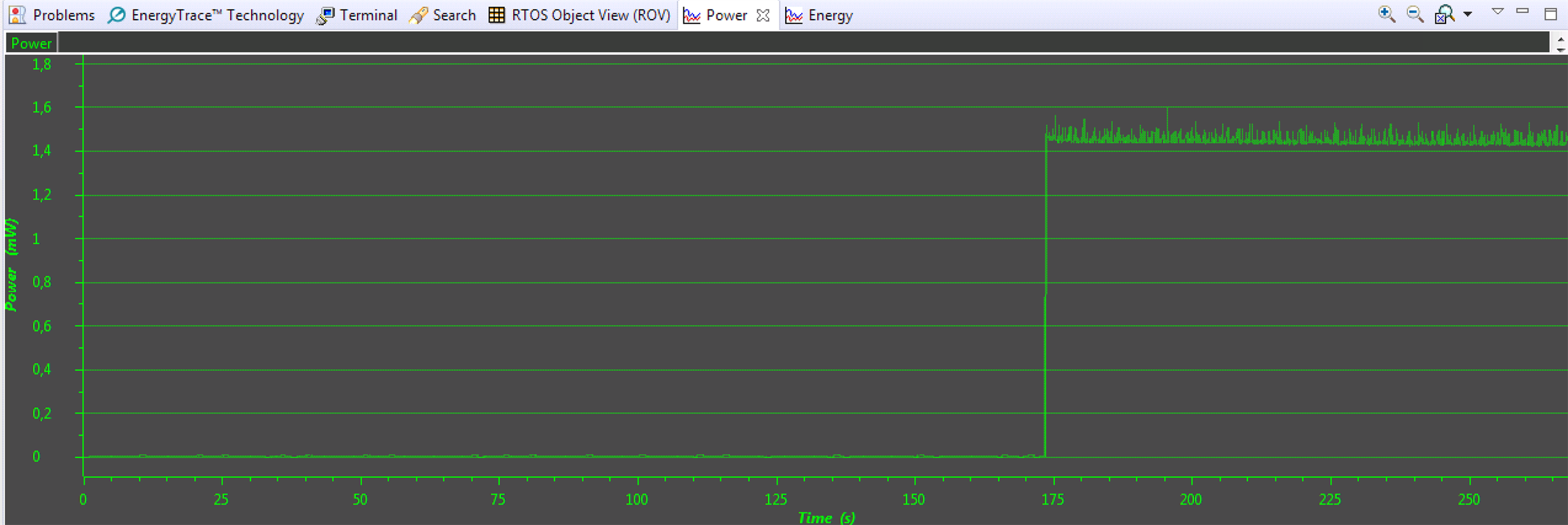

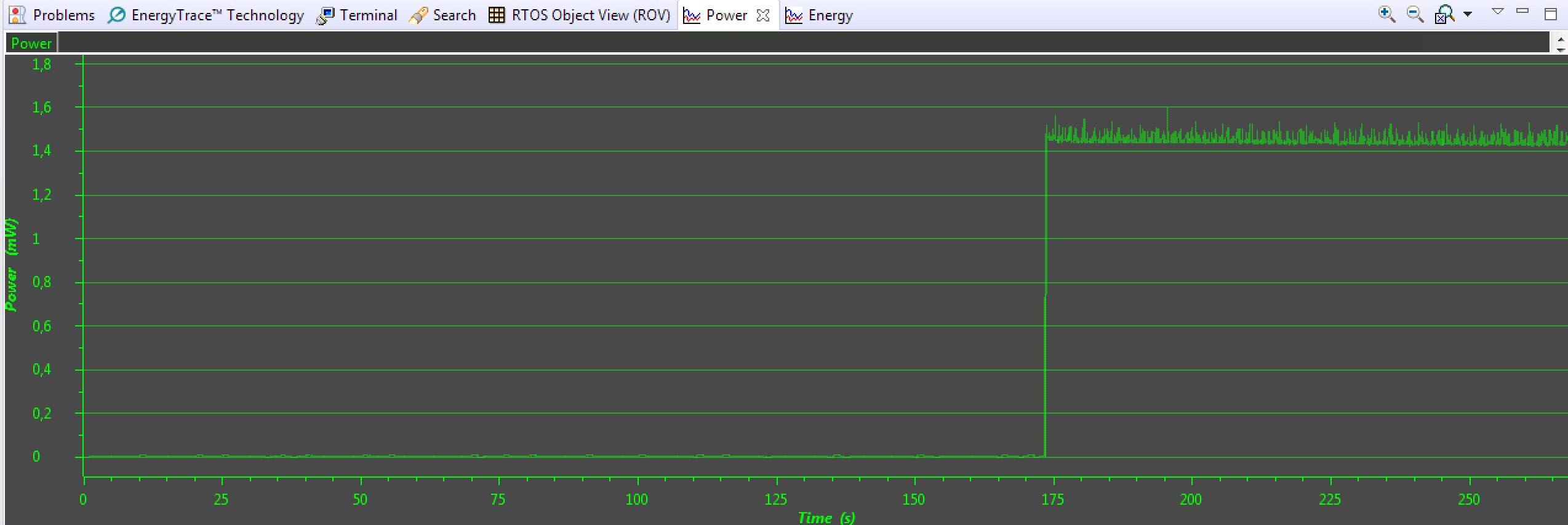

  • 1. pinStandby example comes to 470 uA state in 3 minutes. I found that temperature difference is related with time that needed to transit from 0.7 uA state to 470 uA state. If chip already frozen (-20 degree) it comes to 470 uA state in 1 hour. I also found that rebooting every 10 seconds is not a solution - my other test chip, that rebooted every 10 seconds, hangs after 50 hours in freezer (if i reboot (by SysCtrlSystemReset()) the chip while it in 470 uA state - it hangs and consume > 2 mA).
    2. How can i turn off 24 MHz xtal? I can not find this option in ccfg.c.
    3. Yes,  current goes directly from 0.7 uA to 470 uA. Here the graph from EnergyTrace (it's pinStandby example with 1 wake up every 5 seconds):

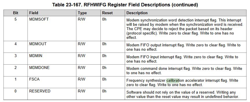

  • Hi Rustem,
    the radio CPU does the process called frequency synthesizer calibration.
    RFHWIFG register contains FSCA field.
    Maybe I am wrong, but looks to me that the radio CPU does some things in a background when a temperature changes by some threshold value.
    I remember that in case of CC32xx, the RF calibration is invoked when temp. changes by 20 degC since the last calibration.
    In case of CC32xx, the calibration takes effect when exiting the hibernate state or during normal operations.
    I know that your design based on a 4 layer PCB works fine.
    However, I have no better idea right now.
    Could you check FSCA interrupt flag before and after current  jumps to 470 uA?

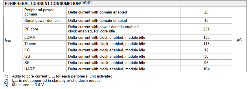

  • TER: I do remember that 1310 uses about 50 uA/MHz. I imagine that RF core starts an ISR just for a few us and do not turn off the RF synthesizer, maybe something else.
    Should these few us be seen on Energy Trace presented by Rustem? I have no experience.
    Pin examples do not use RF, however RF interrupts system has some defaults.
    Somewhere earlier Rustem has said there were no problems with his LPs: CC1310, CC1350.
    In case that RFHWEN register has different settings on LPs and on this terrible board, RF interrupt subsystem may do something.
    I summarized all currents except: I2S, SSI, UART from the table above and I got 525 uA.
    From my perspective 525 is equal to 470.
